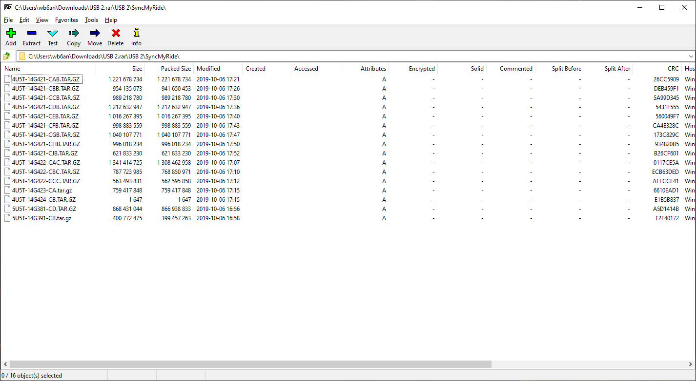

I downloaded the .rar files from the f150 forum as I was also having issues with the usb2 files, Here is USB 2 from the rar format, Nav version

I'm setting up to do this. For clarity, Tricon's files are already decompressed/unzipped and just need to go on the USB drive with the exact file structure? Any future map updates will have to be by this same method? There's not likely to be any subsequent updates from Ford for my 2017, other than map updates?

I still had to unzip the files
