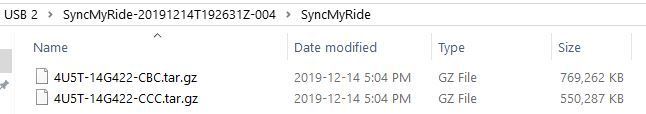

I was wondering if someone could post pictures of the files as they appear on the finished USB sticks. I have been struggling with the downloads all afternoon and have experienced several download errors. I finally got USB 2 to download cleanly (it took about 3 hours) and it seemed to unzip successfully and created two .tar.gz files. Is that how many there are supposed to be. I would feel better if I knew exactly what the files should look like on each stick before proceeding any further.

If you are using Tricons Non Nav files there should be three .tar.gz files in the SyncMyRide folder on your USB2 stick and a separate LST file not in the folder.

Likes: 16
From: Saskatchewan
I used Tricon's files for navigation and only have two .tar.gz files in SyncMyRide folder. On one of my attempts I only ended up with one file.

Could someone please confirm if these files in the SyncMyRide folders for USB 1, 2 and 3 are correct and ready to use.
Thank you,
Gary
Thank you,
Gary
With navigation or without? Doesn’t look like nearly enough files in USB 2 if you have navigation.
He needs 3 files in USB2 if it's Non Nav
edit: I see in earlier post he's trying to use Nav files

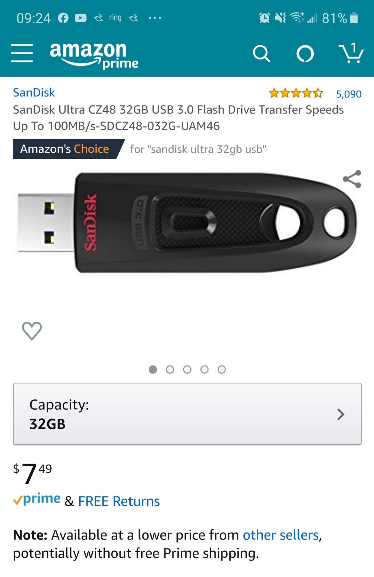

Originally Posted by Rockinfigs
No.. I used 3 sandisk ultra 3.0. All 32 gb... File transfer was fast n install took 30 mins
link to your USB drives that you use, please...
Amazon has them.. Just do a search.. I got mine at target which was $6.99

Sorry, yes it is the nav files that I am downloading. When downloading I have been experiencing very long processing time as it creates the zip file and on a couple of occasions it has come up with an error during this process just before it was about to finish. This has me concerned that the extraction process may not be giving me all the files.
