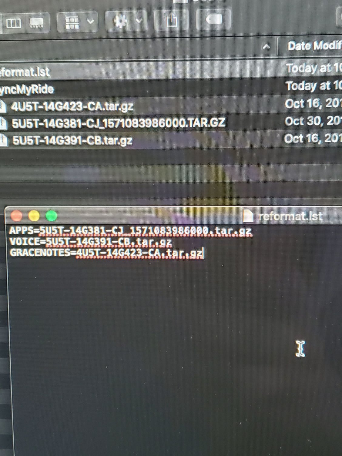

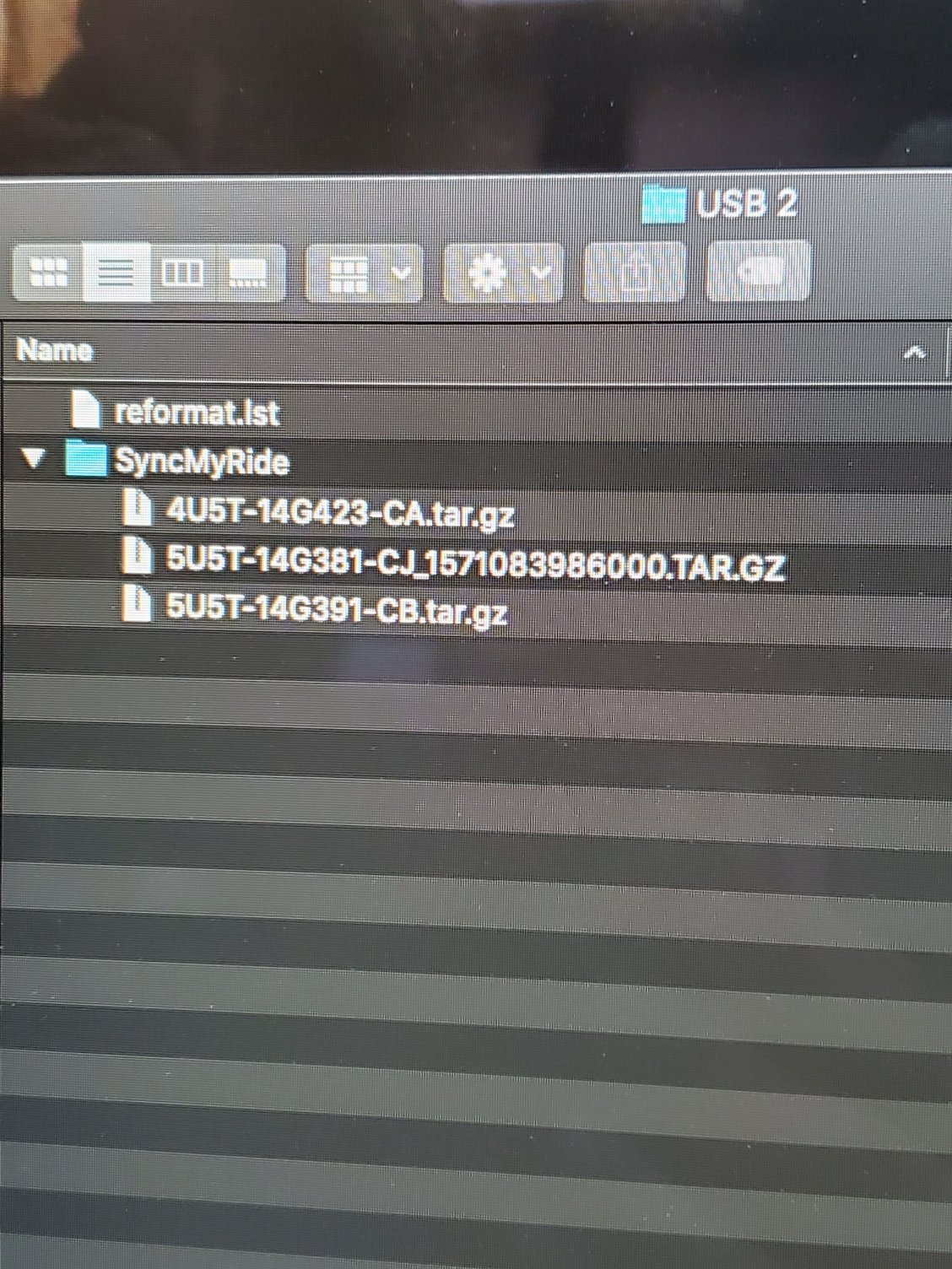

Just a heads up for Non-Nav owners (2017 F450 owner here) who are going to try the update from Sync 3 to Sync 3.4 and read the instructions in the link to the F150 forum mentioned in a previous post. I did the update a couple weeks ago using Tricons files and also never saw an update completed message after inserting USB 3. Sync updated and it showed I was on Sync 3.4 and everything worked fine. I did not realize that I was on version 19200 and that due to a memory storage capacity issue I never actually updated to the latest Sync version (19274) after inserting USB 3. After reading other posters having a similar experience and reading the thread in the F150 forum I learned I had to modify USB 2 using a file from the USB 3 folder to actually get the latest update. The instructions given in the F150 forum are incorrect if you are using the files from Tricons download (they might be correct for the files from the F150 forum). The instructions tell you to remove a file with a .CB extension and replace it with the file from USB 3 and then edit the .LST file to reflect the change. This is incorrect. You should replace the file with a .CD extension not .CB. The file you are substituting in USB 2 is the Apps file not the Voice file in USB 2. I have attached two photos that show the correct files for USB 2 Non-Nav owners. The update uses the original USB 1 stick and the modified USB 2 stick. There is no USB 3 stick used because of this modification. My truck updated to Sync 3.4 ver. 19274 after this modification. Hope this helps and clarifies the procedure for others.

Attention non-Nav owners:
You're better off using a two USB install strategy. The non-Nav does not have enough memory to use the 3 USB install method in most cases.
EDIT: Just noticed that @blueglide posted just above me with excellent instructions.
You're better off using a two USB install strategy. The non-Nav does not have enough memory to use the 3 USB install method in most cases. I have a Nav myself, but what I've seen non-Nav owners doing is replacing the *.CB file with the *.CJ file (current version). Make sure you edit the text in the *.LST file in USB 2 to reflect the file change.
Leon McKee
See my post just above yours...you should replace the .CD file not the .CB file.
You are 100% correct!
I did a copy and paste without verifying which is my bad. 381 is app and 391 is voice.
Edit: I looked at my USB2 files. All match except the voice file which is explained in a post to swap out.
