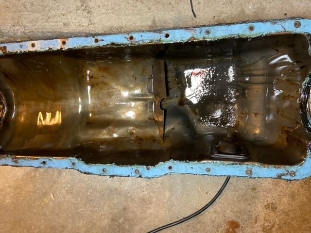

I'm really not sure. That plug is definitely not flush on the bottom and was replaced at some point. I'm going to get some brass ones to replace those. I'll know more once I get the pan off and have a look inside. The engine is really clean inside on the top end so it is possible. I'm not expecting any surprises on the bottom end.

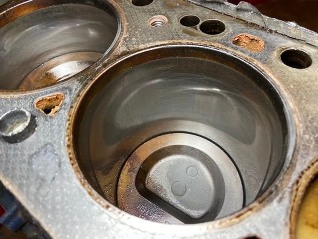

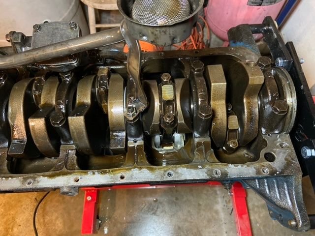

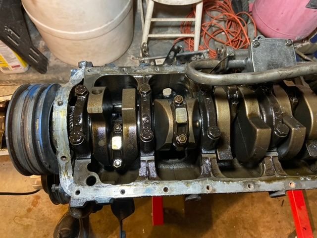

Well tonight answered the question about being rebuilt and it looks awesome.
I’ll get it cleaned up and back together over the next week or two.

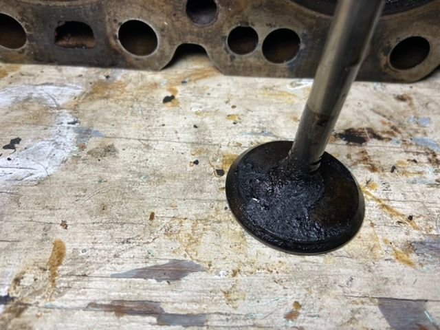

I got the head apart last night and boy, it isn’t as pretty as the bottom end. The good news is the valve seats and valves aren’t pitted, there is just a bunch of buildup that needs cleaned. The valve seals were shot and the new ones will be here tomorrow.

It always seemed to me that the late 50's, 60's and up to mid 70's, Ford had **** poor factory valve stem seals.
50-75 thou miles and they were dried up, broken, hard as a rock from heat. I don't know how many of them over the years back then that I dried up the oil consumption/puffing after putting new seals on.
