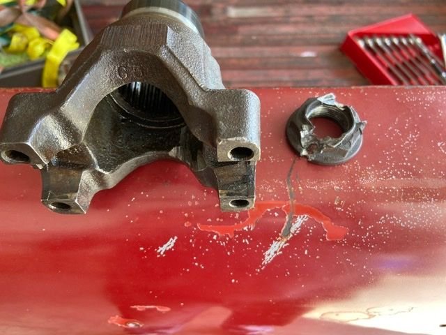

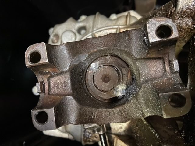

Borrowed a socket from a friend to get the yoke off of the trans. It wouldn’t fit down inside the yoke to get to the nut. So I got it off the only way I knew. With a drill, chisel, and hammer. This is what victory looks like folks. One major leak left.

I've had to grind down the outsides of thin wall sockets at times to do those scenario's.
I have a 3/4 drive that I put on a metal lathe and turned it down to fit.
Some manufacturers make things difficult to work on......buy special tools......etc
