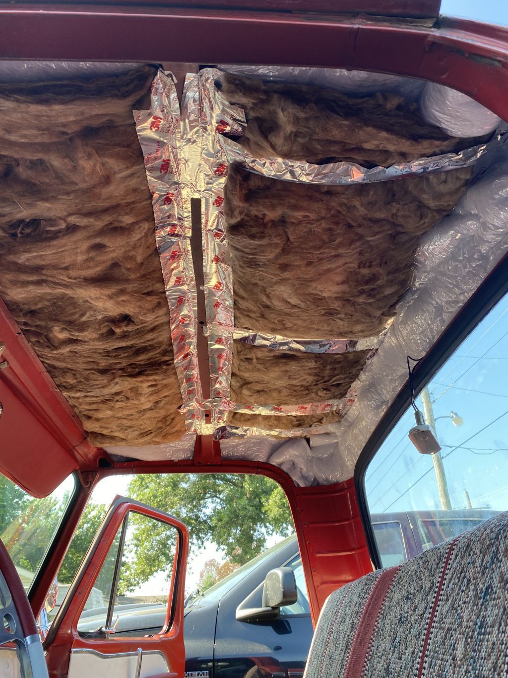

Been a minute since I did an update so here goes. The exhaust manifold (300 i6) cracked clean in half and had to be replaced. I managed to break a tab on the intake putting it back together, but my neighbor was able to weld up the tab. He is a welder by trade. I also shredded a rear axle bearing. No pics of those repairs as it was old parts out, new in. I have also been working on the interior some more getting it closer to what I consider done. The glue (3M Super 90) let go on the headliner. I tried using more and it held for another couple of months. I had to use something else so I got the DAP adhesive that I know is heat resistant and redid the headliner for the third time. It will stick this time. During the upholstery process I realized that I was short on the perforated white vinyl so I switched gears and used some red instead. I bought 15 yards of red to ensure it would all match and have used it for everything I recovered so far. I'll call it a happy accident as I think it looks better. I made the back part of the headliner and the top trim ring from hardboard sourced from a local upholstery supply where I get my vinyl. I needed the trim ring to hide the rivets holding on the front clips. The sun visors were sewed up by a friend of mine and there is a shot of what I did for insulation since some have asked about it on the forum. This makes a world of difference in sound and temperature control. The dark stuff is fiberglass and the white insulation came in boxes shipped with our Home Chef meals. I ended up using that white insulation throughout the truck pretty much and it works great.
