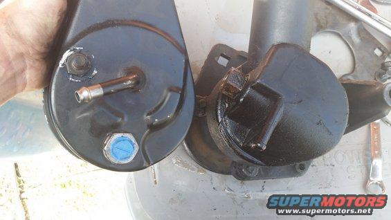

Fordman and AB: I have this saginaw pump (below), and I need to cut off the two return line attachment tubes, just past their hose flair, so I can slip on a compression attachment hose fitting. But I can't get metal fragments into the tubes. How can I prevent that?

Not sure on the Saginaw pump. However, the back side of that one looks a lot different than mine. The return hose was nice and short, and then there's the single hole (the one with the blue plastic cap in it) for the high pressure hose to screw into.
Saginaw on the left, stock on the right.
Maybe you could track down a different casing in a JY?

Yeah, I could do that. But I'm going to put compressed air in the top and vacuum at the tube, and cut off the flair. The compression fittings, I hope!, should give me a leak proof seal. We'll see.
I think the pressure connection, one return line, and the brace stud are in the same position on both reservoirs. Mine just has an extra return tube, right?

Before doing any cutting, I would take the pump out of the casing, so that you don't have to worry about the shavings. You can just wash it out when you're done.

Oh boy, of course! The perfect solution. Thx buddy.

It was easy. That was the first one I've done. I didn't know the whole thing was sitting on an O-ring. Anyway, it's back together. Now I just need to press the pulley on, once I get the proper pulley.
