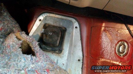

With mine, my sound was exponentially louder when I went from an auto to a manual, because I didn't properly insulate the shift cover boot hole. I only had the rubber boot, but had forgotten then insulator that goes down first.
The sound went from feeling like I was sitting on the engine, to a nice quiet cab. A lot of sound comes out of the shifter hole.
Do you have this rubber insulator in place?

Do you have this rubber insulator in place? Nope, I don't have that. I didn't know it existed!!! Thanks, AB. I think I will stuff the riser block I made with some type of insulation to prevent dispersion of the noise.
