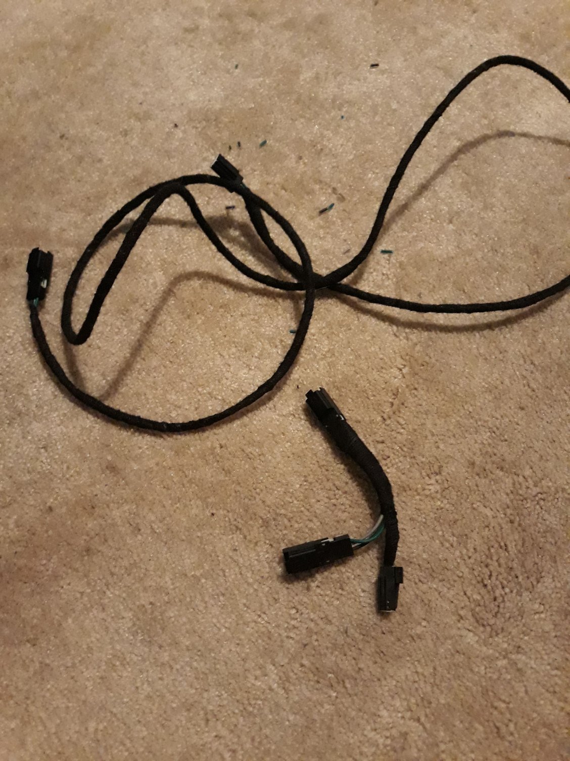

Yup, no way to get to that console harness. I can fish my hand blinded through the opening in the console to touch it and that's about it. Made up the long wire today and small jumper harness to the right footwell light. Waiting on the replacement console still.

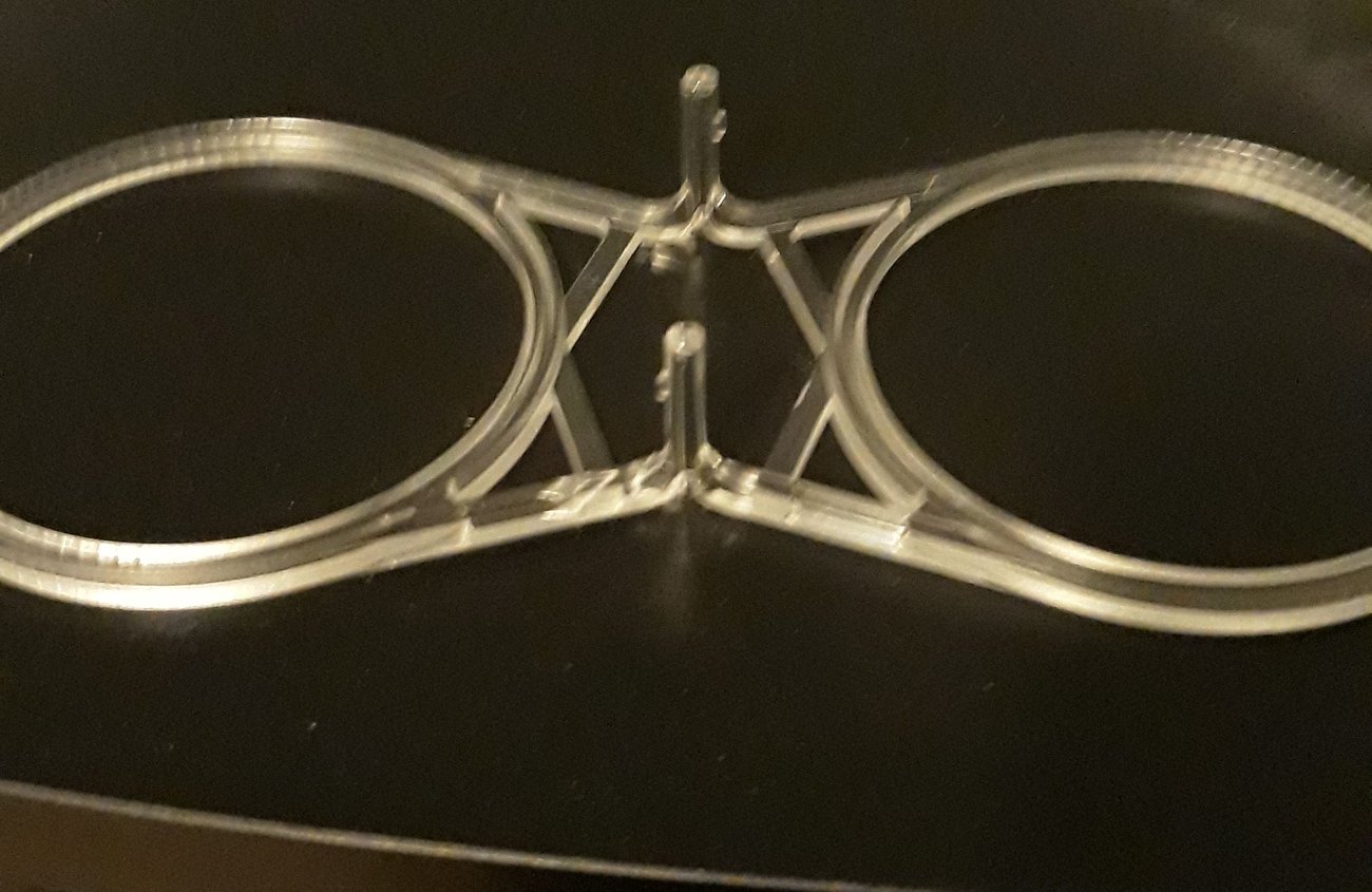

Got new one in. Works flawless. Since I was bored with the other one I took it apart before sending back and this is what lights up. 2 ambients hit the plastic pegs and the light travels through it. Broke or not it lit up the same as the new one LOL. So I would have been fine with a tab of epoxy to fit it.

@Mkos1980 - What is broken on that piece? I need that part if it works. What to help a brother out?

One of the posts was broke off. For giggles I epoxied it back on in that pic since I was sending it back anyways and it worked identical to the new unit. Unfortunately I sent that console back already with that part.

It is a sham they don't sell that ring by itself -
Looks good, even better when you figure you didn't pay $3,000 for an ultimate to get it
