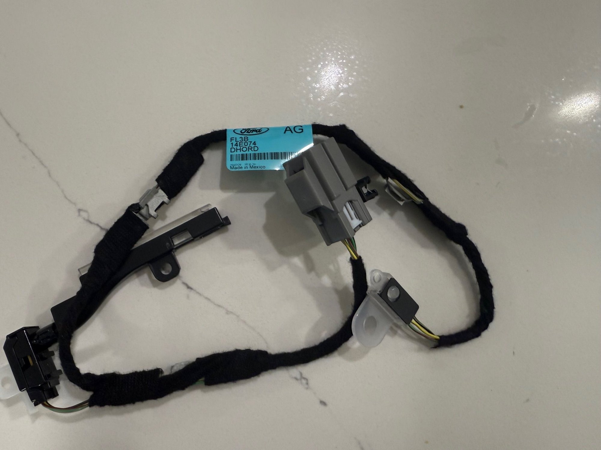

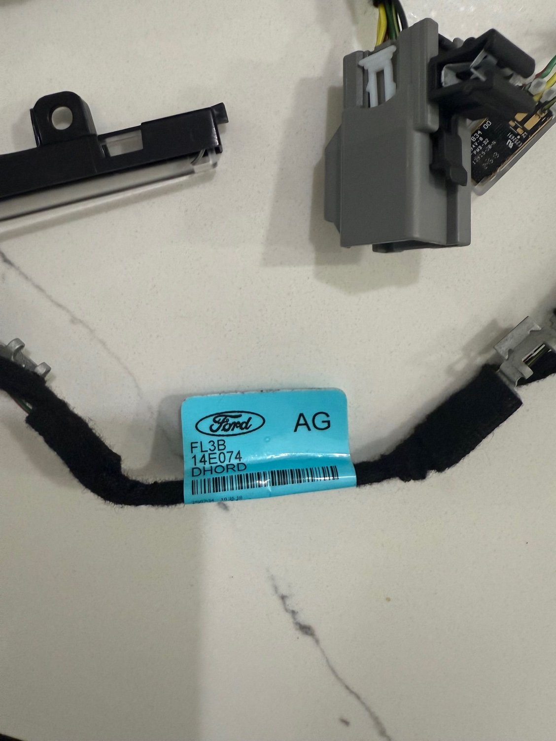

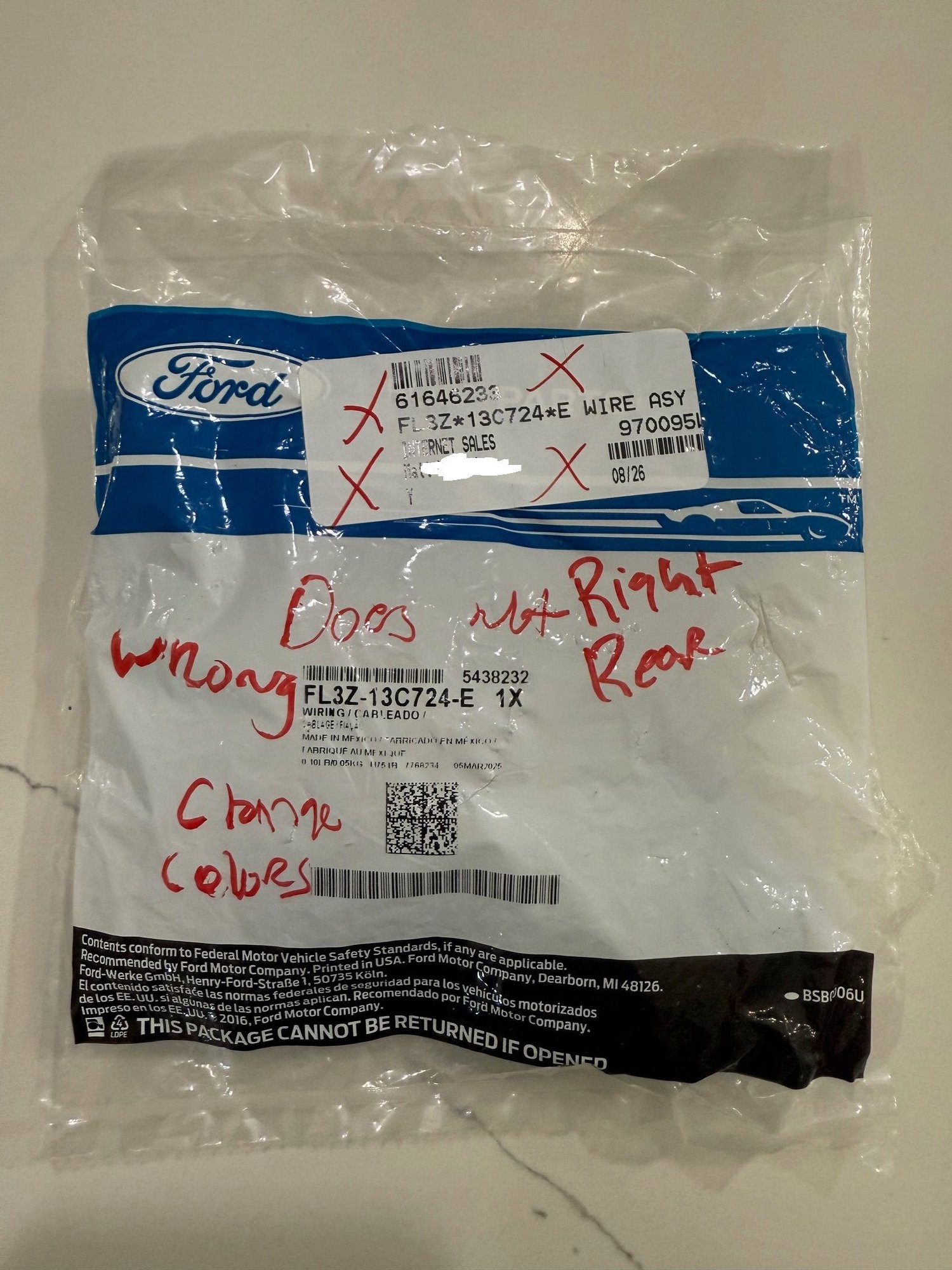

Has anyone ran into issue with getting the correct multi color leds? I ordered all the ones posted here from tasca parts. the one for the right rear door is single color and does not change only ice blue. the part number i ordered for this is "FL3Z-13C724-E right hand door rear" the bag says cannot be returned if opened. did the part number change? All the rest work as they should. I was just gonna order another left but the addressing would be screwed up for door open indication...
UPDATE- I sent this back to tascaparts to send to ford for warranty we will see what they come up with. provided vin for a 2017 platinum, they said their system shows "it may fit"

just follow up, tasca parts sent the unit to ford and I assume they deemed it defective because they did send me a full refund so there is a batch of these going around that are not multi color. I have seen few people post with same issue on the f150 forums.
