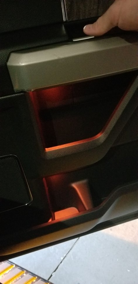

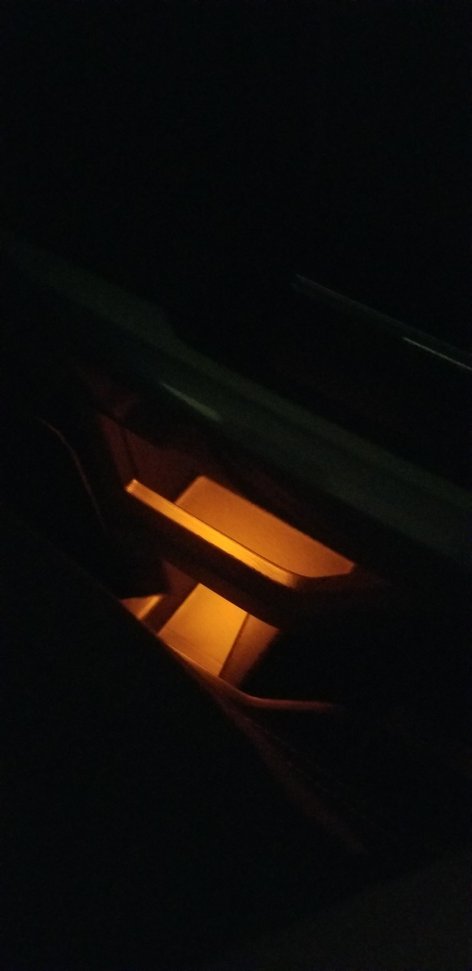

Made my own, with 5mm LEDs. 2 in ea door. And 1 ea under the OEM location under the dash.

They came out really nice as well
thank you for sharing !!!

Looks great!

Although 19s are fixed I'm glad the forscan let me enable the color options on my 19. Also using 17 and 18s led modules.

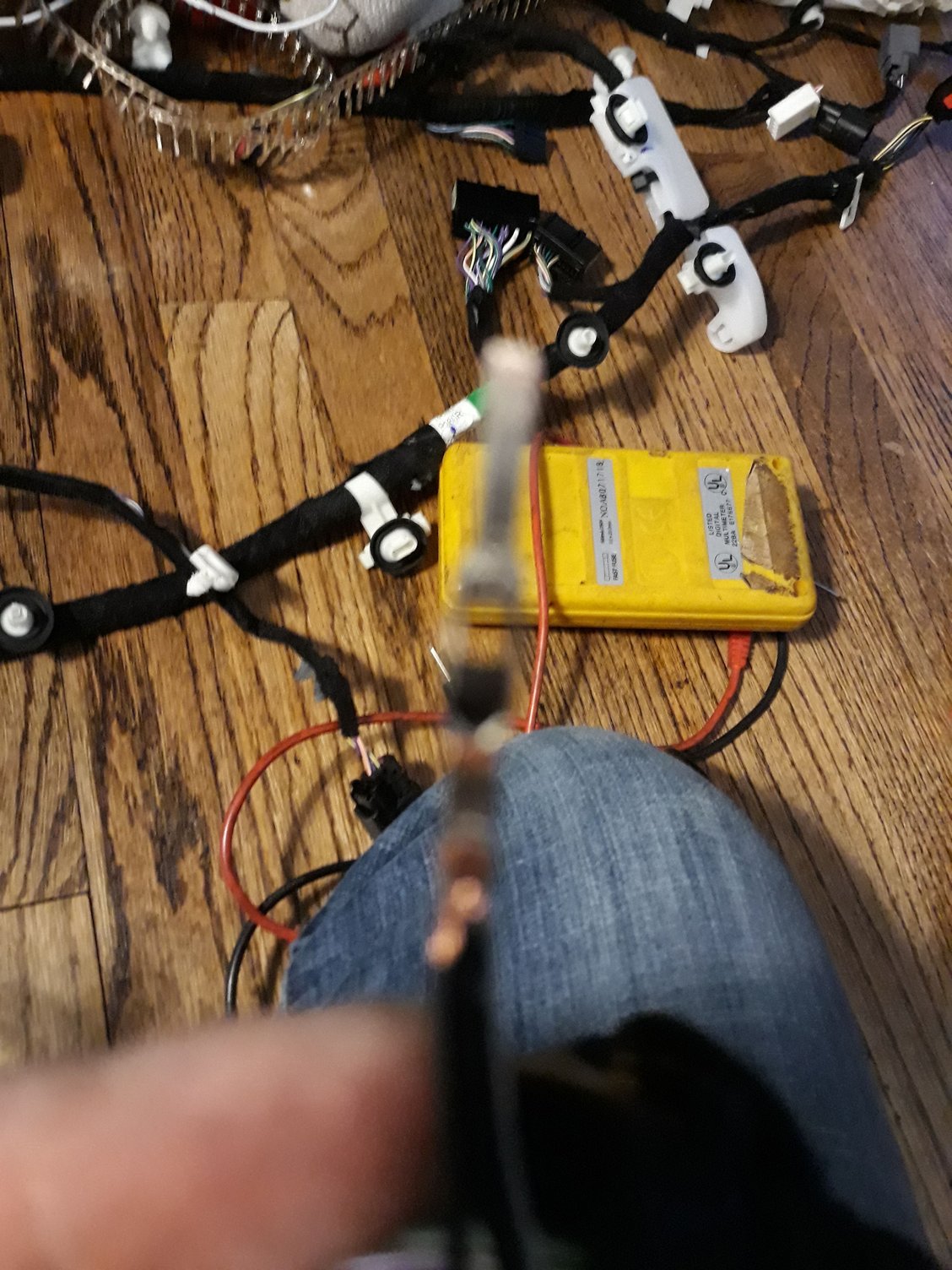

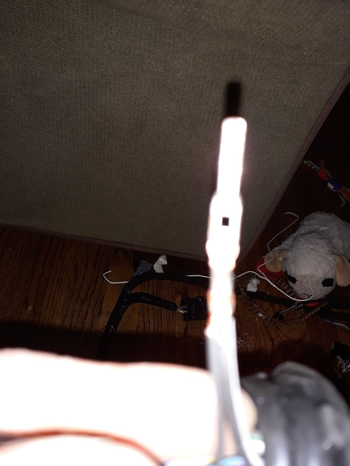

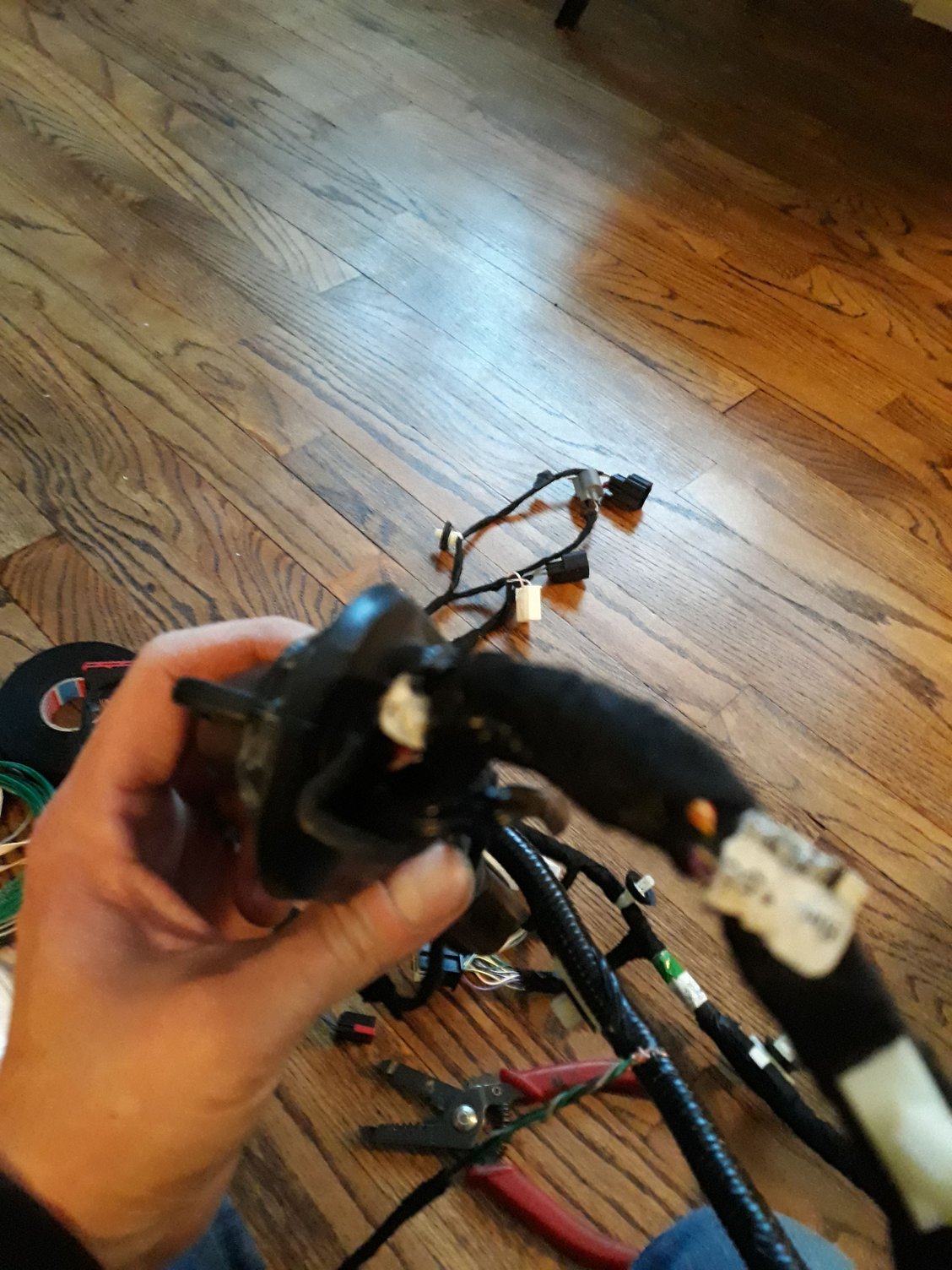

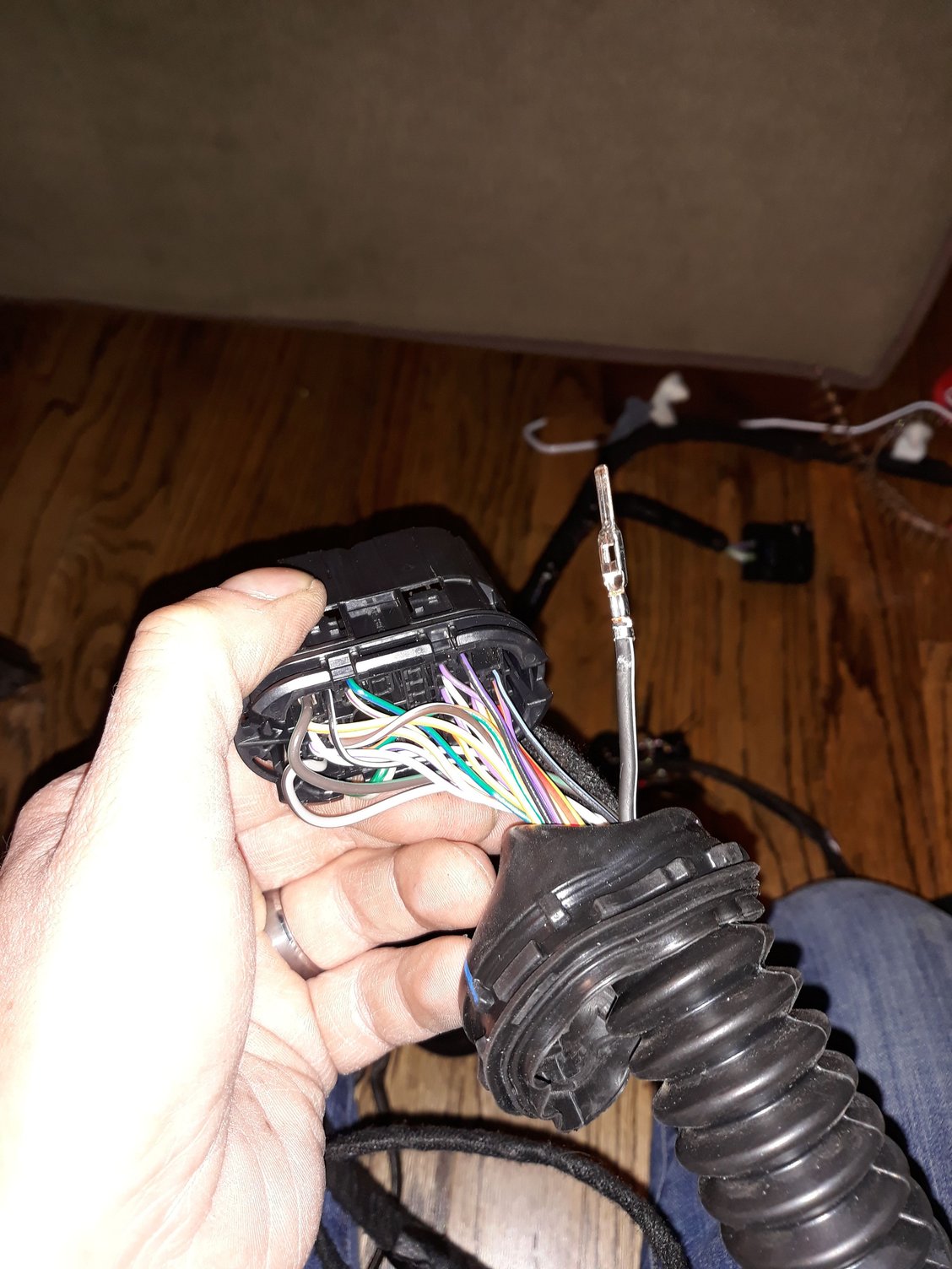

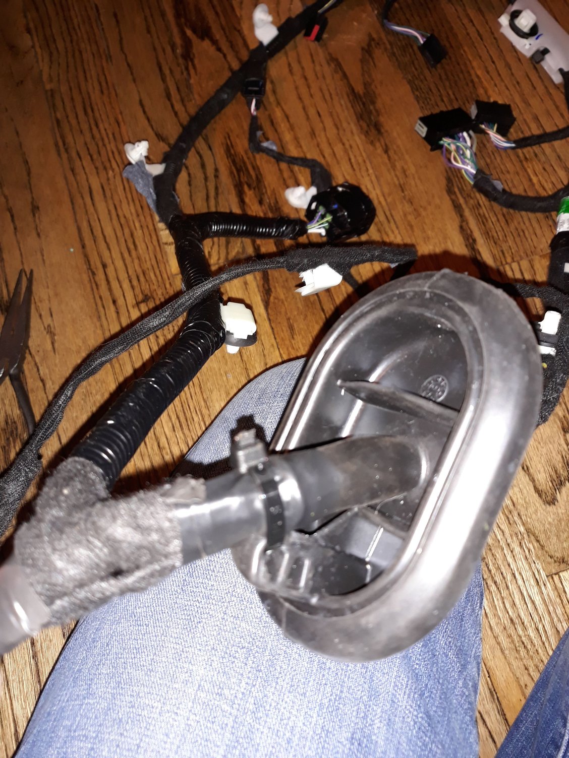

Front doors have a ton more wires lol.. took 2 hours to remove harness, integrate it, install and put the panel back on.
Pulled the wire through the inner door boot.
Other side. I fabric tapped it all as its easier to slide through.
Boot pulled away from door connectors
Old Feb 27, 2019 | 07:15 PM
  #87
Mkos1980's Avatar
Mkos1980
Joined: Sep 2018
Posts: 909
Likes: 18

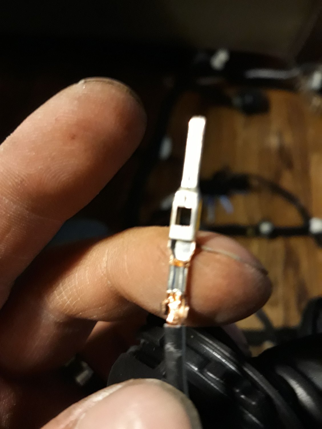

Pulled the negative terminal out to modify it for the ambient ground.
Opened up the crimp holding the wire skin. Cut the skin away that would be underneight. Gives it room to crimp the ambient wire in.
Both crimped together now.
Tapped back up and re ziptied it.
Success, doesnt show well with a flash lol.
the other 2 wires were fished along and put in its corresponding spots. Its idiot proof as theres only 2 wires coming from the cab and on the door harness side it's missing the 2. After I reinstalled everything I put a meter on each wire to make sure 1 of the 3 didn't break or my crimps were no good. I bought a semi pro crimped for molnex connectors in amazon for 25 bucks and it's worked great
Old Feb 27, 2019 | 07:18 PM
  #88
bernie165's Avatar
bernie165
Joined: Sep 2018
Posts: 313
Likes: 100
From: Western NY
Well done and thanks for the pics! I think I will be waiting on the doors for a bit LOL
