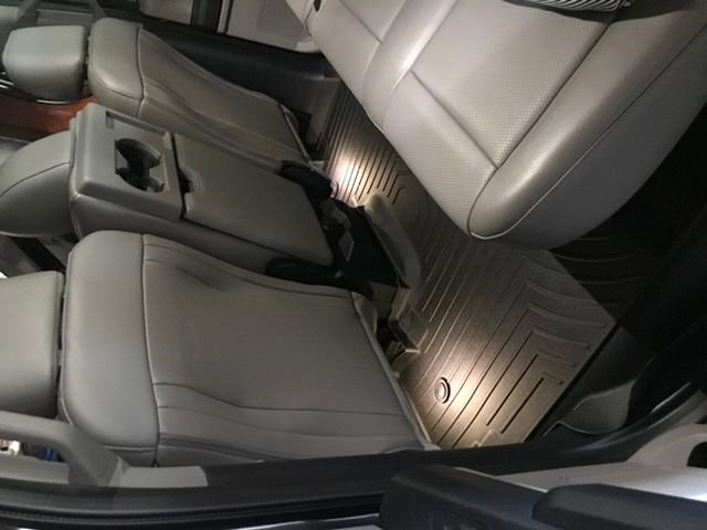

Interior led lighting
It’s not ambient lighting but I added led lighting to the interior. Powered by the truck bed led. They come on when you open the door and fade off. I can turn them on or off with the truck bed light switch.

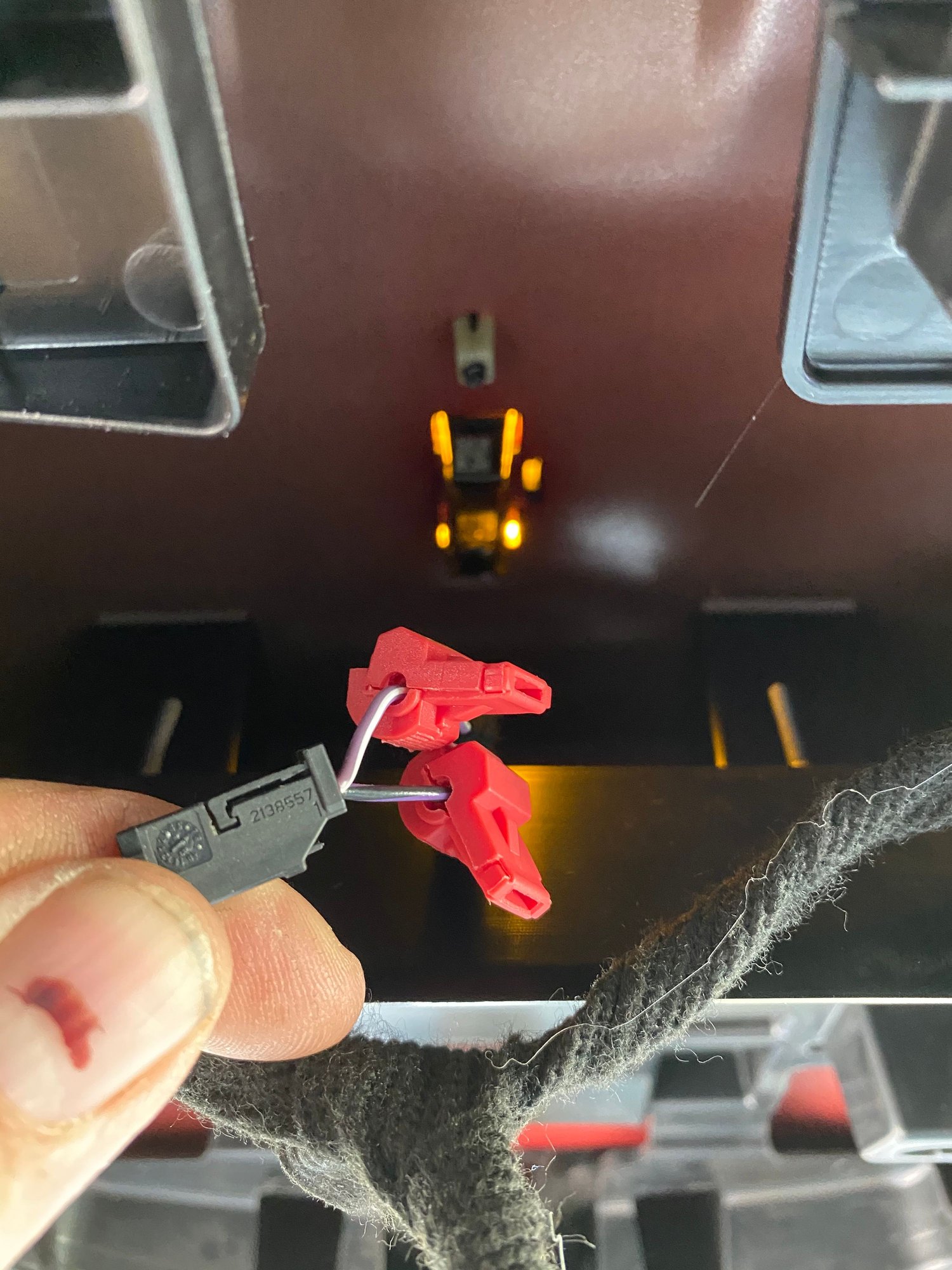

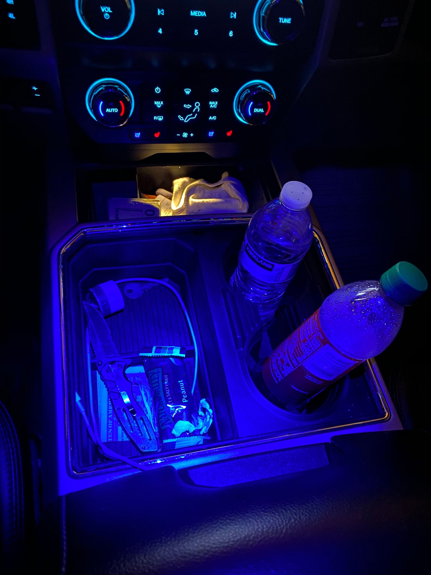

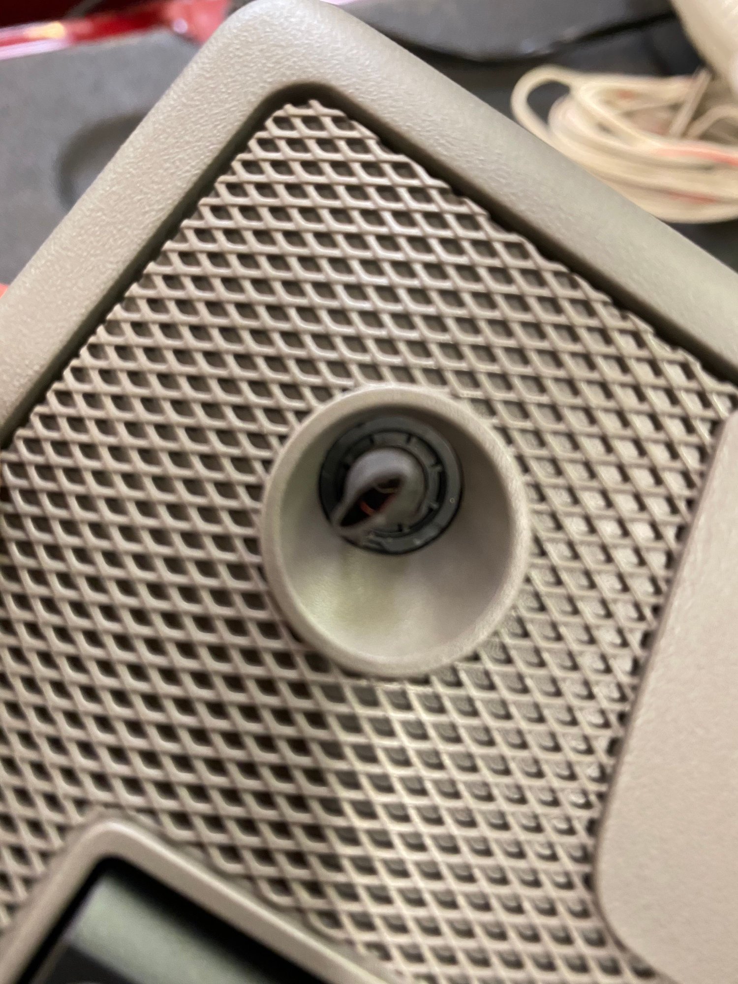

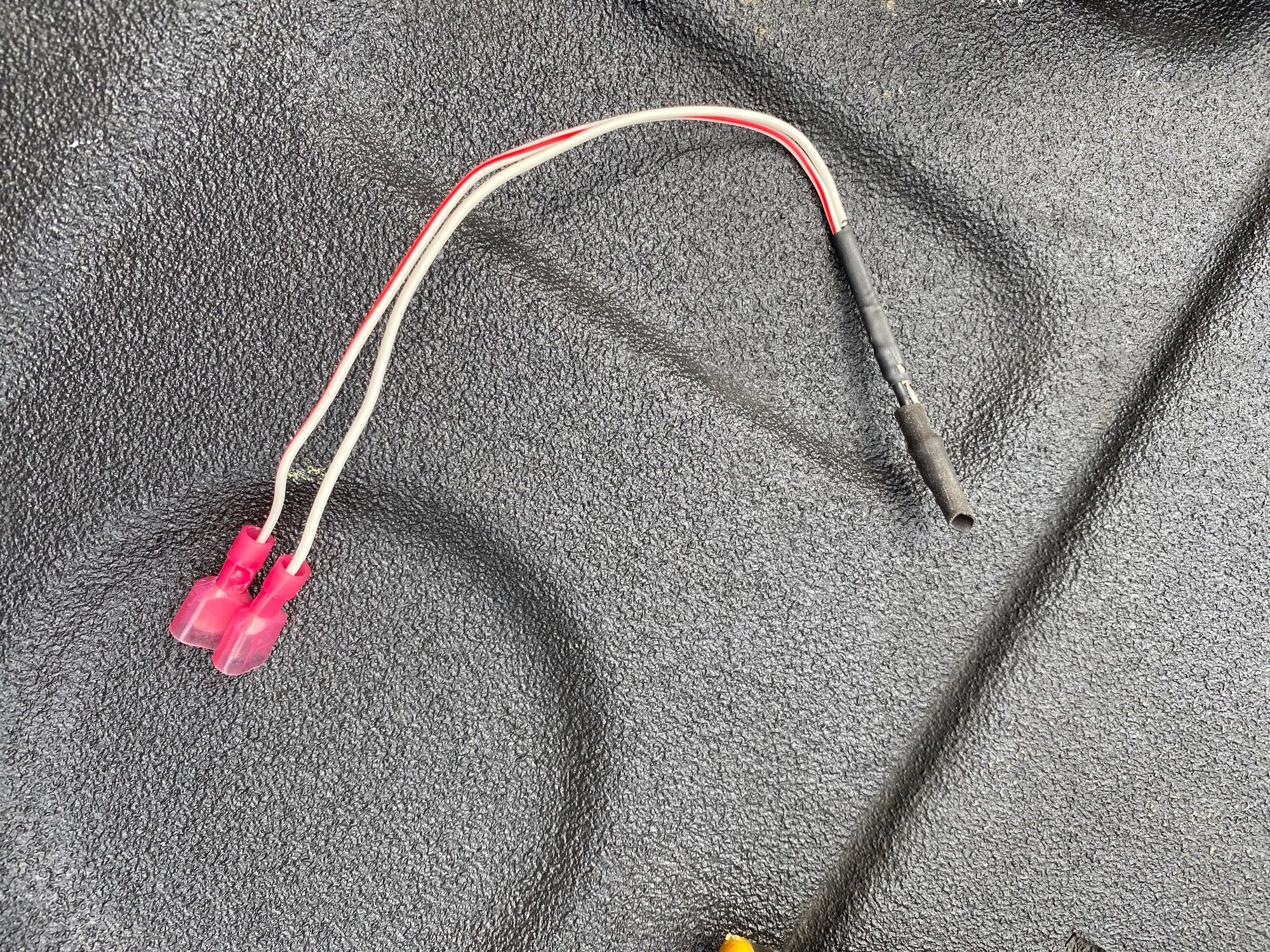

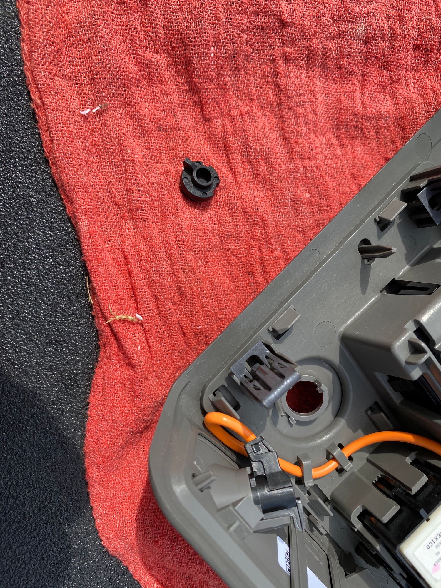

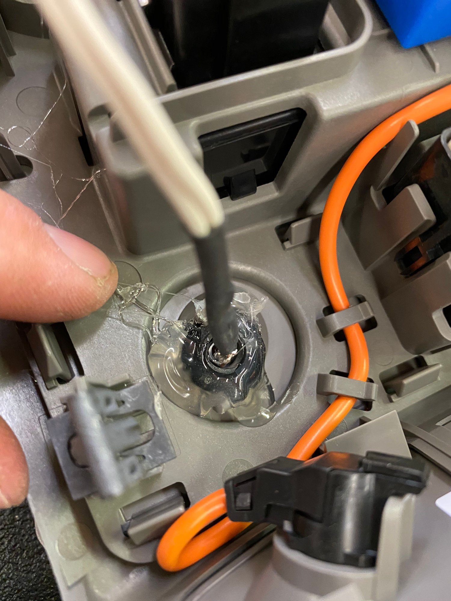

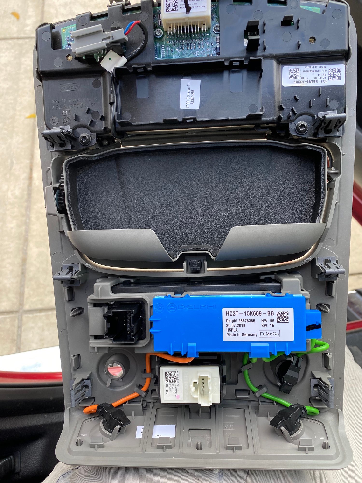

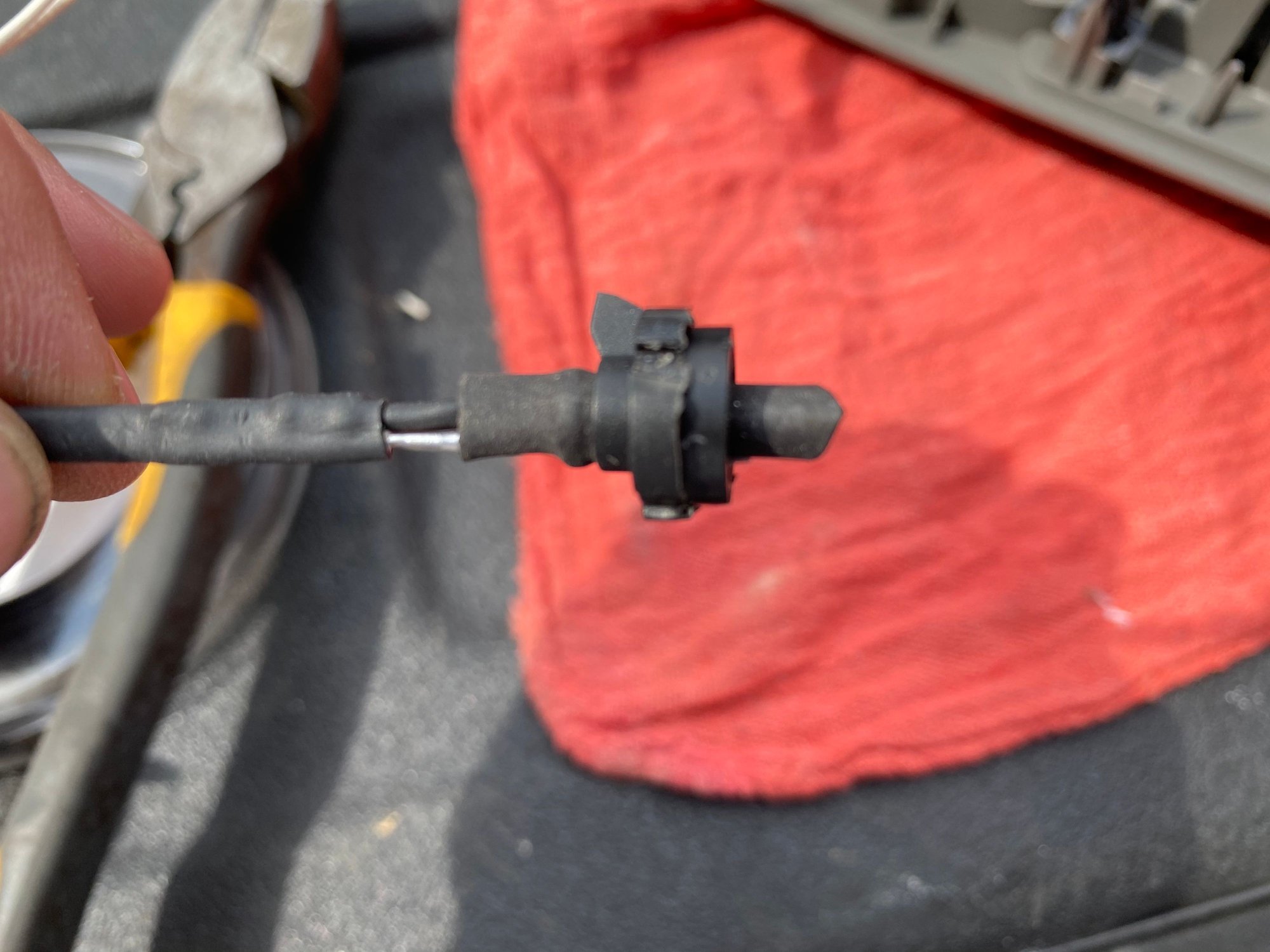

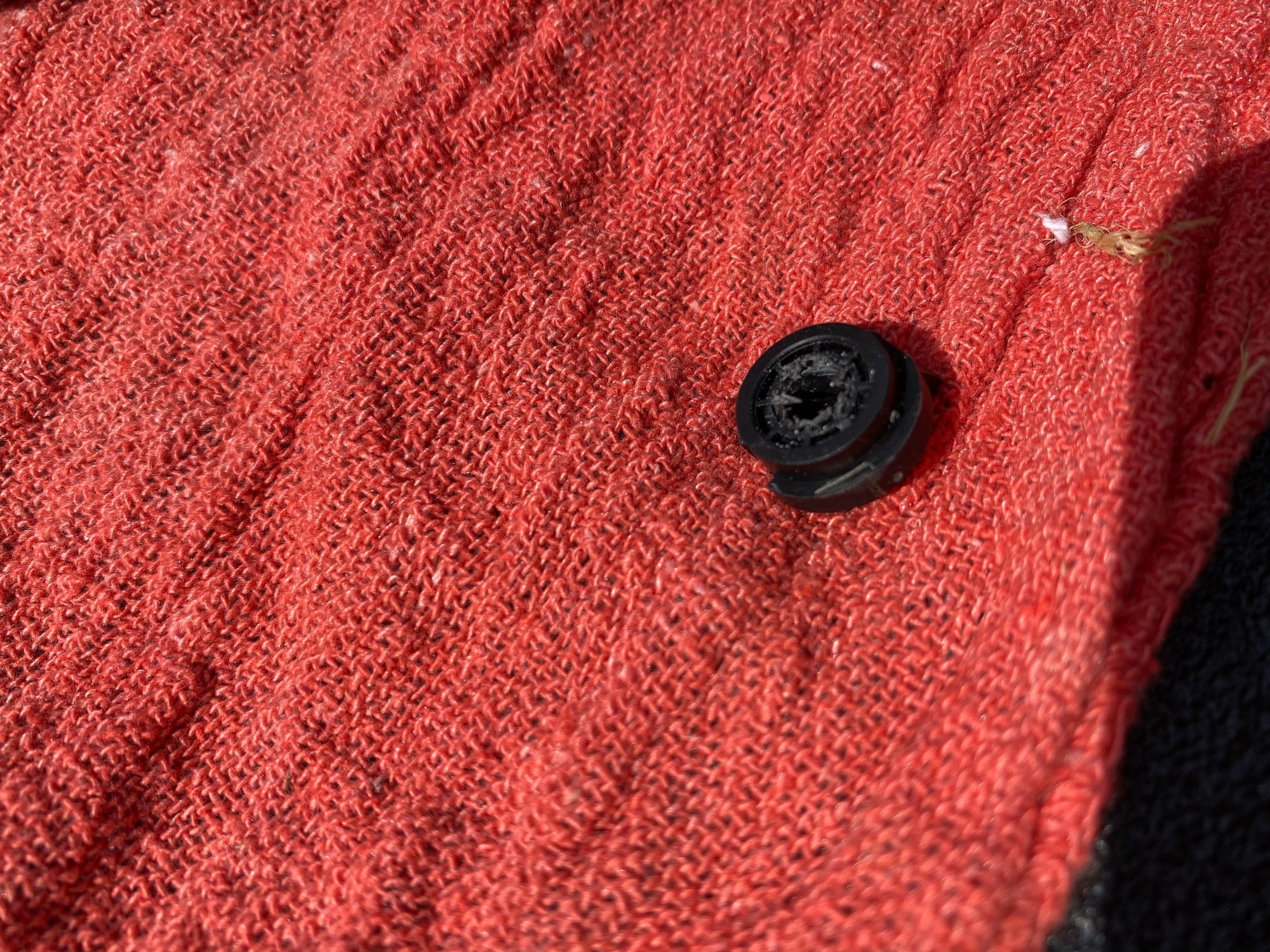

I added a blue LED to my ceiling console to better light up the lower center console.
Underside of headliner console. Note there is a dummy sensor on bottom left.
My truck has the roof marker lights, so I tapped into the center one for my LED power.
I drilled out the black insert and inserted the LED bulb assembly.
I soldered up an LED with in-line resistor. I wrapped the end of the bulb in heat shrink to help form the beam.
I hot glued the black piece back in
I may switch the LED out to a red one with a higher OHM resistor to make it not so bright. THe blue does match the rest of my ambient lighting in the truck.
