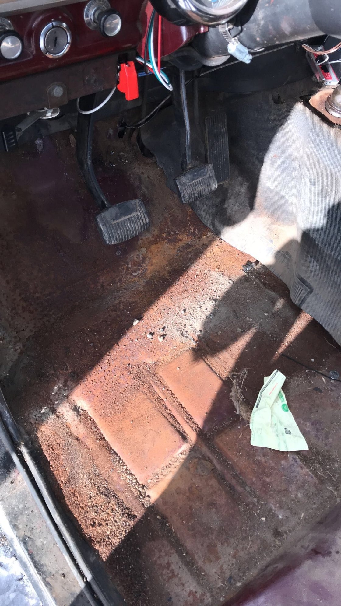

Earlier in the week I had taking apart my interior to install sound deadening material and I was met with a awesome surprise after I pulled off the floor mat.
I vacuumed up about a pound of rust off the floor boards and the metal is pitted so bad and has several holes. So I ordered new floor panels from TabCo and will be installing them soon also

If you have the floor pans out, might as well do the cab mounts too. My bet is they are paper thin

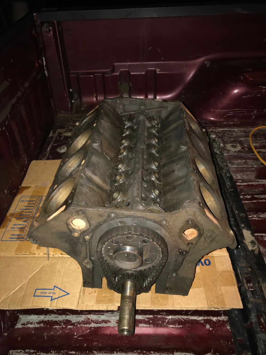

From: Bismarck, ND
Just picked up the short block about 15 minutes ago, definitely needs a cleaning. I was getting the edelbrock due to having head work to do anyways and to just avoid having to worry about it. I also already have the rpm and a 750 carb to go with it

OK, so that engine has a lot of miles on it. That timing chain has a fair amount of stretch and the lower gear shows a lot of wear. Absolutely have the block hot tanked and measured to see what you have. Also verify that it really is a 390! The crank should be labeled as 2U or 2UA. If it has a 2T or 2TA it is a 360.
The guy that I bought it off of told me it was in decent condition, so noticing when I got it that it was barely decent condition I did check the crank and it is indeed a 390, and it rotates partially by hand (slight cylinder rust is stopping me from spinning it more. Sometime this week the block will be dropped off and bored, honed and cleaned up. Gonna have him install core plugs and cam bearings for me and also inspect the crank. Unfortunately I work 7-5:30 and his shop is open 8-5:30 so I need to find a way to get it to him.

Upon use of my eye and finger micrometer, the crank itself is very smooth and shiny still. Obviously it will be miked properly at the shop this week however. Upper (which ever bearing is inside the cap) is also smooth but is copper in the middle so the engine has clearly put some miles onto it, however looks like I might have gotten lucky
And to reply to your comment about the cab mount, yes the driver side front is definitely rusted out. What is your guys recommendations on where I should order new driver and passenger cab mounts? I just ordered floor pans from TabCo

I've heard that TabCo does quality cab mounts. But I haven't delt with them personally.

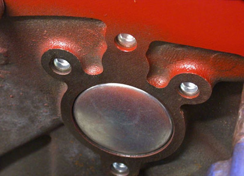

Something to watch for. There is a plug at the rear side of the block end of the cam Make sure it is installed from inside to the outside. Some shops will press it in like a regular frost plug. That is wrong. This what it should look like:

Get the cab mount from Dennis Carpenter as it will closely match the original. The Tabco units are not strong enough. There have been many on here that have used the one piece stamped units and had them crack.
