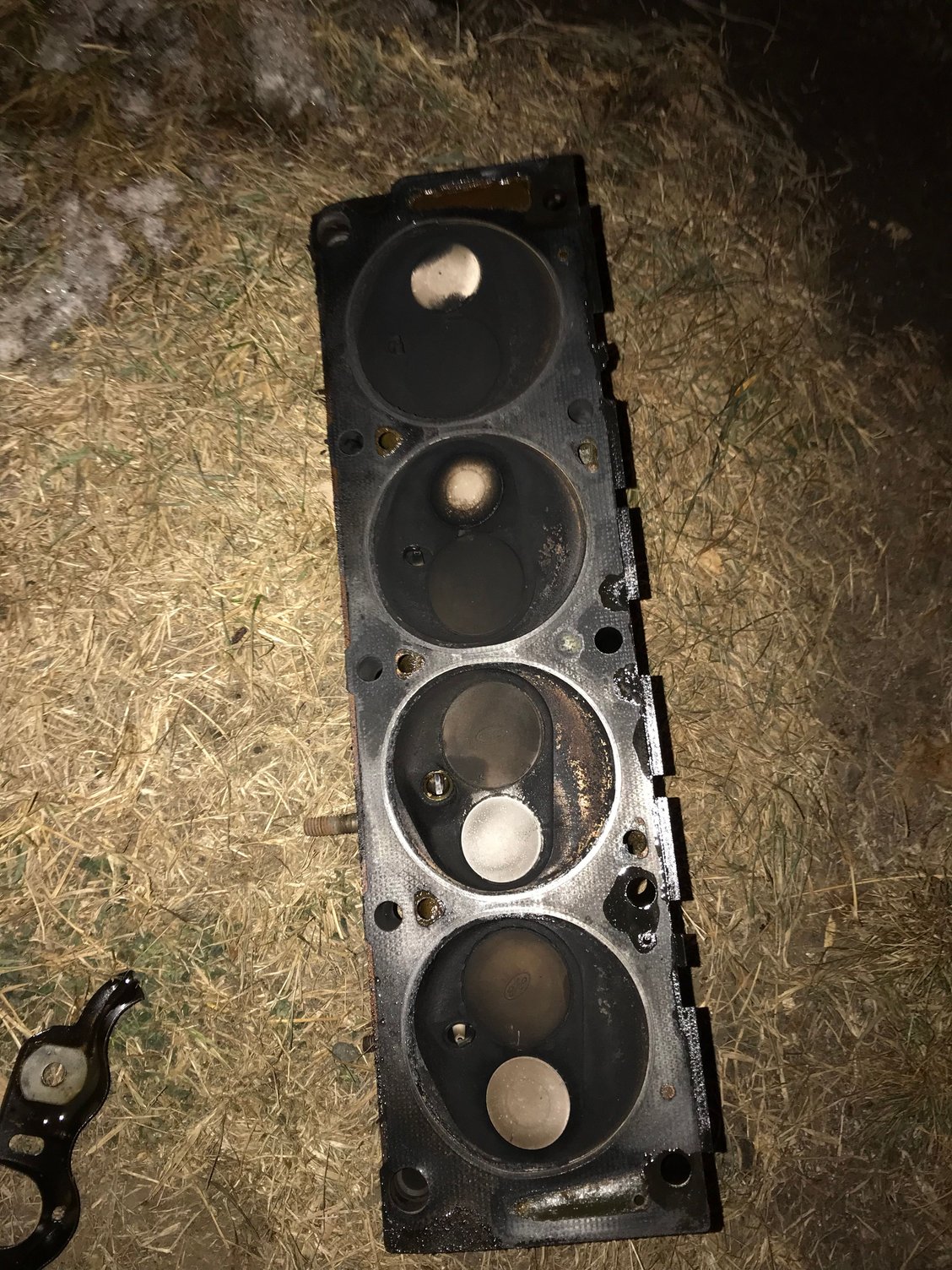

Got a good amount done today after work, figuring out more and more a rebuild was definitely needed on my old block. Burnt valves and carbon galore Also found out my new to me 390 block and crank is finished and I will be picking it all up tomorrow!
