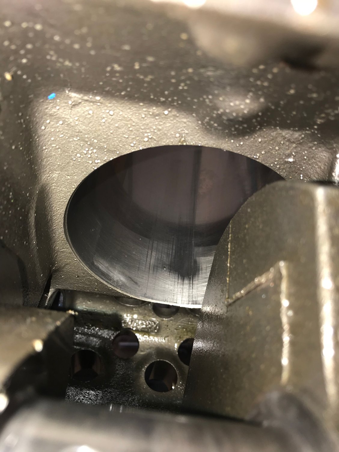

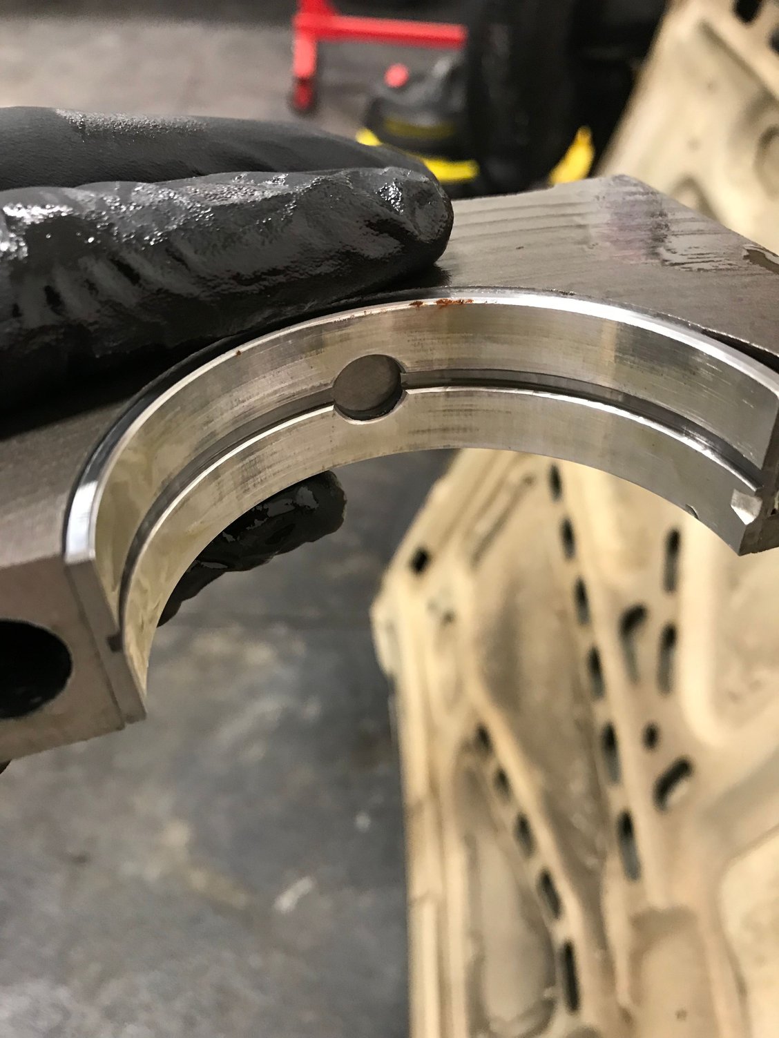

#2 main cap, all bearings I’ve taken off had these kinds of wear on it, engine had proper amount of oil pressure and I used plenty of assembly lube on every bearing surface for my crank. Yet all the bearings on the rods and main have this kind of wear.

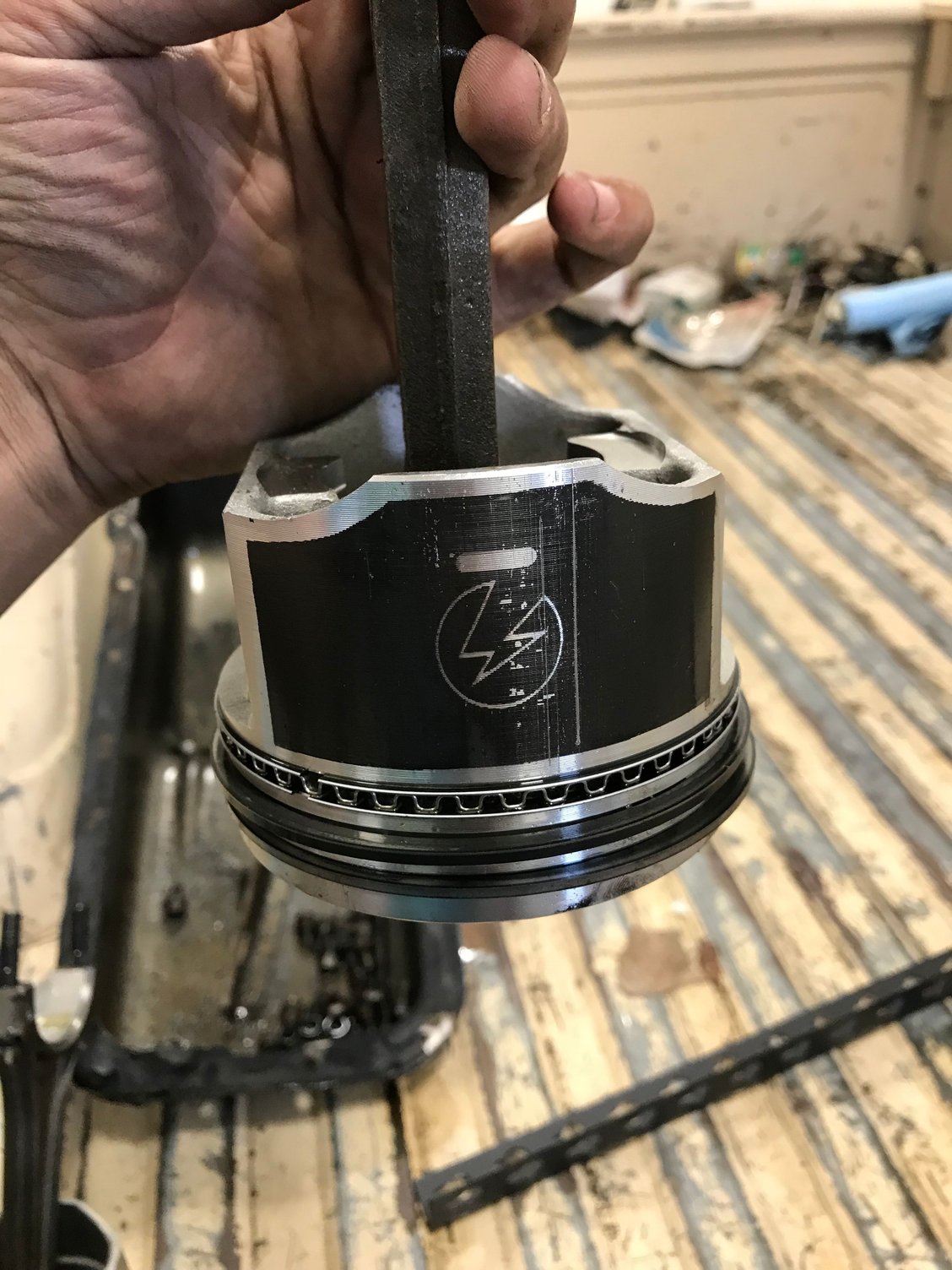

safe to say currently I might be looking at some big issues with my engine. Crankshaft is for sure gone due to the amount ground off on rod journals. All cylinder walls have that weird scraping and some are definitely deep. Not deep enough that my fingernail catches but I can still feel the bumps. I’ll accept responsibility for not insuring I’d have enough clearance on the side of my pistons, however the extreme wear on my bearings concern me. Cam bearing were even destroyed, but the cam surface on my actual camshaft has 0 signs of wear

what was bore size ? almost looks like piston is to small . standard piston(4.05) in a 4.08 bore

4.08 pistons for 4.08 bore, they’re forged hence why they might seem small

I was meaning by the scraps it looked like piston was flopping around in cylinder .
I would check the rings closely

rings look the same as they were installed in the engine. Straight, no burrs or signs of any wear

Bearing and cylinder wall scratching is consistent with medal particles from a failed cam lobe and lifter.
Had this happen on a performance engine tears ago, wiped a cam lobe along with about 1/8 inch off the bottom of one lifter.
Medal particles embedded into the piston skirts scratching the cylinder walls, one cylinder bad enough to require a sleeve to repair it.
Other particles where picked up by the oil pump and circulated through the system damaging the oil pump, bearings and in my case destroying the crankshaft.
I'd pull the oil pump apart and check it.

that actually makes a lot of sense, I had one lifter that basically looked like a meteor hit it, which was also the lifter on the lobe that had probably 1/2 inch ground off it

Run a light hone through the cylinders and see if most of the scratches will clean up, if any of them are real deep your looking at replacing the block or sleeving the cylinder or cylinders.
Have them polish the crank in see if it will clean up without needing turned.
Make sure there's no metal particles embedded in the piston skirts, if so see if you can dig it out, if you can get the pistons cleaned up I'd reuse them.
The pistons,rods and timing chain was I i could salvage from the bottom end of that performance engine back then, the block needed a couple of sleeves but I was able to sell that Boss 302 block for enough to do all of the machine work on a standard block and crank.
All of the oil galley plugs will need to be removed and the block flushed and cleaned real good.
