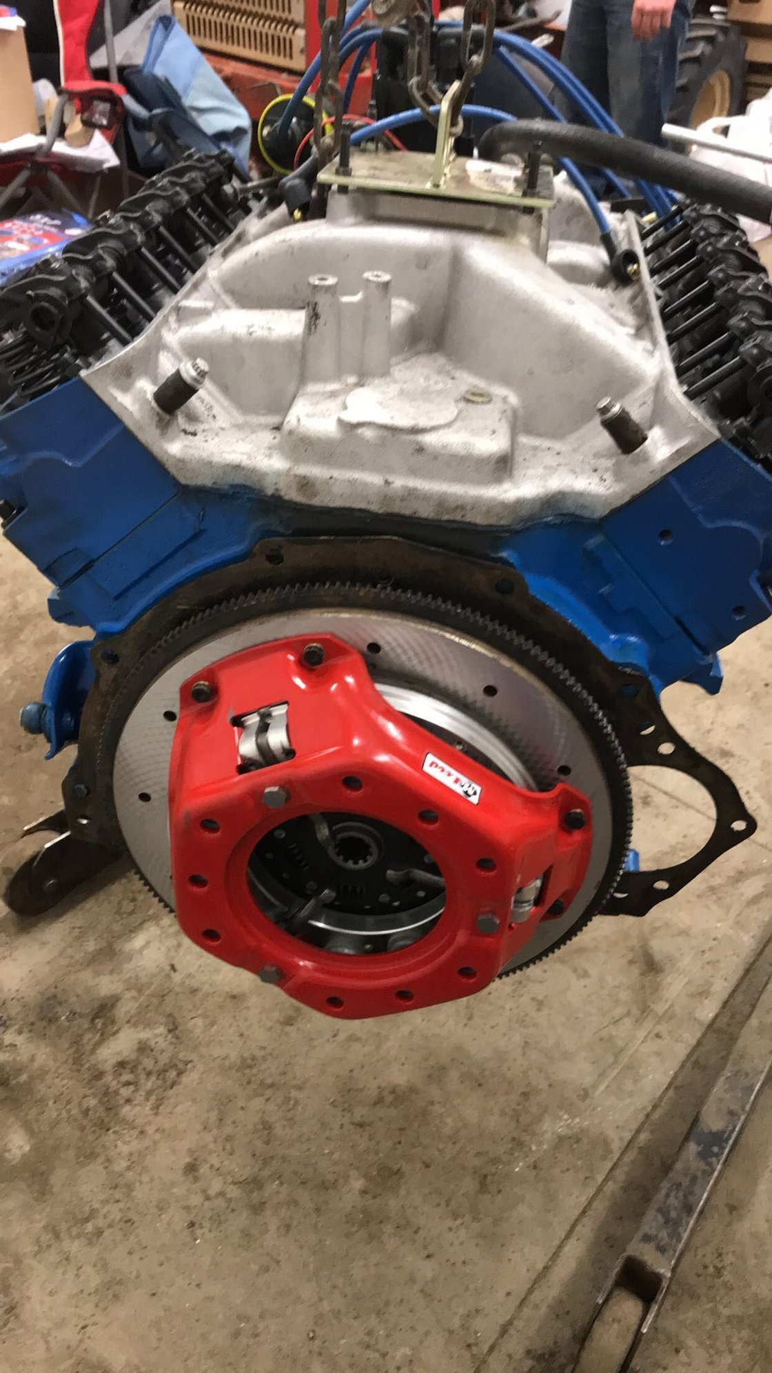

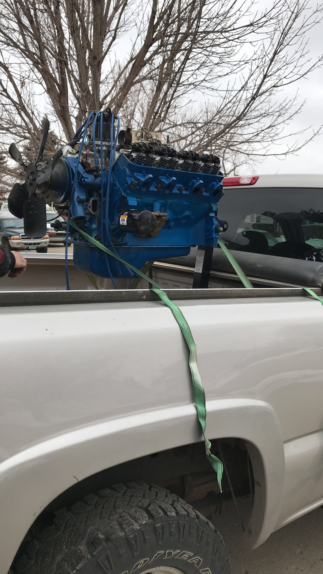

Had to play with the filter on my phone
Yes it made it home fine, even managed to fit my engine hoist in the back too
Apologize about lack of keeping everyone up to date, been dealing with some real frustration from simple small things finishing getting my engine done. But it’s done!(besides actually having the engine installed, I couldn’t get the T18 splines to line up correctly due to some weird angles upon install, even though clutch and pilot bushing are correctly installed. Gonna just drop the transmission tomorrow night and slide it on the engine and put both in as one assembly.

What brand clutch is that? 11 1/2 or 12 inch?
Looks like a McLoed setup.

McLeod 11 inch clutch
