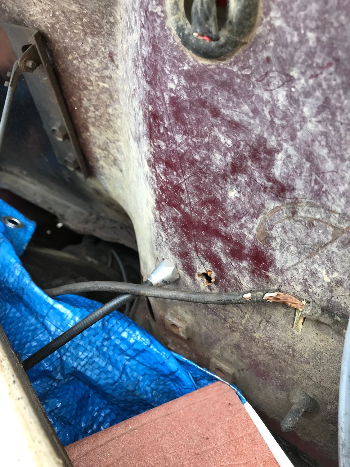

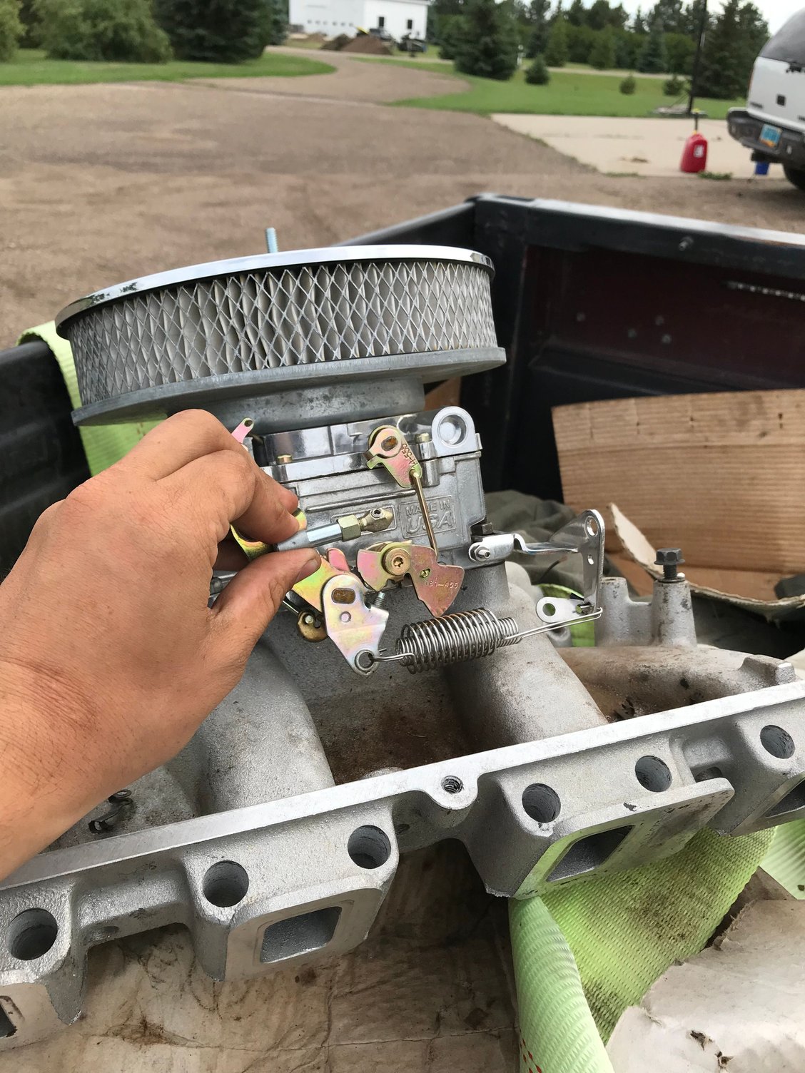

Bracket with hookup for the cable

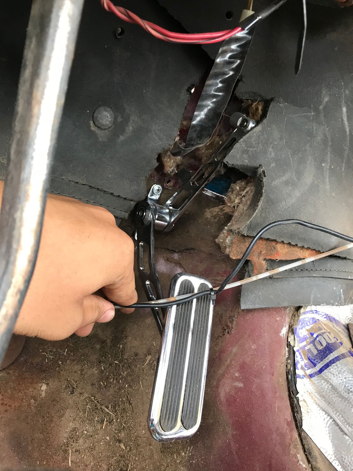

Mount up of the pedal

Ignore the messy pickup, currently have the dash taken apart for some more mods for me. Sanding the paint down to bare metal and clear coating the dash. All in all even with the price tag of the lokar setup it’s VERY clean, easy to setup and actually makes the throttle a bit more responsive. All I purchased was the bracket for my corresponding carb, bought a universal 24 inch cable kit which you can cut to your desired length (only need about 12 realistically) and then the pedal which was a bit steep in price. Lokar will also sell a Kickdown kit so you can connect your kickdown to another cable
