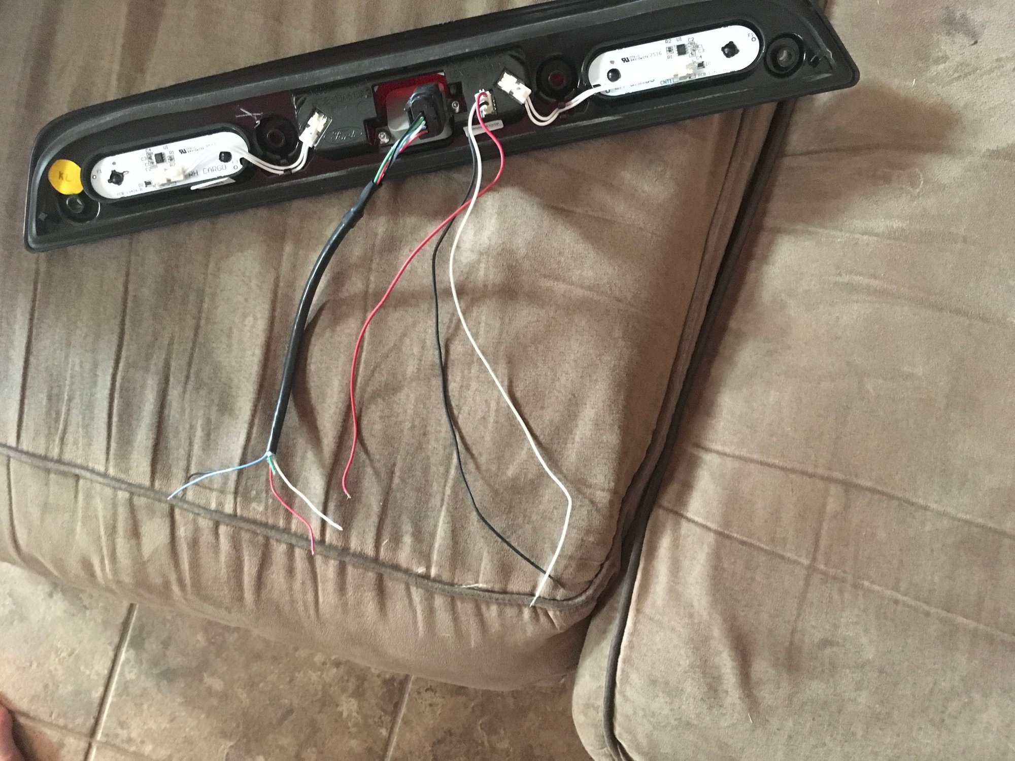

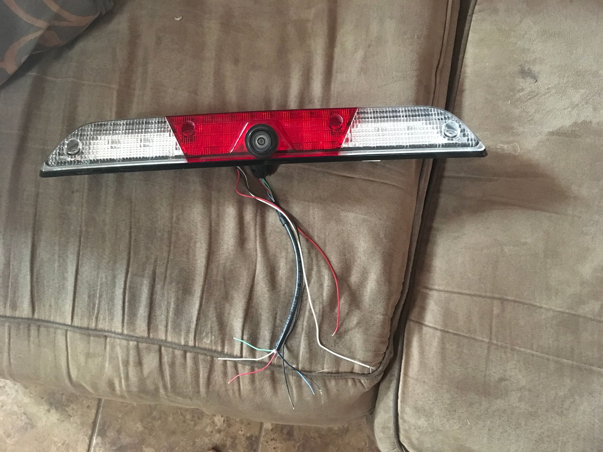

Something to ponder...the camera requires 4 connections, right? I say this based on the pic posted way above where the camera/light module is photographed. Pos and Neg for power and two for the video, if its a normal NTSC or PAL output. So why not install the hi-mounted camera/light assembly, run the 4 camera wires to the main rear wiring harness, and tap into the existing backup camera connection with a simple selector switch to choose between the regular backup camera and the hi-mounted camera? No fiddling with the onboard electronics/software, or dash bezel switches. A selector switch could be hidden under the dash (DPDT type) to let you switch between cameras. Select the hi-mounted camera, throw the gear selector in reverse, and you should get the hi-mounted camera video instead of the tailgate camera video.

Hey everyone. I’m trying to figure this out also. I have the brake light with camera and the harness plug that plugs into the camera. I want to install it on my 2015 F350 dually lariat with the ultimate package.

Do you know if the light and camera that you bought would work with the existing wiring? I am only asking if the lights will work with the existing harness. My truck does have LED package. I am thinking I could use the new light with the camera hole as a place to mount a aftermarket camera with rca connections.
I think you would have to buy the jumper harness to make the lamps work properly. IIRC the connector at the brake lamp itself is different. I hope to jump back on this project in the near future as well.
