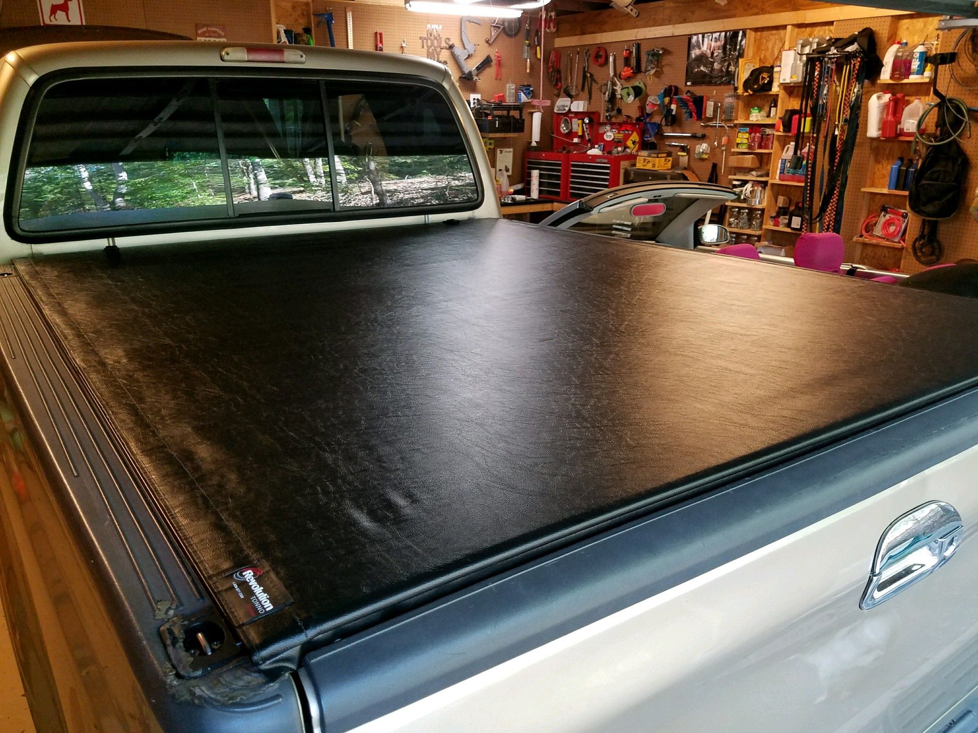

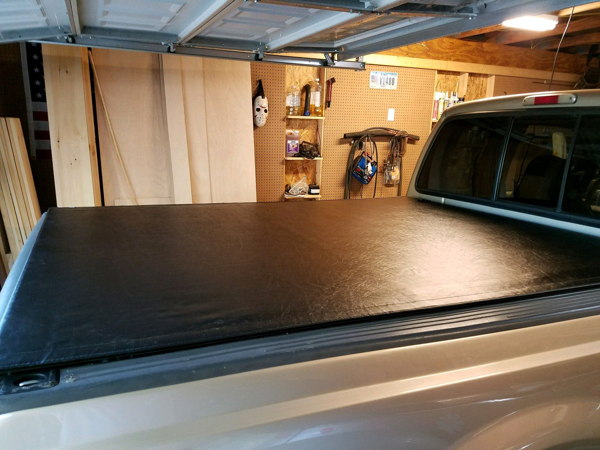

Well, the steering gear leaking was a bit of a kick in the teeth because I was looking forward to getting the truck running today with the new starter, batteries and alternator. But, I will have to wait until another steering gear is installed.
Although, I manged to get the bed cover installed and I am impressed. It is a soft top, but is very tight across and have several supports across the bed. It rolls up to where it sits about about 6" behind the cab and just above the base of the rear window.
What brand bed cover is this? I've been really looking hard at toneau covers for a while but there are SO many different brands. I'm pretty sure I want a soft cover so that I can just roll it up and have the whole bed for hauling. The way you described this one rolling up is exactly what I'm looking for.
Extang Revolution which I purchased from Etrailer because they had the best deal around on it. I really am quite impressed with the cover. It is better than what I thought it was going to be. There are quite a few company made videos about the cover, and they are accurate in their description.

I wanted a hard cover that rolls up, but carrying the 45 gallons of fuel in the bed threw that out the window. I went out and looked at the cover I bought again, I think it is the ******* child of a hard rolling cover and a soft velcro cover.
It is held in place at 8 different points along the rails that require no action to hold it or release it. It is really quite sturdy for a soft cover and the material is very thick. The bars from side to side give it a lot of stability. There is no velcro or securing it to the sides, you just snap it in at the back and go. It rolls up in a couple of seconds really easily and has buckles to hold it in place if you like in a roll about 8" in diameter.
I like it a lot, and think it was the best choice of covers for my application.

Mark, not sure what your question is asking, but I will see if I can answer it.
We have been running the truck without the cover and a tank in the bed for 2.5 years no, maybe more I guess. It is an aluminum ATTA45RBR tank and is very sturdy and well built. It has been rained on and what not during this time. All of the critical parts are covered by an aluminum cover and it holds up well.
The roll up cover has multiple layers of weather stripping on the front, then the sides are sealed with a non-spongy type of foam and clamps. The back sits just on and behind the tailgate when closed. I suspect that most water will hit the top of the tailgate and roll down the outside/back. Although, some water may get into the bed by running down the tailgate on the inside. The gap at the bottom of the tailgate and bed though will not allow water to get into the bed.
They put a lot of thought in how to seal this thing up and make is quick and easy on customers.
