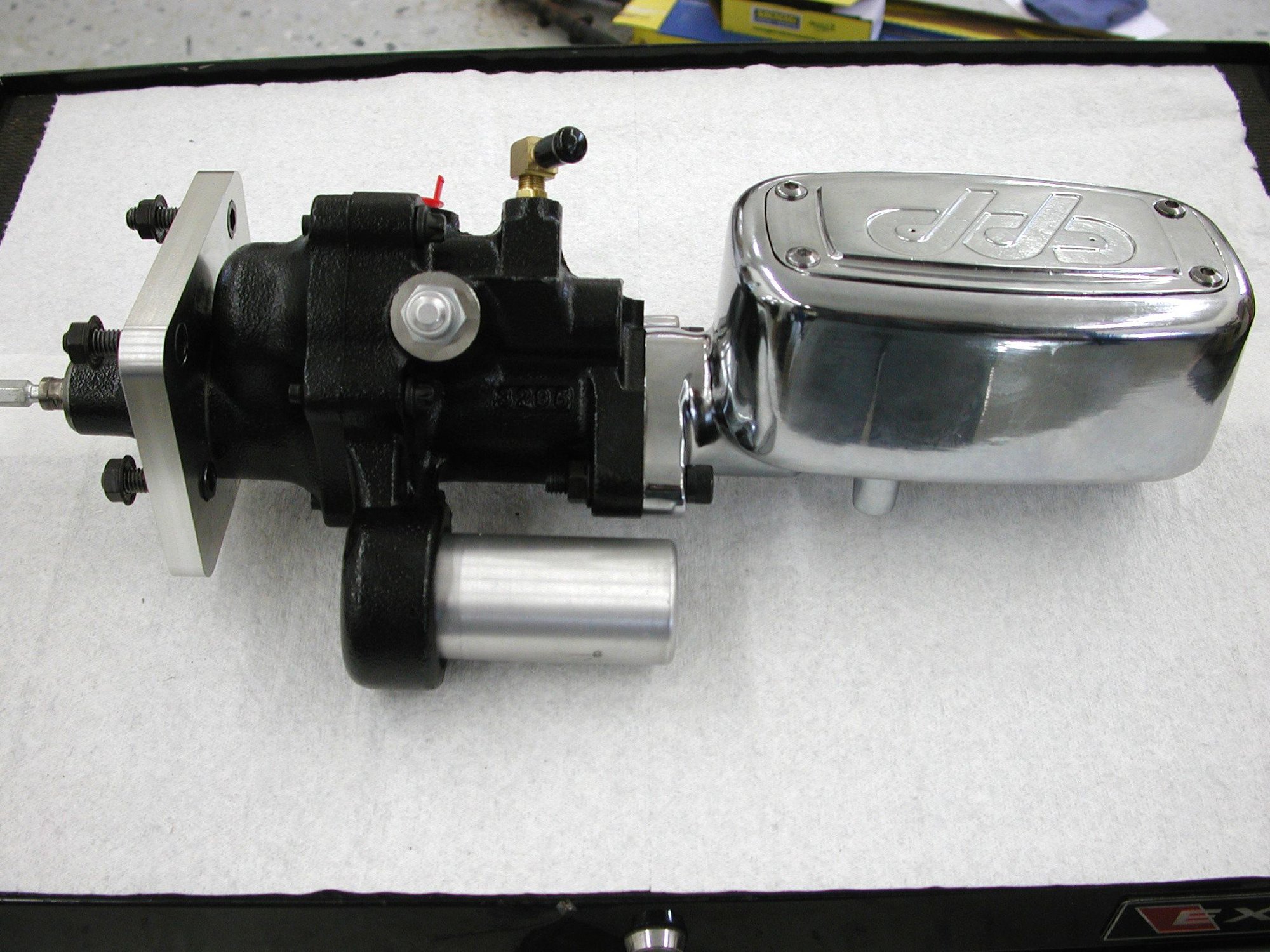

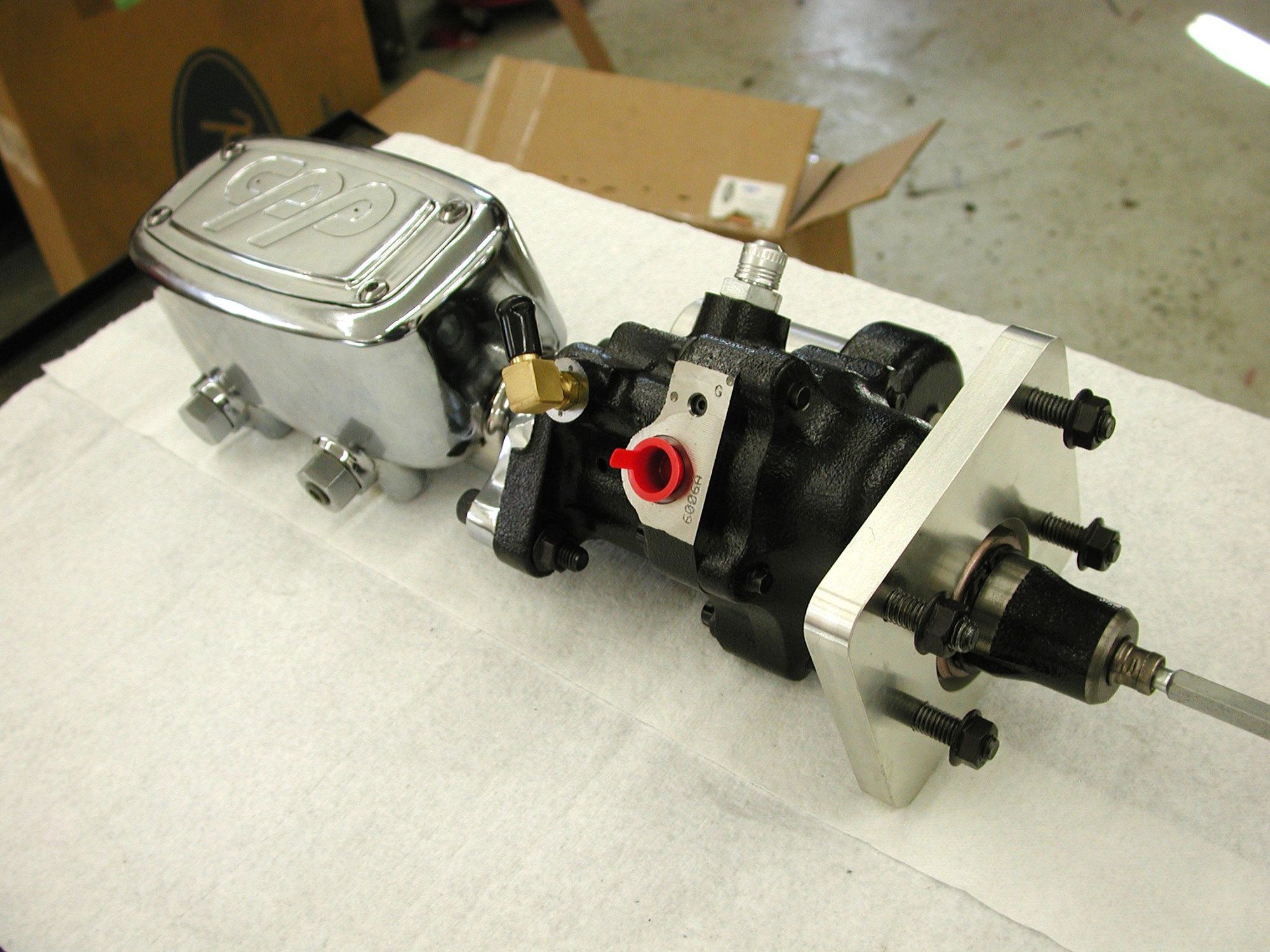

Was just going through the stash of parts and found something I'd forgotten. So, the first question is, wonder if this will fits Dad's truck? (Sorry, Vernon.) Second, if not, forget upgrading Big Blue to a later model system.

Do you have the Saginaw with dual return, and the SuperDuty brake pedal to go with that?
You do know the pushrod attachment point is different for hydroboost.

No, and no - in that order. But, I have a Saginaw I rebuilt, so may be able to change out the rear of it for the one with the extra fittings. Or, find another with them. However, I do have the bracket for the Saginaw.
So, a different pedal is needed? Tell me more.......

You're going to have to look in some of the hydroboost threads for side by side comparison shots.
iirc the pivot point is about an inch higher.

Ok, will do. But moving the pivot point up means hydroboost has a LOT more boost.

I found this thread...
https://www.ford-trucks.com/forums/1...-brakes-6.html
It seems to have engineering numbers for auto and manual hydroboost brake pedals.

My 1978 Oldsmobile and 1980 Bonneville both had HydroBoost units, they were plumbed, pump to booster then to steering with return hoses from each to the back of the pump. Look for a pump can for a GM 5.7L diesel it will have the dual return nipples. You might also want to check the pump specs for HydroBoost, I seem to recall it was higher than regular PS spec.

Hmm, I wonder if the one from the Olds would work?
