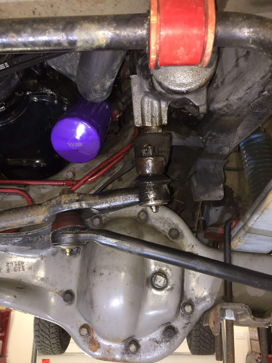

I'm chasing lubricant leaks and found this today. (And, I'm checking to see what is shown in the metadata for pics on FTE.) This pic has been sent from my phone to my PC and then posted to FTE. And, I apologize up front for the size of the file, but I want to be sure everything is in it.)

How much does that truck sit down on it's suspension?
It looks like a drop pitman arm would improve the steering geometry.

It doesn't sit down very much. Where's the best place to measure? I'll check when I drop it down?

I measured 9" between the tops of the front tires when on the lift and 6" when down.

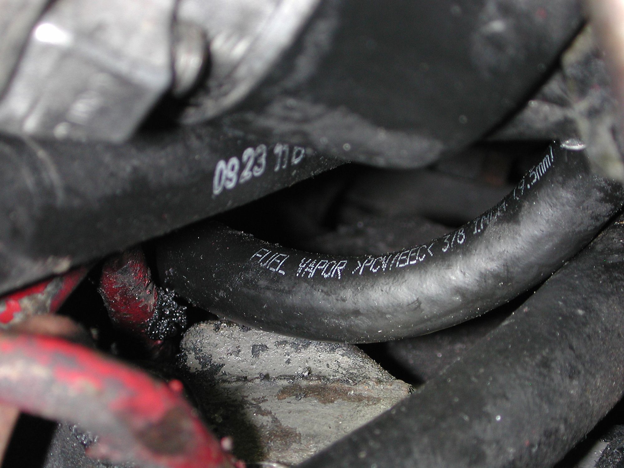

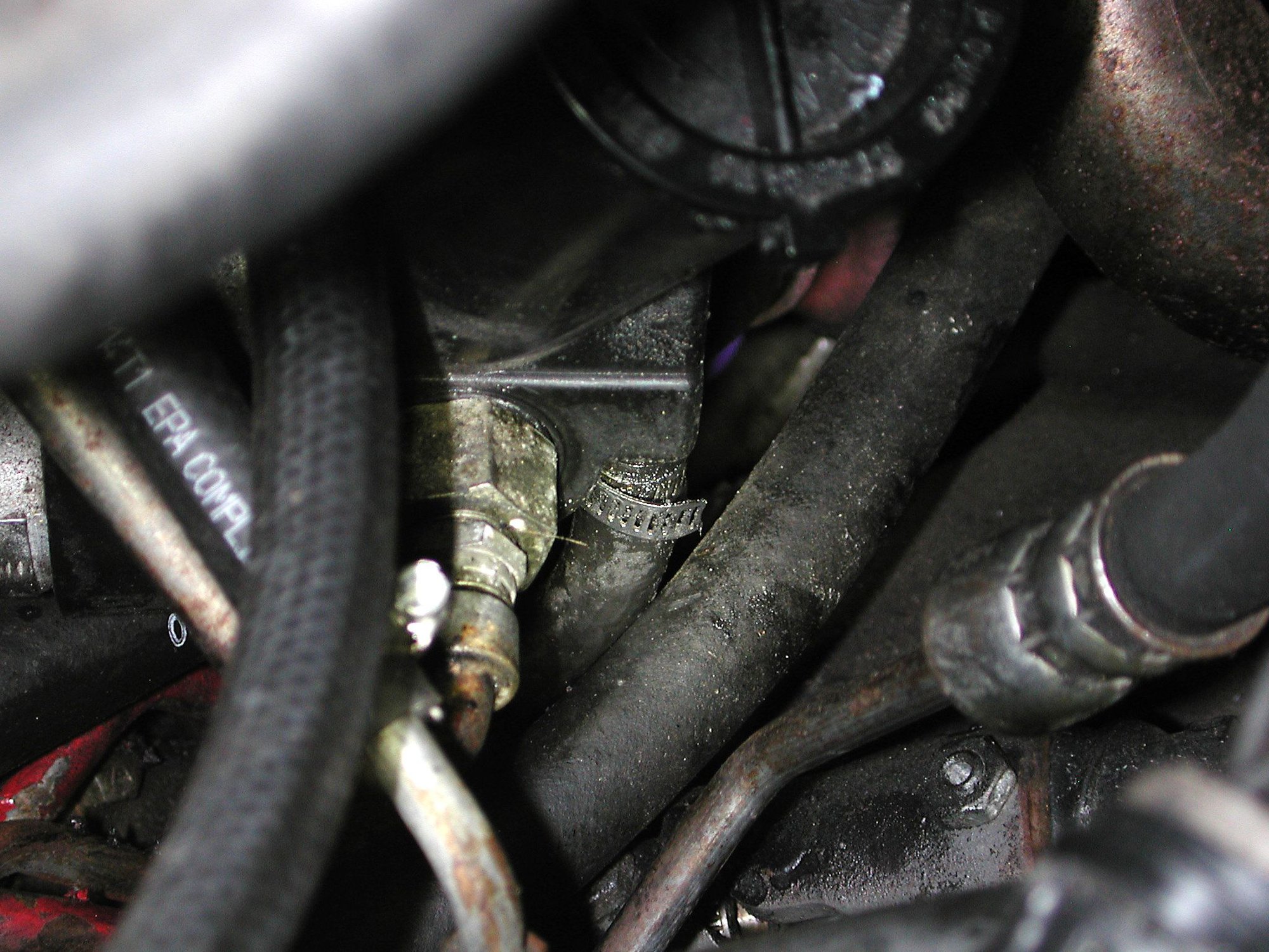

I may have found both a leak as well as a problem. First, this clamp on the power steering pump was not tight, and the area around it was really wet and grungy. Plus, the power steering pump is low on fluid.
Then I followed the hose a bit and found that they used a fuel hose to connect up the return side of the power steering. I have some 3/8" transmission oil cooler hose so guess I should swap it.

I got the hose on the power steering pump replaced today. And after lots of cleaning and two cans of brake cleaner I think I can probably figure out where the leaks are coming from.
