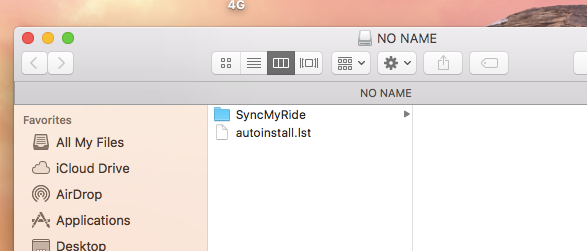

Originally Posted by ambama04
Ok so in the folder syncmyride folder I need to unzip those files and keep them in the folder and then get rid of the zipped files out of the folder. Sorry not a computer guy
Yes when you open the Flash Drive there should be 2 items.
