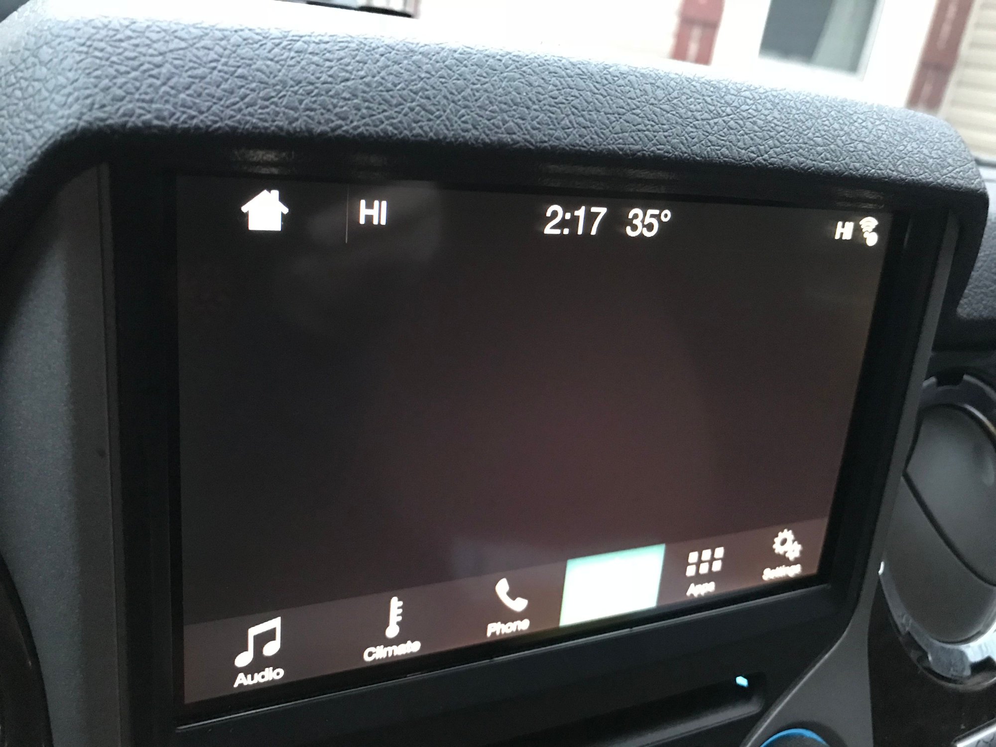

Guys does anyone have the 2017 original sync 3 with NAV 2.0 install files?
I upgraded mine to 2.3 from the official myford website, using usb stick, and vin number and it showed 2.3 available so i upgraded, now i have blank screen on navigation. Still have the button on bottom of screen but when i click it no maps. Already tried master reset, power button and seek up reset, re-installing same, installing unoffcial 3.0 upgrade, still have black screen, was hoping to be able to go back to 2.0. I did the upgrade cause i was under the impression that 2.0 will not work with carplay.
Any help appreciated, thanks.

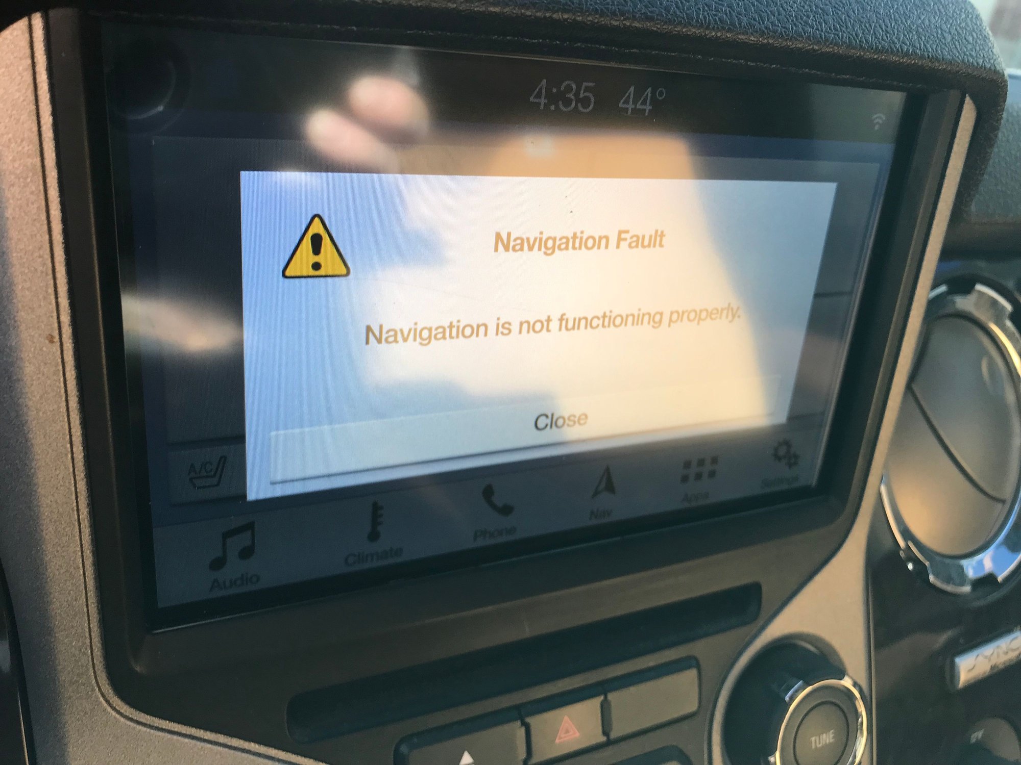

today it gave me this message, anyone ever come a
cross this after updating? does it just think the maps are missing?
