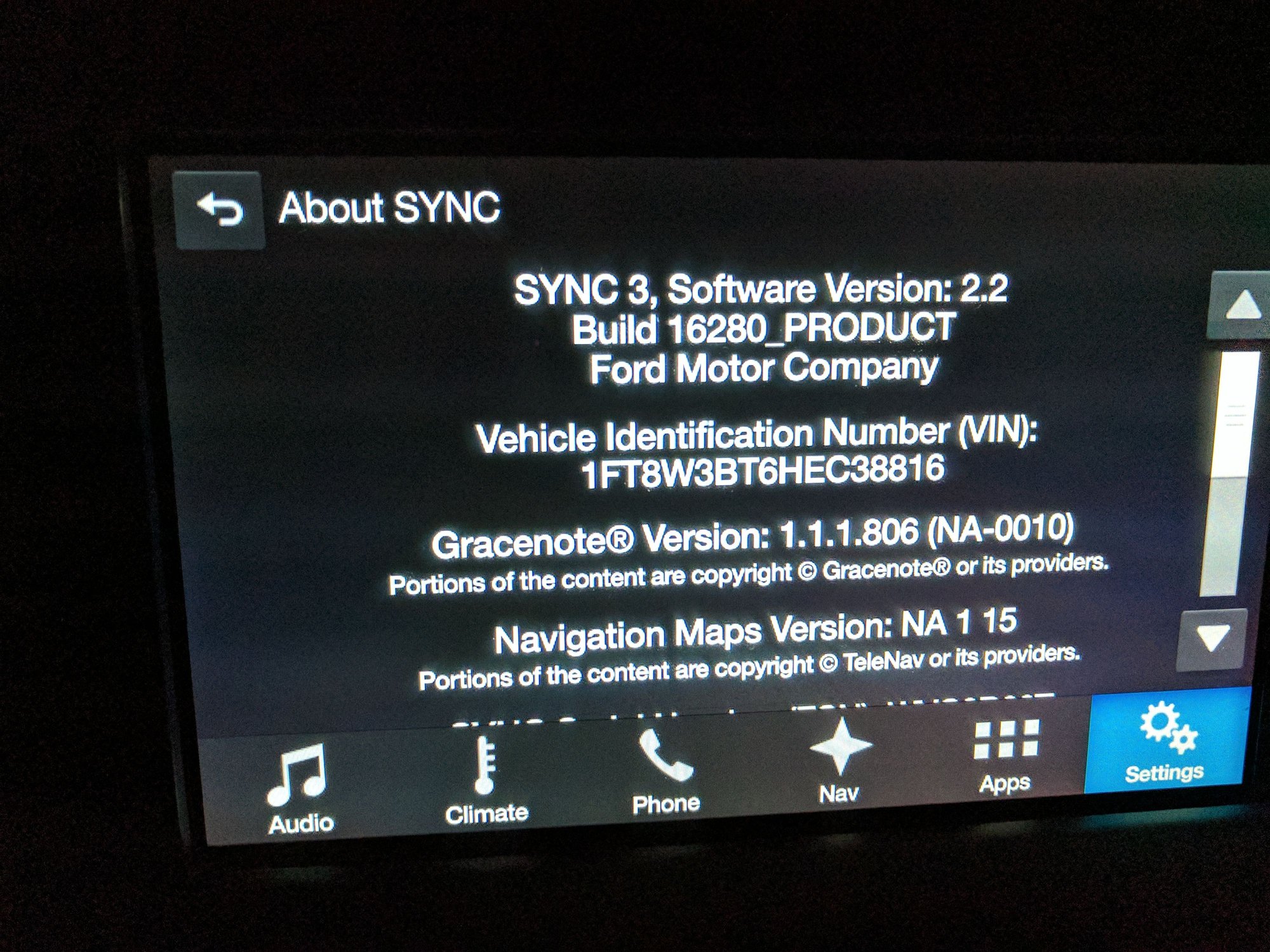

So the update worked. I went from v2.0 to v2.2.
I pulled up the maps and told it to update traffic. After about 2 minutes the maps updated with green lines on the major roads. No red at this hour but I will be able to test that on my commute home tomorrow.

[QUOTE=gpf2ez;17057961]So the update worked. I went from v2.0 to v2.2.
Are you stating the same upgrade file v1-v2.2 upgraded your v2 system? Of is there another file for v2 systems to upgrade to v2.2?
I just want to make sure to get the correct file for the upgrade process. Thanks and congrats on finally having traffic data! I can't wait!

I used the file that BJ provided above:
http://www.mediafire.com/?z6ezkbps3o7zvx5
