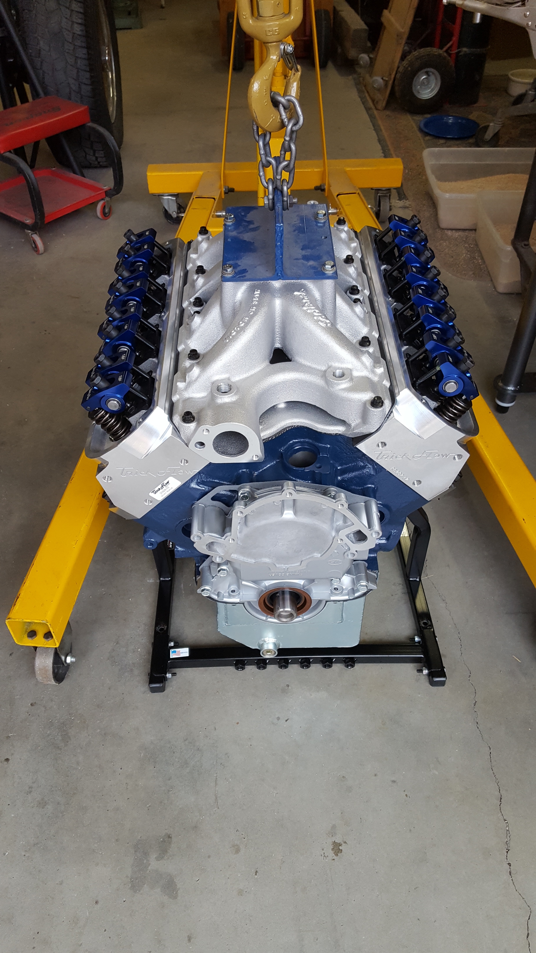

Originally Posted by Tim Young
I see a Victor JR manifold.
I thought I was chancing drivability by installing a Torker 2 on my 351W. (2500-6500 RPMS)
Victor JR is rated for operating between 3500 and 7500 rpm.
I am a little light on low end power, but if I lay into it a little too hard off the line it gets exciting real quick with the Detroit locker in the back. Yee haw!
Tell us how you do....
