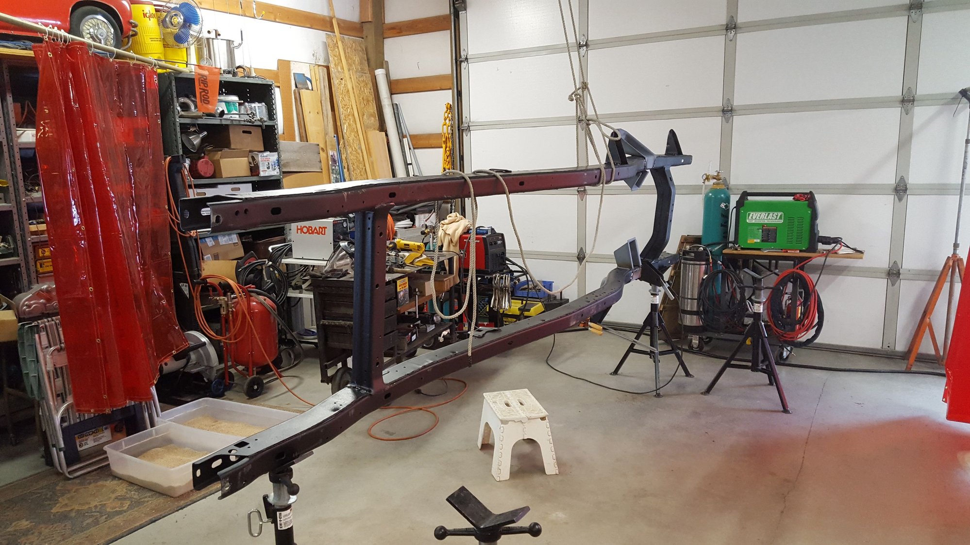

A few photos of the frame!
Change of plans after I stripped the frame. I was going to go full width axles and a cummins 4BT

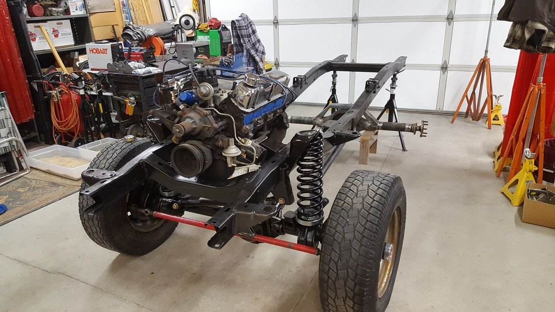

More photos

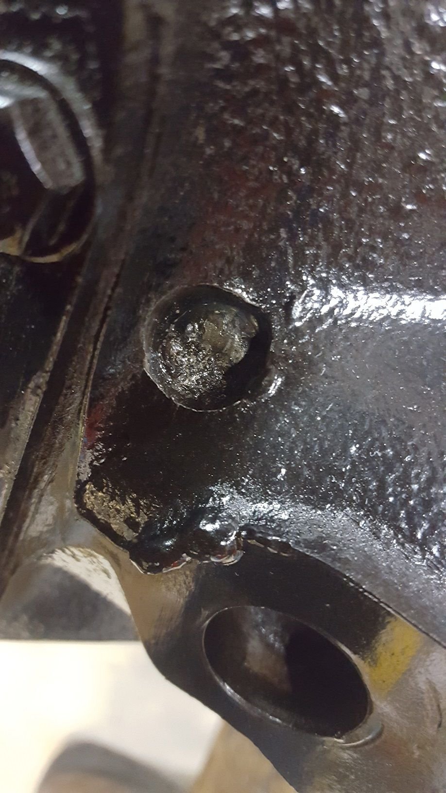

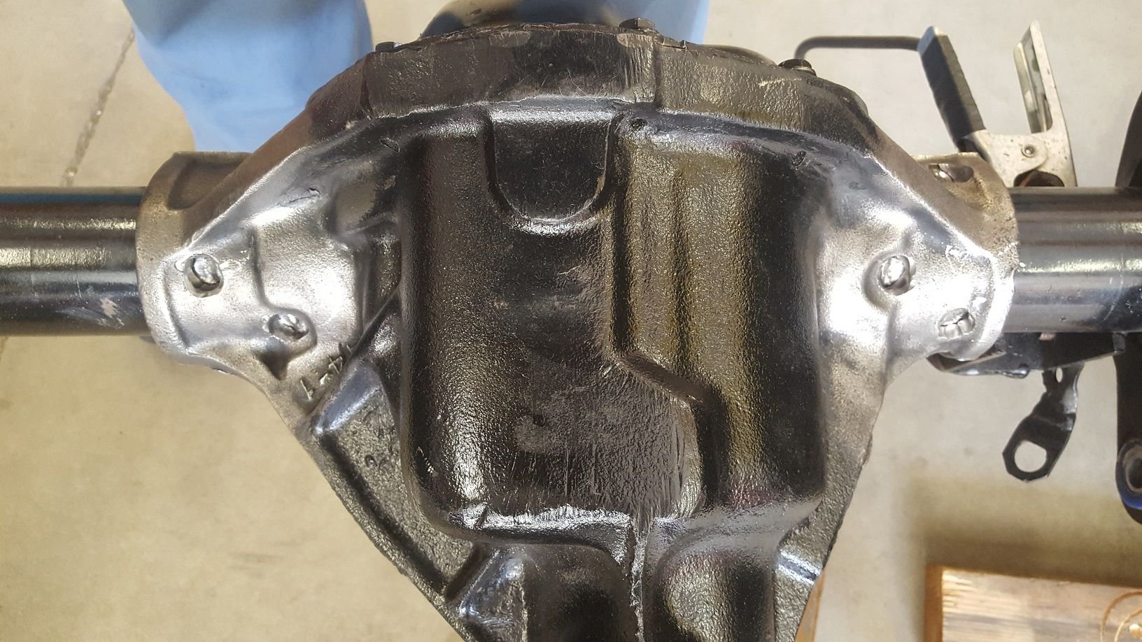

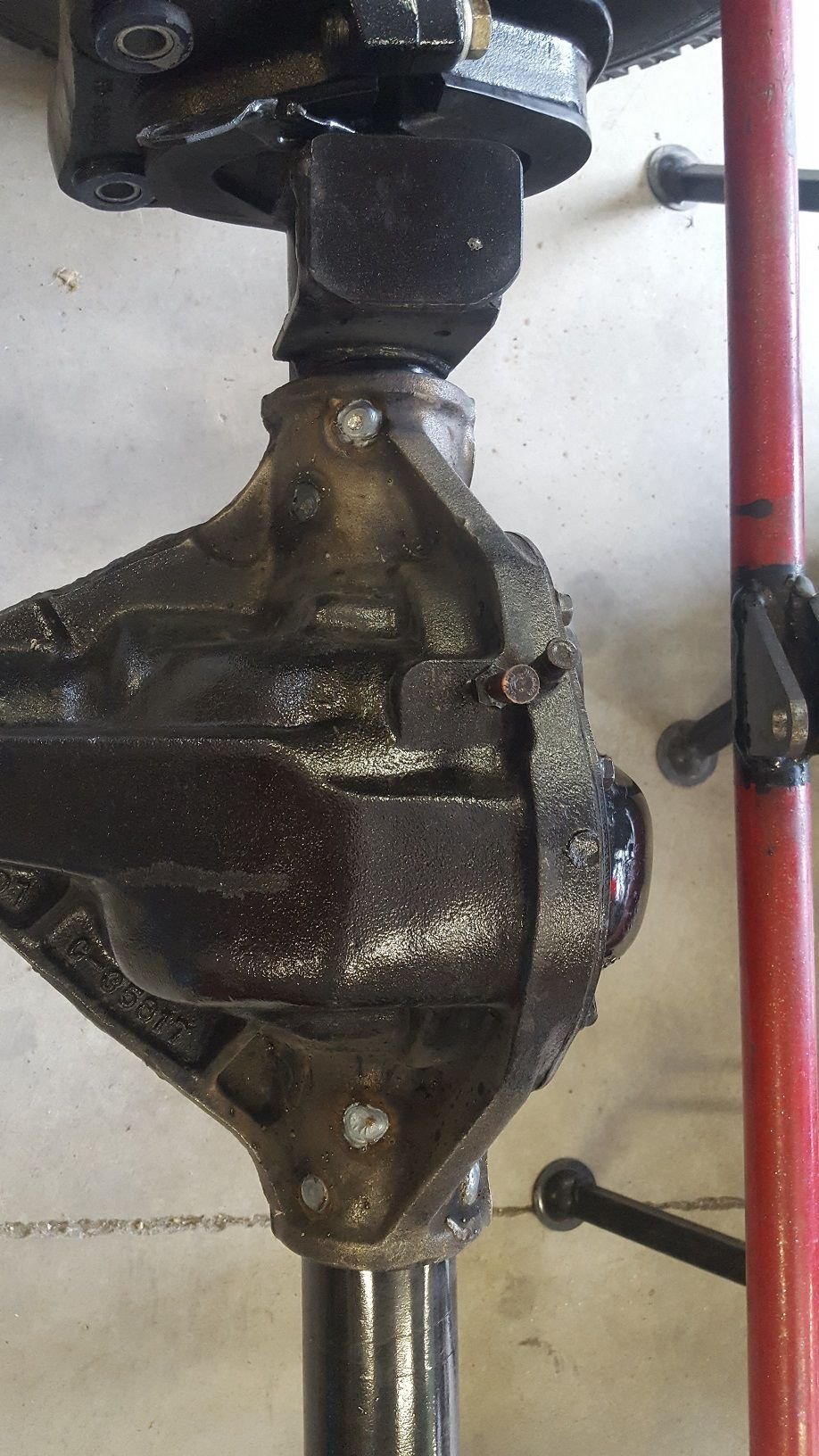

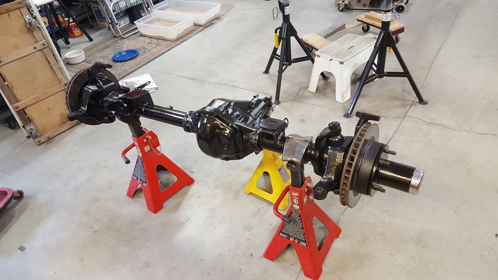

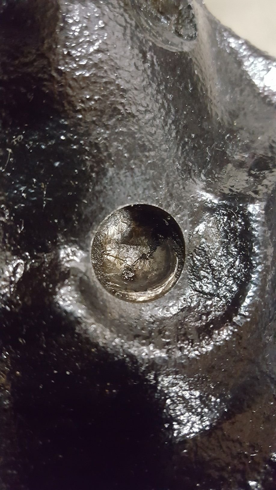

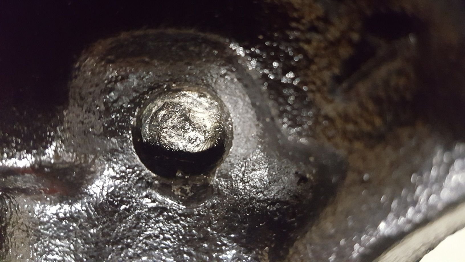

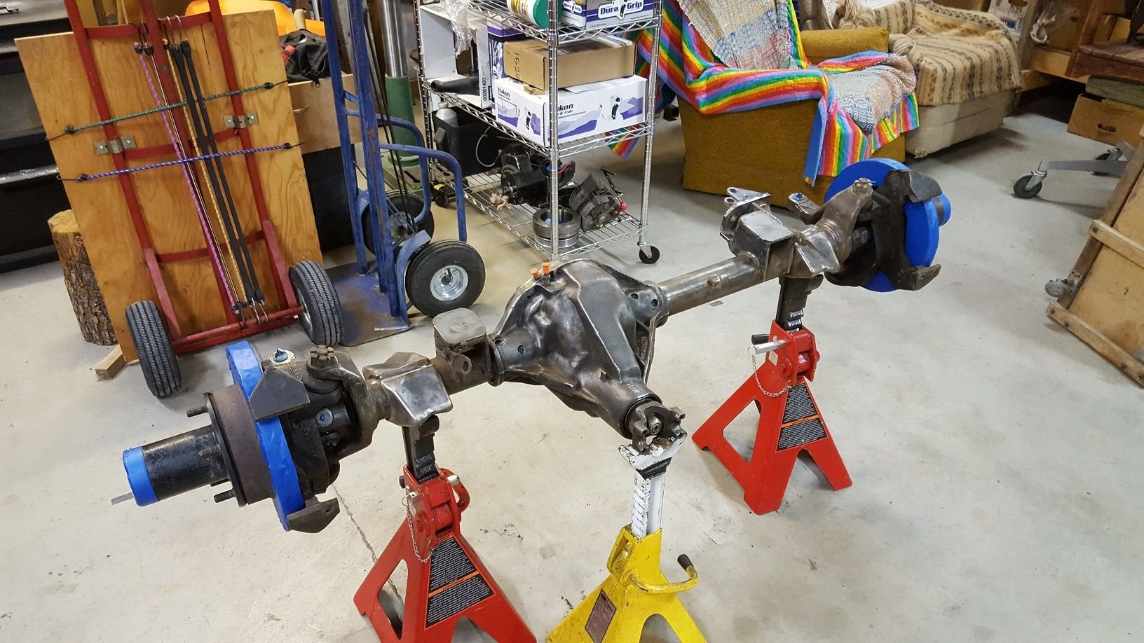

Front diff I bought from a friend. Dana 44 loaded with an ARB locker and CTM axle joints. After I had it cleaned up and painted I found the weld plugs leaking. After some research I decided to weld them up, it might be a temporary fix but I had to give it a try.

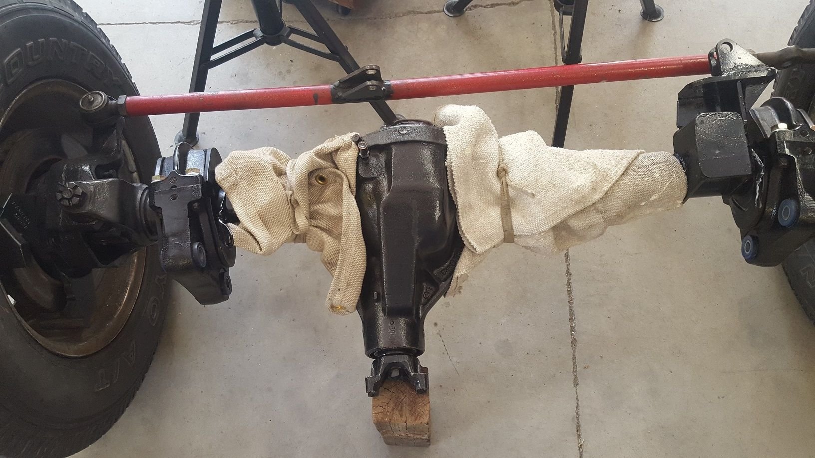

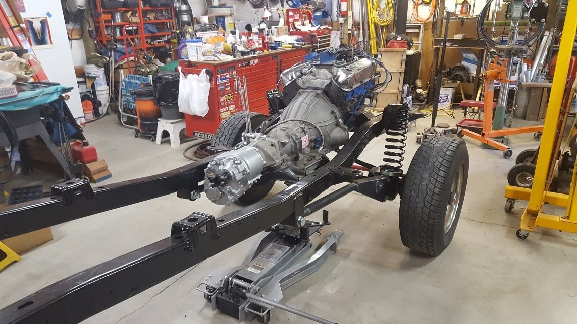

The front coming together, at least for the time being.
Twin Sticks from JB Custom Fabrication
