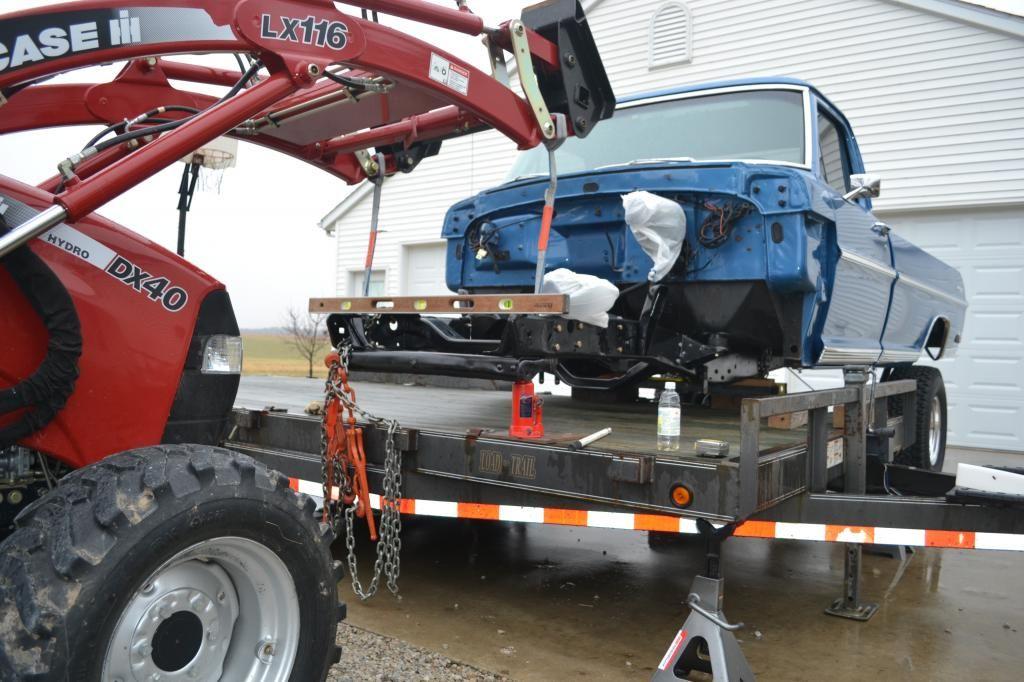

Do you have a flat bed trailer? Seems like placing the frame on a trailer with a combination of chains/binders/come-alongs could be used to accomplish this. I've never personally done that but it might be worth considering.
2x that's how I straightened my frame.
I put jack stands under all four corners of the trailer and chained the frame to the trailer.
The tractor was there just to make sure the truck didn't fall if a chain snapped.
Redneck frame rack.

Thanks guys, Just measuring it to the floor from the frame horns am still 1/16" out on the twist. I have the diamond dead on.
It's close enough to put the tub on it and built it from there.
