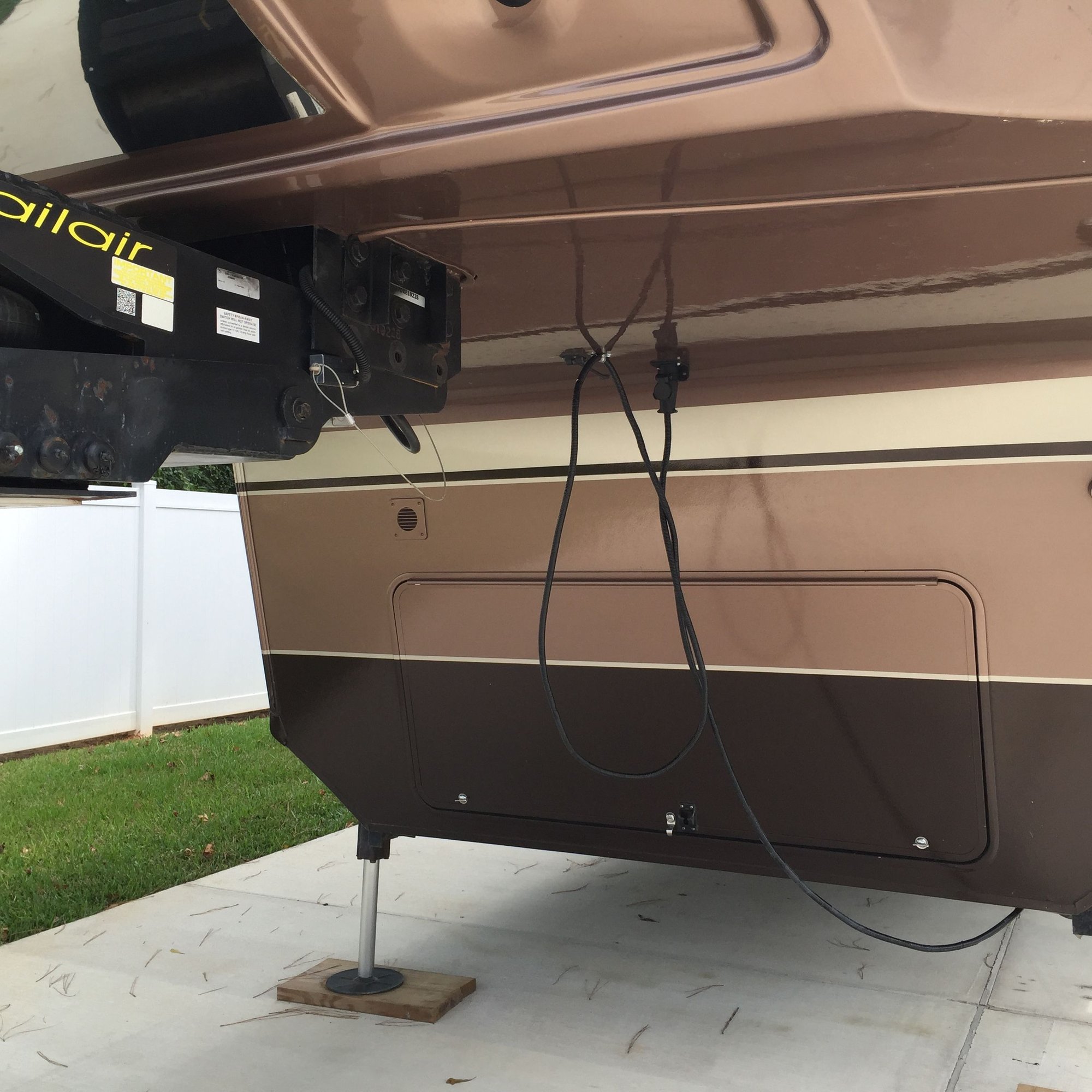

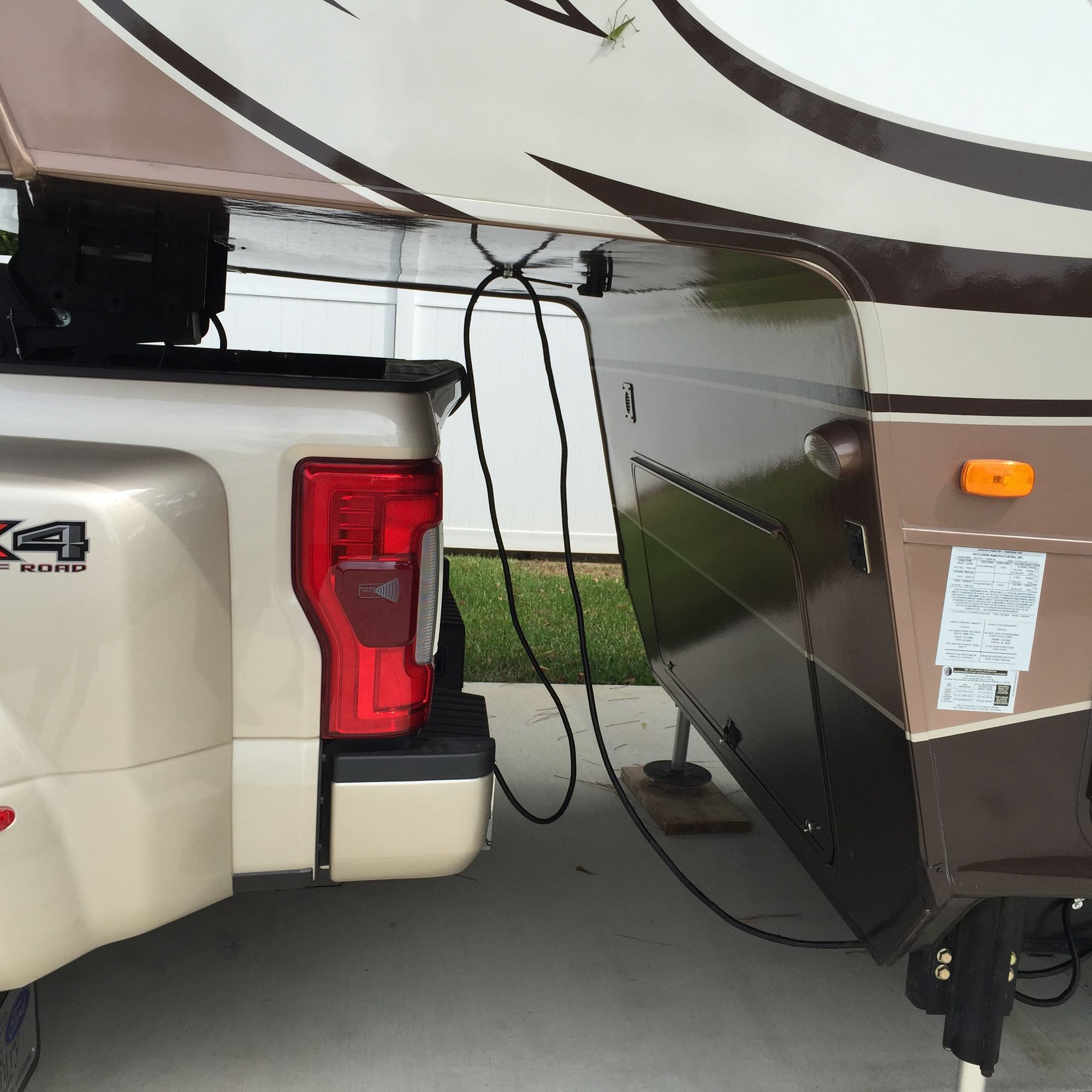

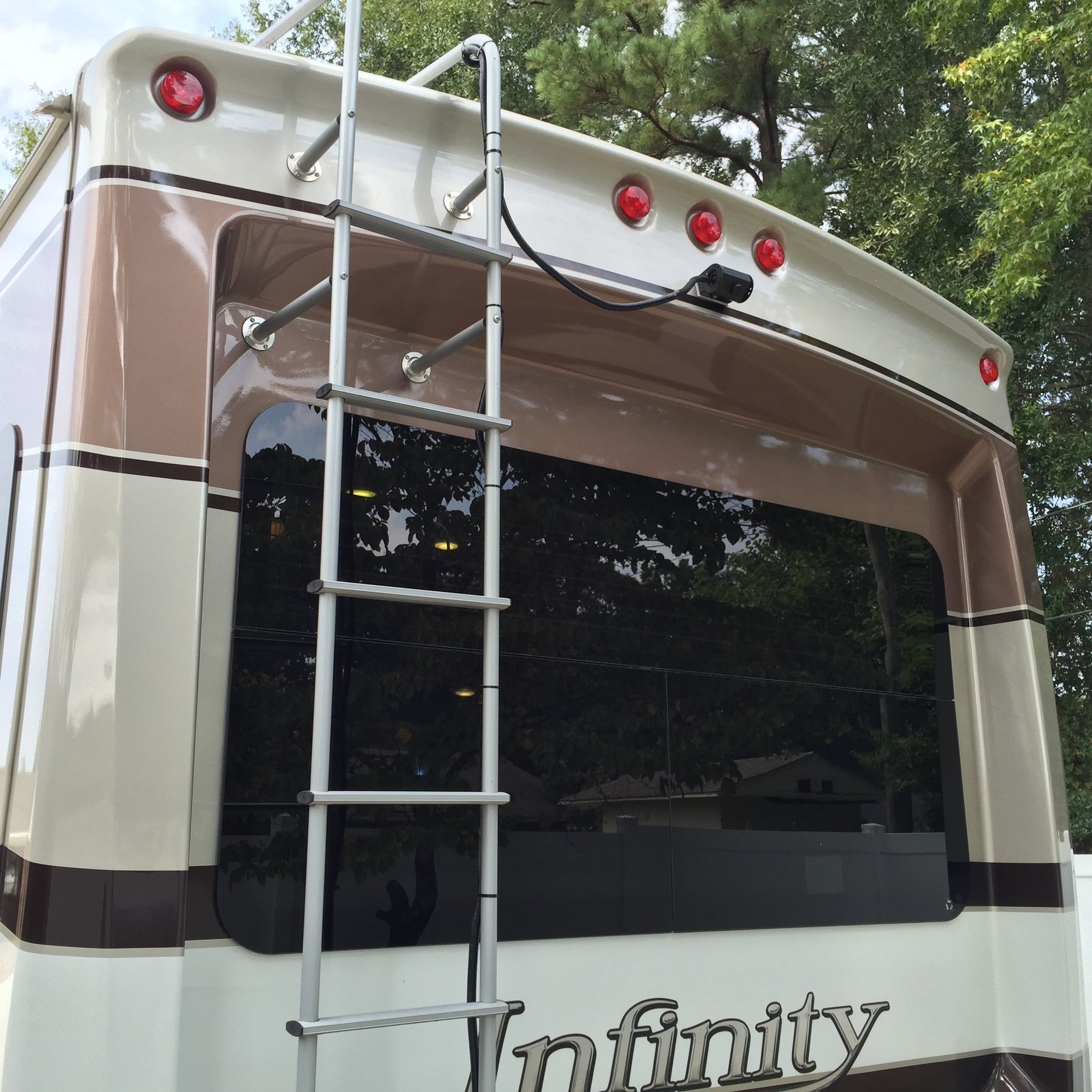

Just completed the install of the trailer camera. Dealer said it was a "dealer installed" option that they would install for me (included in sticker price), but I elected to do the work myself. Not a pretty install, but I didn't want to deal with trying to route the cable internally. The camera has a very clear picture (unlike the wireless camera a buddy has on his RV).
Installed the TPMS module for the hell of it, even though the sensors won't work with my wheels. Valve stem hole in my wheels is about 10mm and the sensors are about 15mm. Guess I'll go with an aftermarket system for that.
With cable plugged into "dock" port.

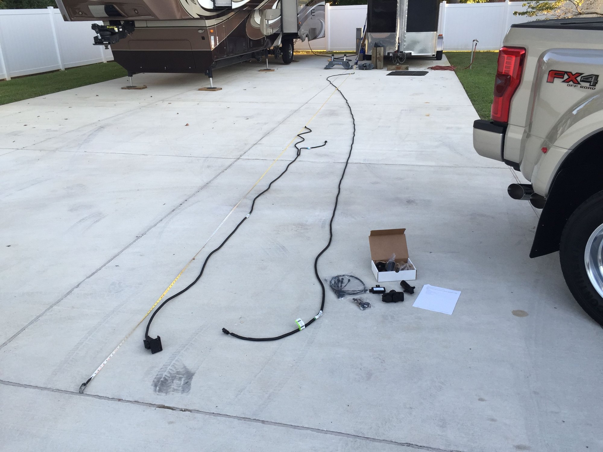

Originally Posted by EpicCowlick
How long was the length of cable to the camera? And how long is your trailer? Mine is 40 feet and I doubt the camera cable is long enough to do without extensions.
Hello EpicCowlick, The long cable was about 45' and the "Y" cord was about 16' & 19' (TPMS module & truck connector). Hopefully photos help show this.
My RV is about 42.5' nose to rear bumper. Had a little extra cable length for this since I went with the rear bumper connection. If I had tried to move the camera/TPMS jack to the bed it might have been an issue...
