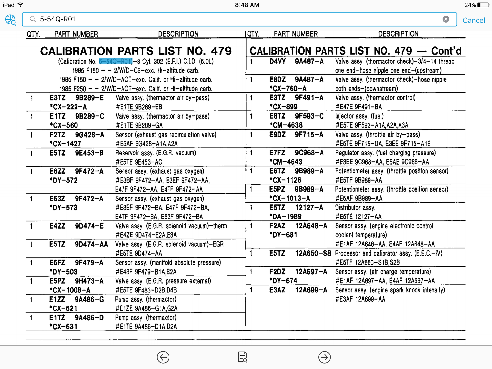

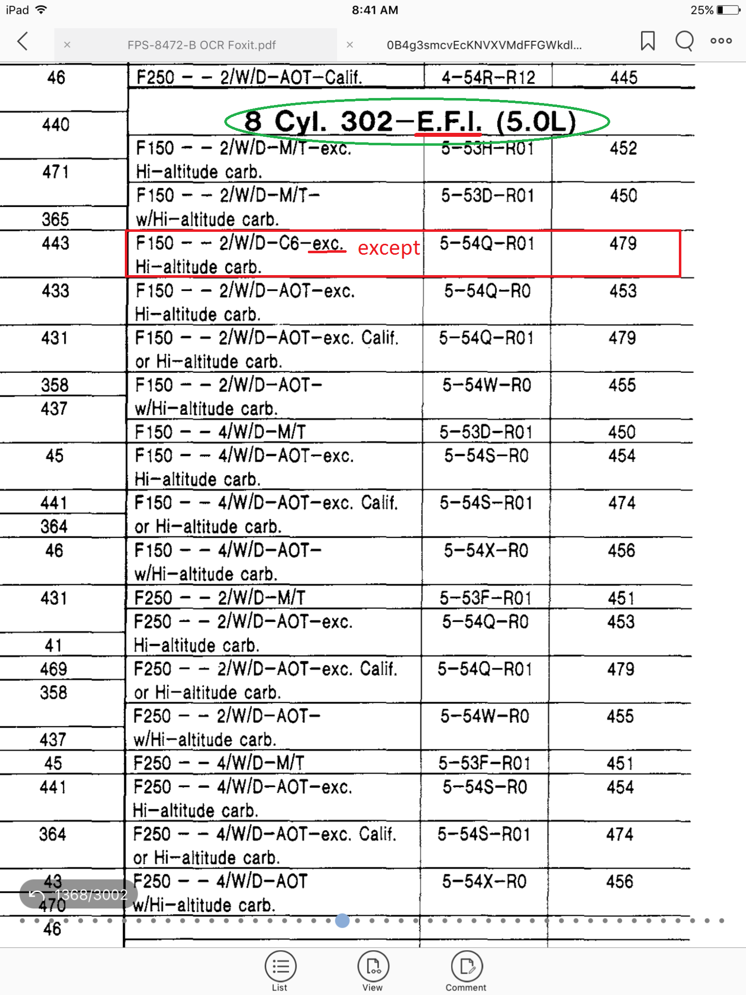

It looks like there's only one calibration code, 5-54Q-R01, and only one part list: 479. You can see that here as there's only one entry for a C6.
And, here's the parts list, with the processor listed as part number E5TZ 12A650-SB. But, it won't have that number on it. Instead, it will be marked either E5TF 12A650-S1B or -S2B. And, by the way, the other parts specific to that calibration code are in that list.
RockAuto has the E5TZ12A650SB with that number on it. Whew! Thanks a bunch!!!

Steve - I'm sorry for your difficulties. And, for being short with you. I sure you don't want special treatment, but we might be more understanding if you would tell us of your problems. I toyed with circling the various codes before I posted the pics, but my theory is that I shouldn't have to do all of the work. However, had I known I would have circled them so you could see where the info was coming from.
