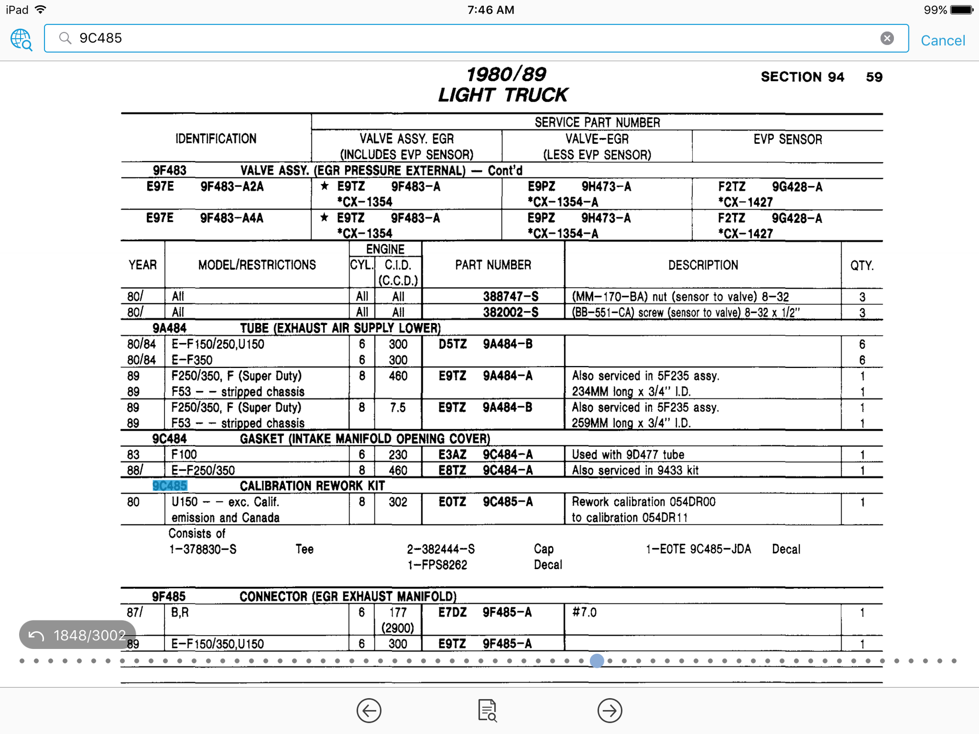

The ECM, according to the manufactures sticker (also indicated are the timing procedures) states the ECM# is E5AE-9C485-CRD. Can that number be interchanged with other ECM numbers? If so, anyone know what compatible numbers might be?

That's not an ECM #. The catalog says that's a Calibration Rework Kit, as shown below. You can see what ECM #'s look like in this post: https://www.ford-trucks.com/forums/1...l#post16390352. And if you can find that number or the calibration code, which also shows in that thread, I can find the ECM #. The calibration code is discussed two posts after the one in the link.
