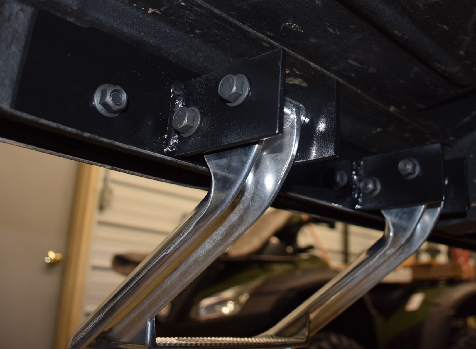

Gavin, the bolt holding the bracket to the frame...is there enough thread? It should go past the nut and it appears to stop just short. I know that is a huge issue in my structural design world and we need to be past the bolt with out threads or it's just not allowed. I can see vibration becoming an issue down the road. The brackets look fantastic and the step better than new!

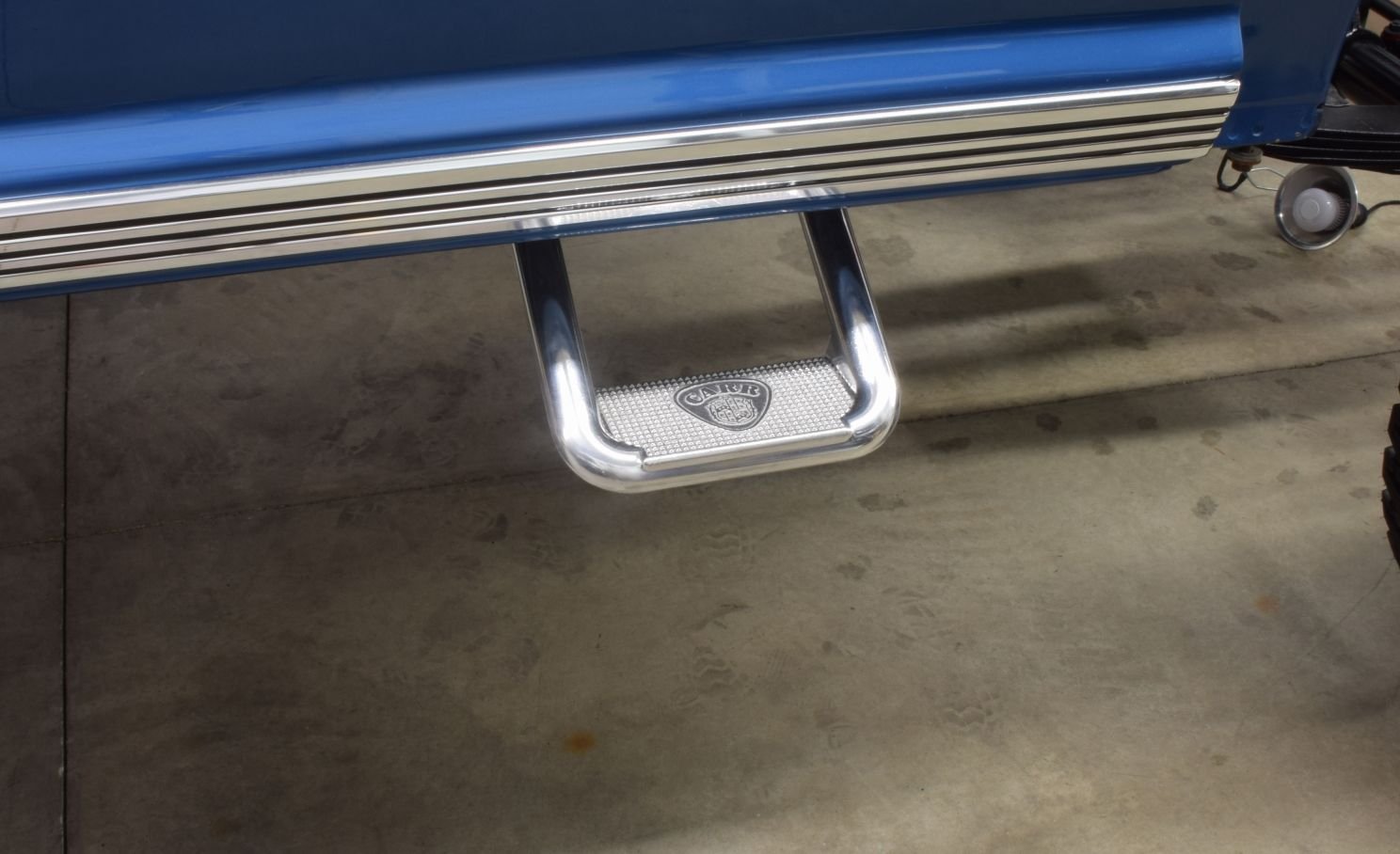

Where did you pick up the steps, Gavin, those are nice!
Going by the name on them....
Steps
I gotta order longer bolts and more nuts. When I did a test fit of the bracket I use standard size nuts and the bolt length was fine. The shoulder nuts are a one time use distorted thread lock nut......and they are lot taller. One step forward....

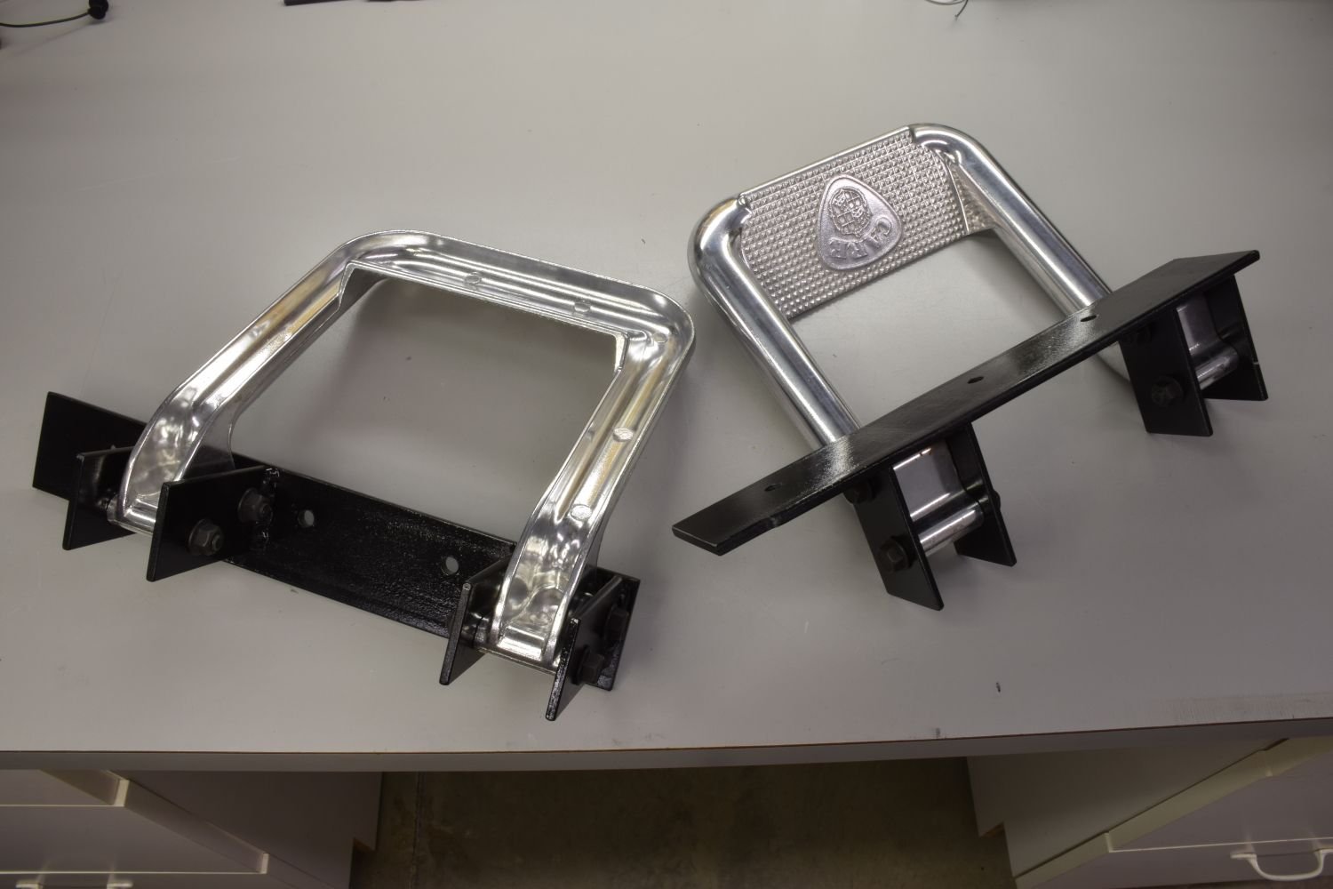

Thanks Pat, I've seen that step on quite a few highboys. The set I got was for dents and the mounting brackets they give you are cheese, that's why I made my own brackets.
