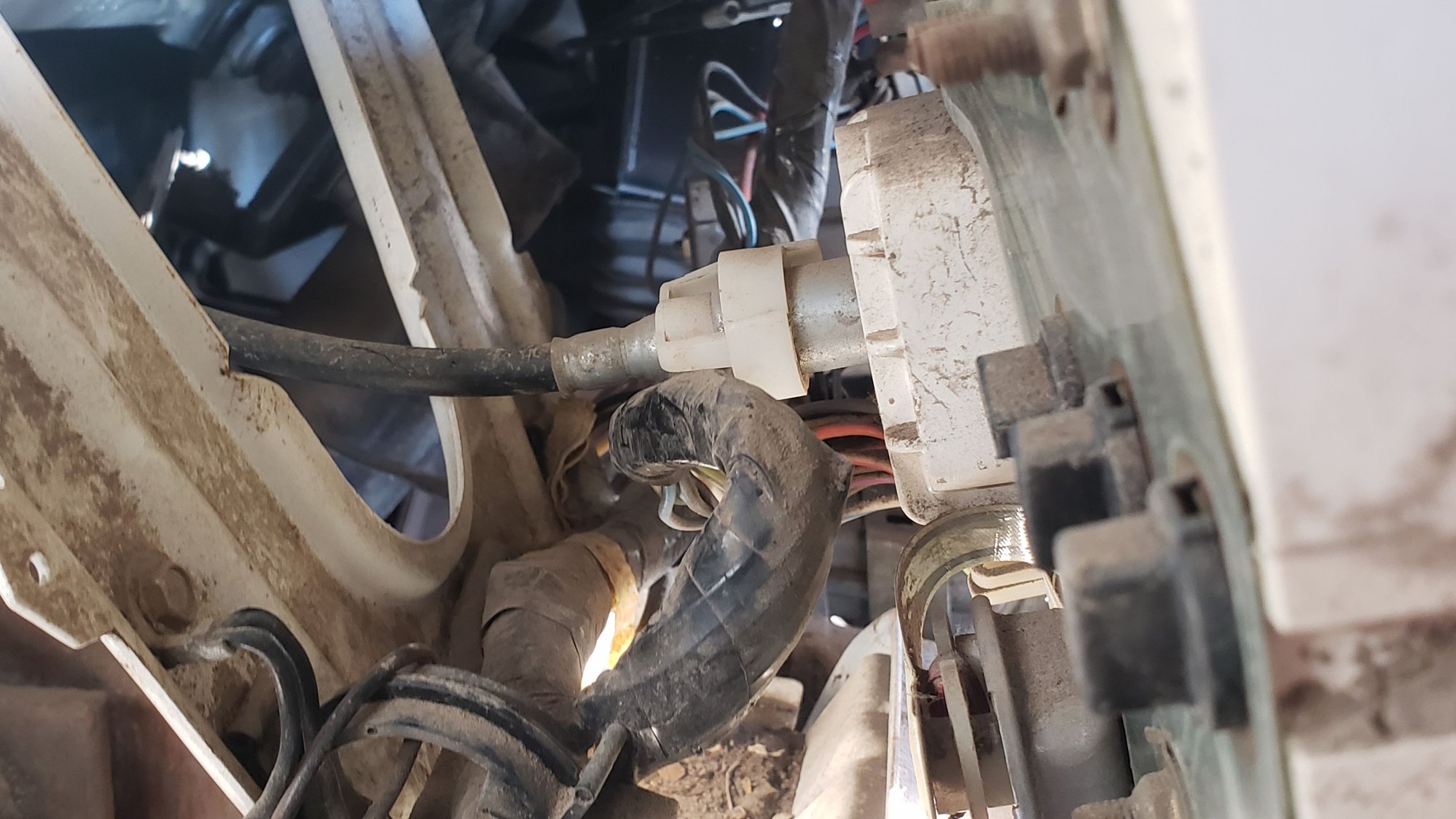

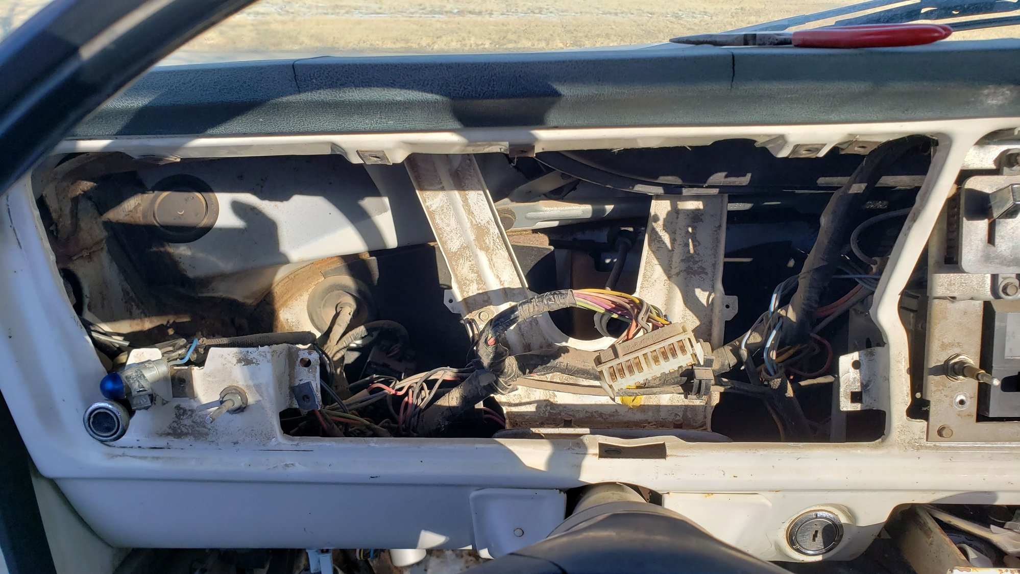

so working on Grumpy again today.. Parked for the winter and I unhooked the battery and I took out the dash cluster. It was acting up this year. ONE of the four gauges would work and they all took turns doing it lol! So I figured I should give it a shot and see what I can do. Well I can tell someone has been in here before. There was screws missing holding the dash bezel on, there is bulbs missing out of the back of the cluster (yes I know you CAN change them without taking the dash out). I also know someone has been in the bezel itself as some of the 1/4 inch screws holding the 2 halves together are also MIA...
Nice and dirty back there. Guess I couldn't expect less with the windshield being shot out for several years.
The darn clip! Protip! to remove the speedometer cable from the instrument cluster, push that big tab on the far side in, towards the cable and it will wiggle off. It took some research to figure that out!
picture from back side.
Looks so weird with the cluster out! Also the Headlight / Wiper light for the dash just unclips. Mine will need replaced. it has exploded..
