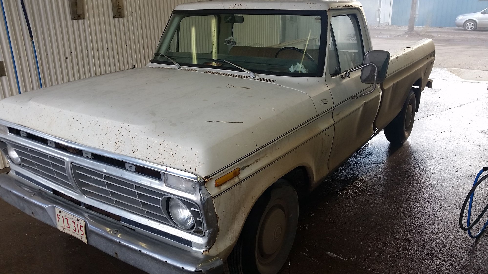

So I cleaned him up the other day! Grumpy was getting pretty muddy!

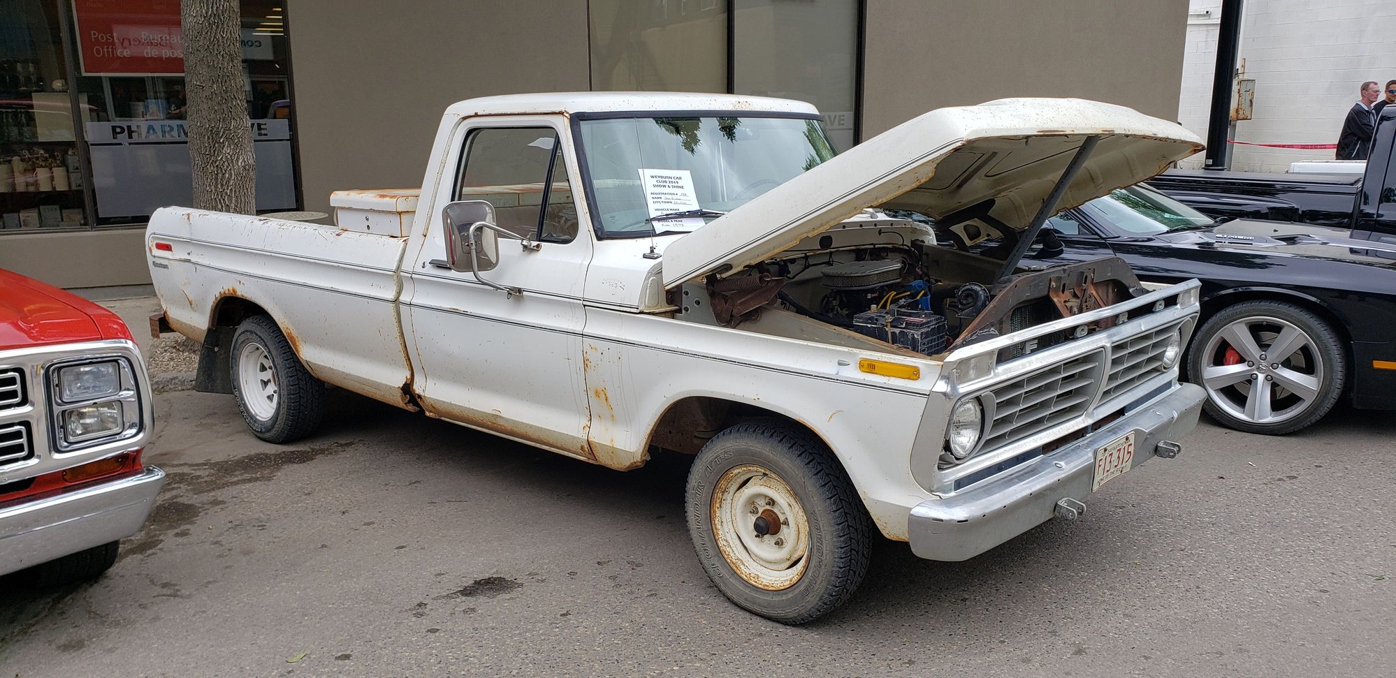

He was doing so well I decided to take him to a car show the next weekend! He did really well. I had put about 120km on him at highway speeds and NO OIL or dipstick being pushed out! And a couple times I put it to the floor to make sure!
