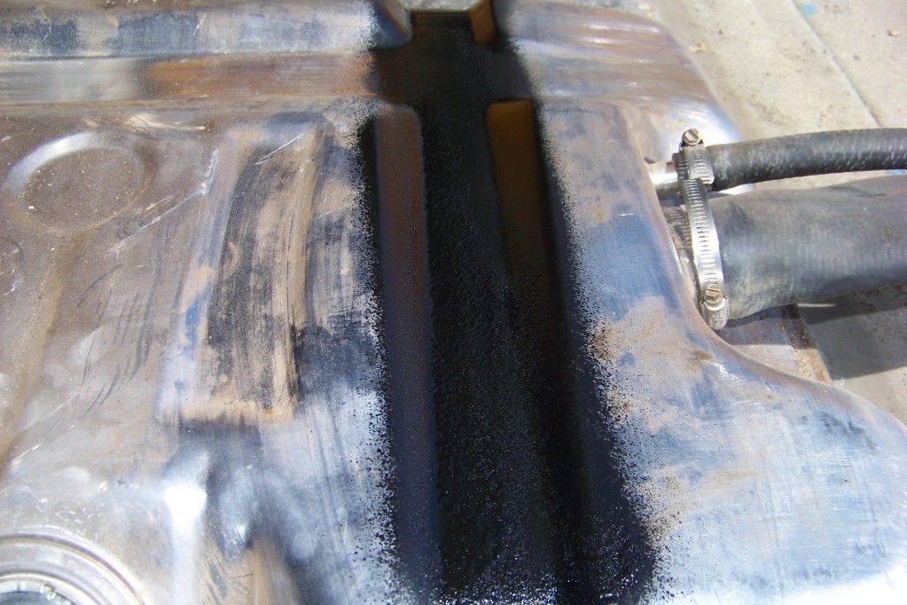

So then in the spring when I got home, I decided to clean up the box and use some POR-15 on it.
These get eaten up fast when you're on a mission to make everything rust-free.
From this:
To this:

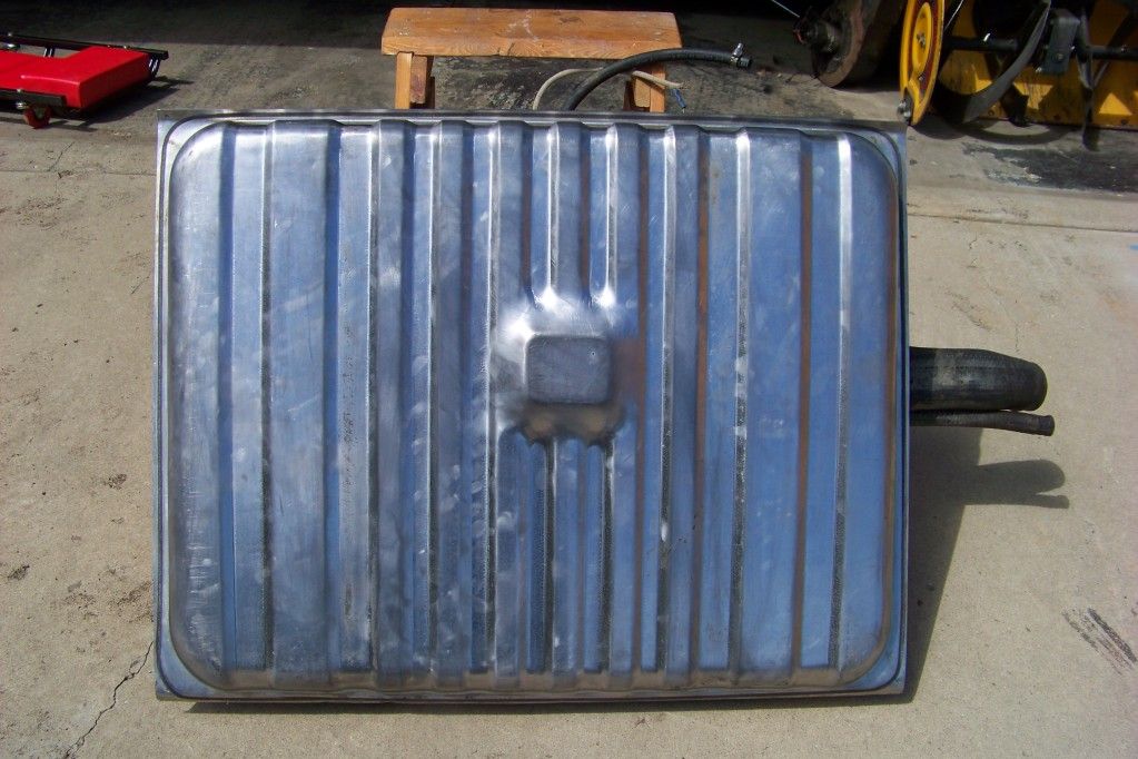

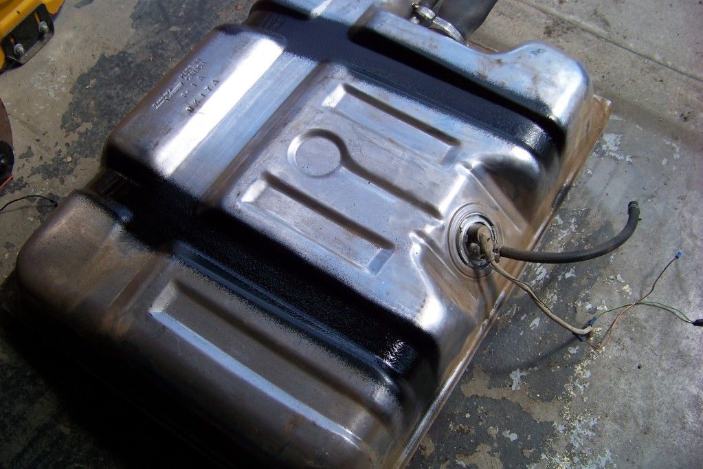

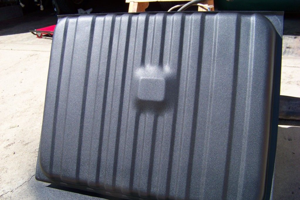

After I had my carb rebuilt, my brand new 19 gallon tank and sending unit came in. Installed those and grabbed a new fuel filter as well as fuel pump. Fuel system fixed!

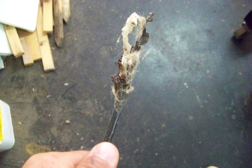

One thought that comes to mind, it looks like there is a cork gasket at the carb base and I don`t know if it`s going to be a problem or not but it`s usually a hard material gasket.
Glad you noticed my work!
That's a gasket that i created myself because the stock gasket was in VERY rough shape. I know it's not the same thickness or density as the original, but it works.
I'm planning on trimming it so that the cork doesn't show so much, but it's one of the many things "to-do"

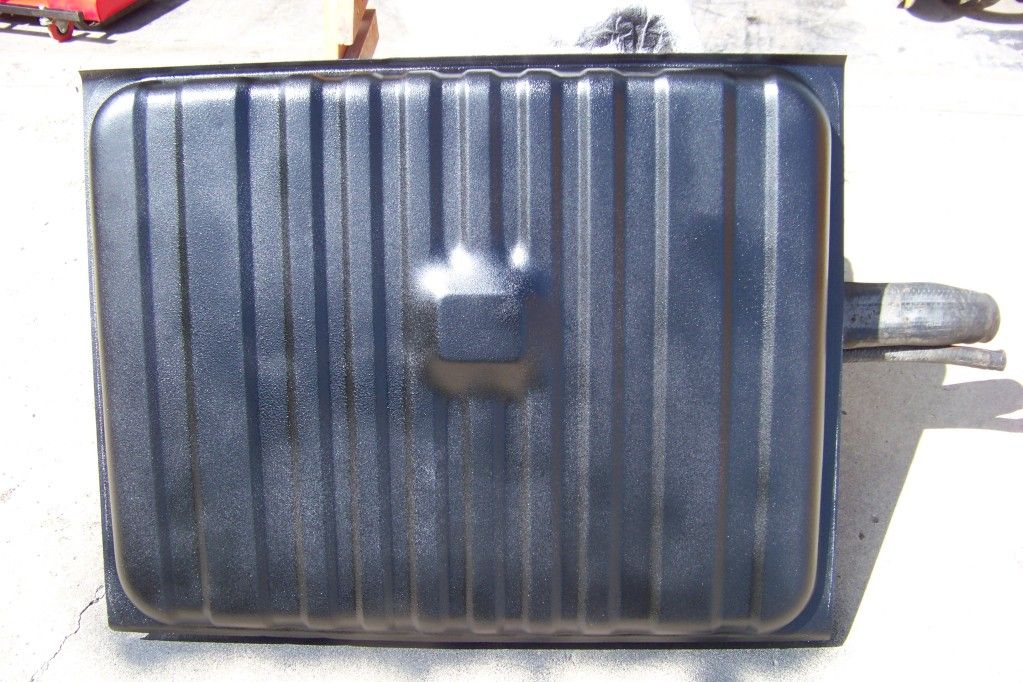

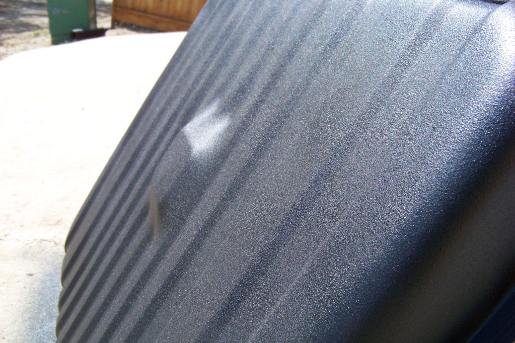

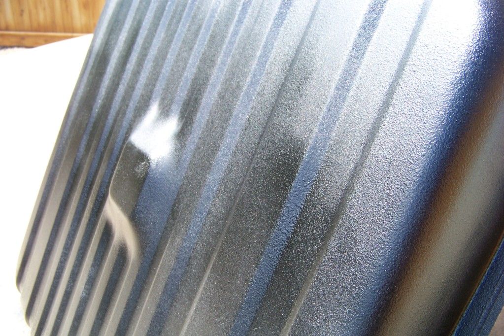

More progress today.
Got my tank taken off again and sprayed with Gravel Guard. A friend suggested doing it and I loved the idea.
The can of gravel guard only cost me $7, so it's a steal of a deal to have a very textured and protected gas tank. It should be protected from all rocks and gravel that could potentially ding the tank and puncture it.
Of course it's not 100% fool proof, and rocks that hit the tank will still leave a ding... but it'll be better than nothing.
It's also a great protector against rust and corrosion from when the rocks DO hit the tank because they'll likely scratch through the coating... which will eventually rust through like my last tank.
I know some of you think I'm paranoid about rust, but we'll re-arrive at the topic of "rust" in 10-15 years with my truck. I bet you I'll still be happy with the work I put in to protecting everything
Here's what I used. Awesome stuff.
Took my tank off and cleaned it with some paper towel to collect the dust on it. Then I took this microfiber rag to it to make sure its 100% clean.
Coated the area where the top rails will contact the gas tank. Can never be sure with an area that will come in contact with water and 2 pieces of metal are constantly touching each other
Just did 2 short coats and let dry. Don't care what it looked like, just that it was coated.
This side however I made sure was clean with water and the same rag I used before.
BEFORE:
AFTER 1 COAT:
AFTER 3 COATS:
It now has a very nice texture to it. Very sandpapery and coated just the way I wanted it. Never have to worry about it again... and minor touchups can be done from under the truck

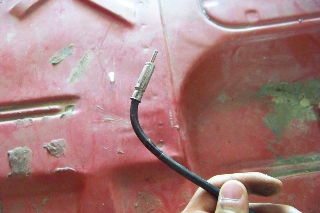

Changed out my old radio antenna because it looked like this:

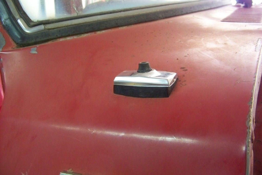

Hm... something seems to be missing...
Ahhhh. Much better.

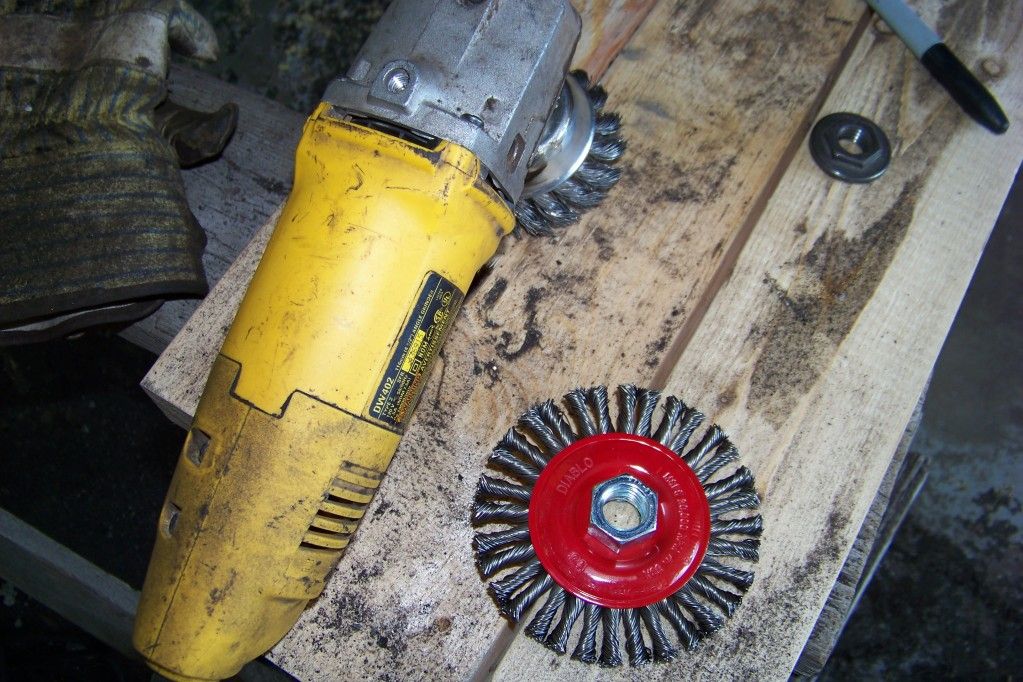

Also got more progress done on the underbelly of my truck, but you wouldn't be able to tell the difference between the last photos I posted up and today so we'll just leave that alone for now...
Here's what I picked up to help me get into those tight spots:
That wire wheel works VERY well. Cut right through paint like butter. Time to get out the dremel tool though because that wire wheel can't reach everywhere I want it to.

Be careful using a rotary wire wheel since pieces of wire can fly off embedding in your skin or an eye so be sure to use proper protective clothing and eye protection too.

And I'm all over safety like a fat kid on a cupcake. Lots of my friends say I'm paranoid about safety as well... but I'd rather throw out a pair of goggles/glasses than throw out an eyeball. One of the two isn't replaceable.
When I work on de-rusting my truck I wear:
Glasses/eye protection
Ear muffs for noise reduction
Full respirator
I always get funny looks from my dad when we work on things together... but then I got the last laugh when we poured his basement and he was coughing up and sneezing out concrete for the next two nights... Can't say I didn't warn him and give him my second respirator.

I also love what ya did to your fuel tank. I was going to scuff and paint my tanks silver on my "Project S" truck, but that is now getting changed to painting them with that gravel gaurd stuff. Thanks for the idea!
