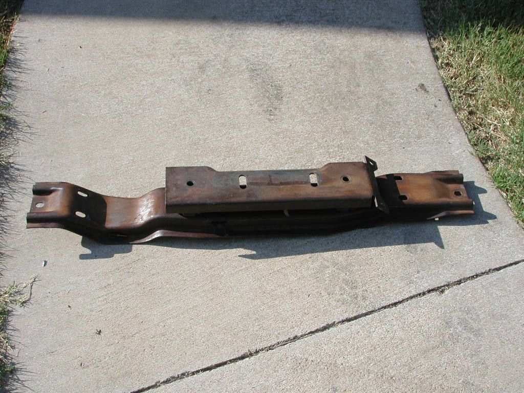

Here are pics of the crossmember I use. One of mine came under a C6 and the other came under an NP435, but they work perfectly under a ZF5 on a 35M/400 by moving them back ~3/4" and drilling new holes in the frame. But, that's not an exact dimension so check your setup as your small-block ZF may be different from my big-block tranny.
The holes in the top of the frame are a bear to drill. I pulled the cab mount bolts and raised the cab by ~4" to ensure I didn't hit the cab floor when I drilled through and so I could get the bolts in after drilling. Then I took a right-angle drill to the job and cut a bit off to shorten the length even more. As said, it isn't easy but it needs to be done as you need those top brackets.
Rear view:
Front view:
Here's the number on it: E0TA-7108-AD
And installed under a C6/NP208 combo on Rusty - the rebuilt 208 with no leaks:

Holy cow that looks weird. That's probably why you need the different top cover.
I'm hoping to just hammer mine up since I have a full interior rubber mat.
I've never seen one with that large hump.

Dylan - I need a translator when reading your stuff. And I'm not sure I'm alone on this. Could you please be more complete or thorough in your statements? You said "I'm going to call it the trans mount." But I have no idea what you meant. PLEASE spend more time in your typing. I just spent 30 minutes getting pictures for you as I had to find the extra crossmember, clean it, take the pics, put them in an album, and then post. Please spend some time crafting your responses so I don't have to keep asking what you meant.

In the last picture you can see it more then the others.
It's bolted between the trans and the cross member by two bolts which are about three inches from the "ears"
Mine doesn't have that bracket?
Mine goes from rubber mount on the trans to the cross member.
