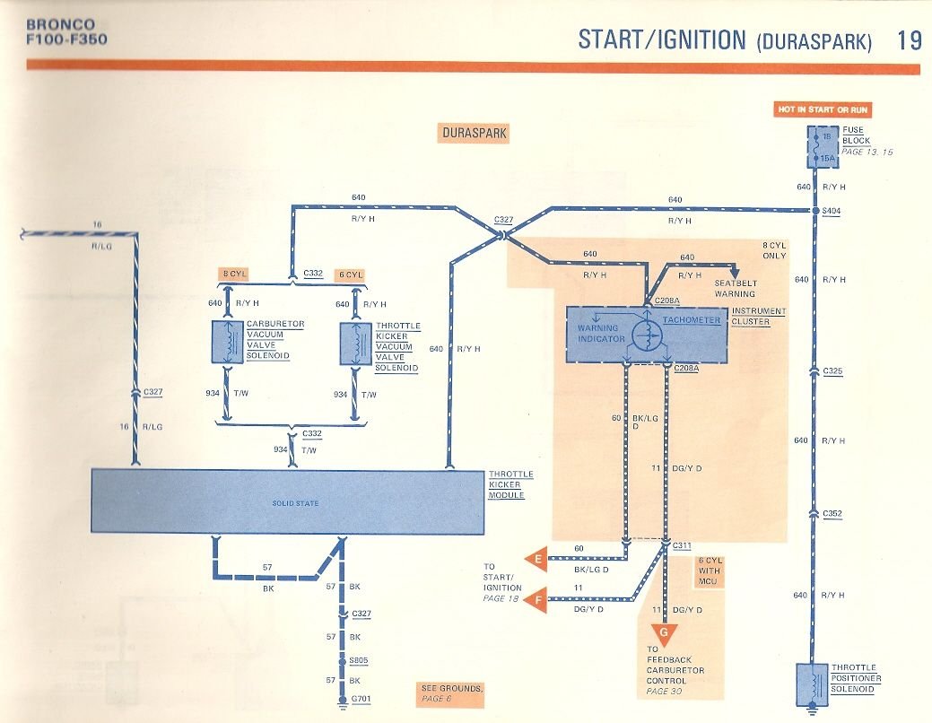

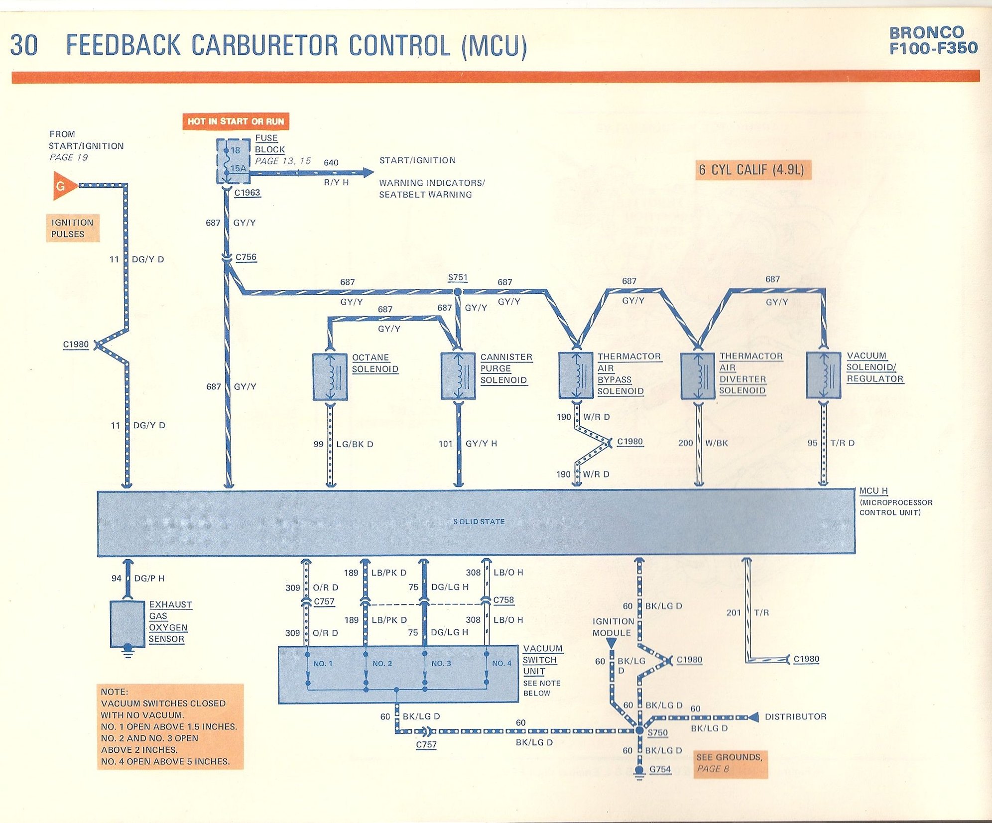

Posts: 1,294
What are the other two wires? Do I need them? They run to the computer. The others run back to the cab. My temp sensor was a cylindrical plug, not a cap I remember that.
The other question is, what do the other two wiring harness plugs do? I know they do something regarding getting rid of the feedback and going with a duraspark2 set up, but last I checked all those pictures were down.

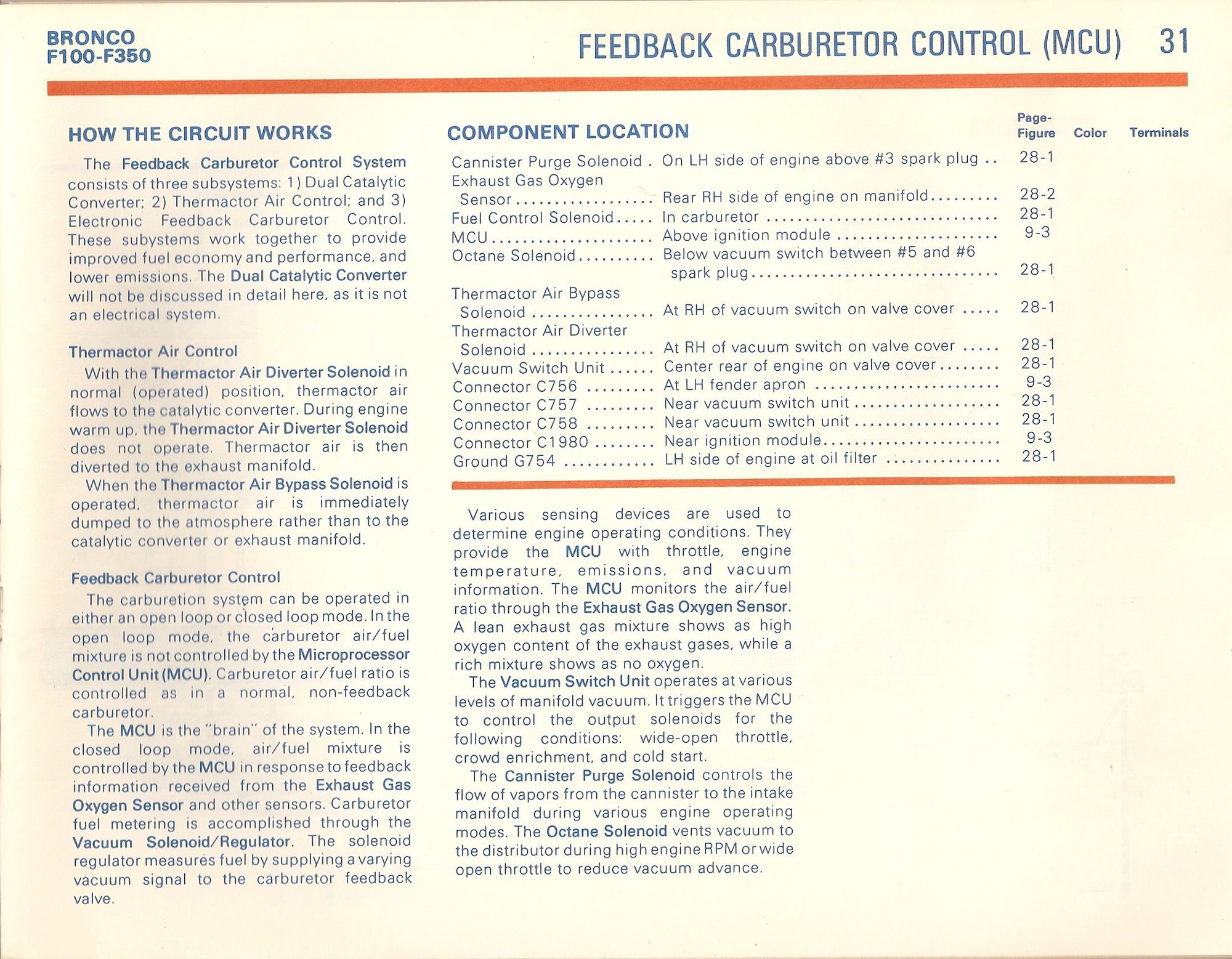

I hope these will let you answer your own questions. You should be able to figure it out from the color codes of the wires and what wires go in each connector.

Likes: 38
From: EXTREME southwest CT
Orange, purple, black is tor a DSII distributor.
Oil pressure and water temp are the only two sensors I can think of.

Well I couldn't figure out the yellow plug.
I used my buds84 and the one plug goes to the ignition coil(big plug on the fender)another to the ignition module on the dizzy and the other had the one plug(red) and then two wires I lost bcuz they were odd colors I couldn't find. But no yellow plug.
I really wish my manual came in
