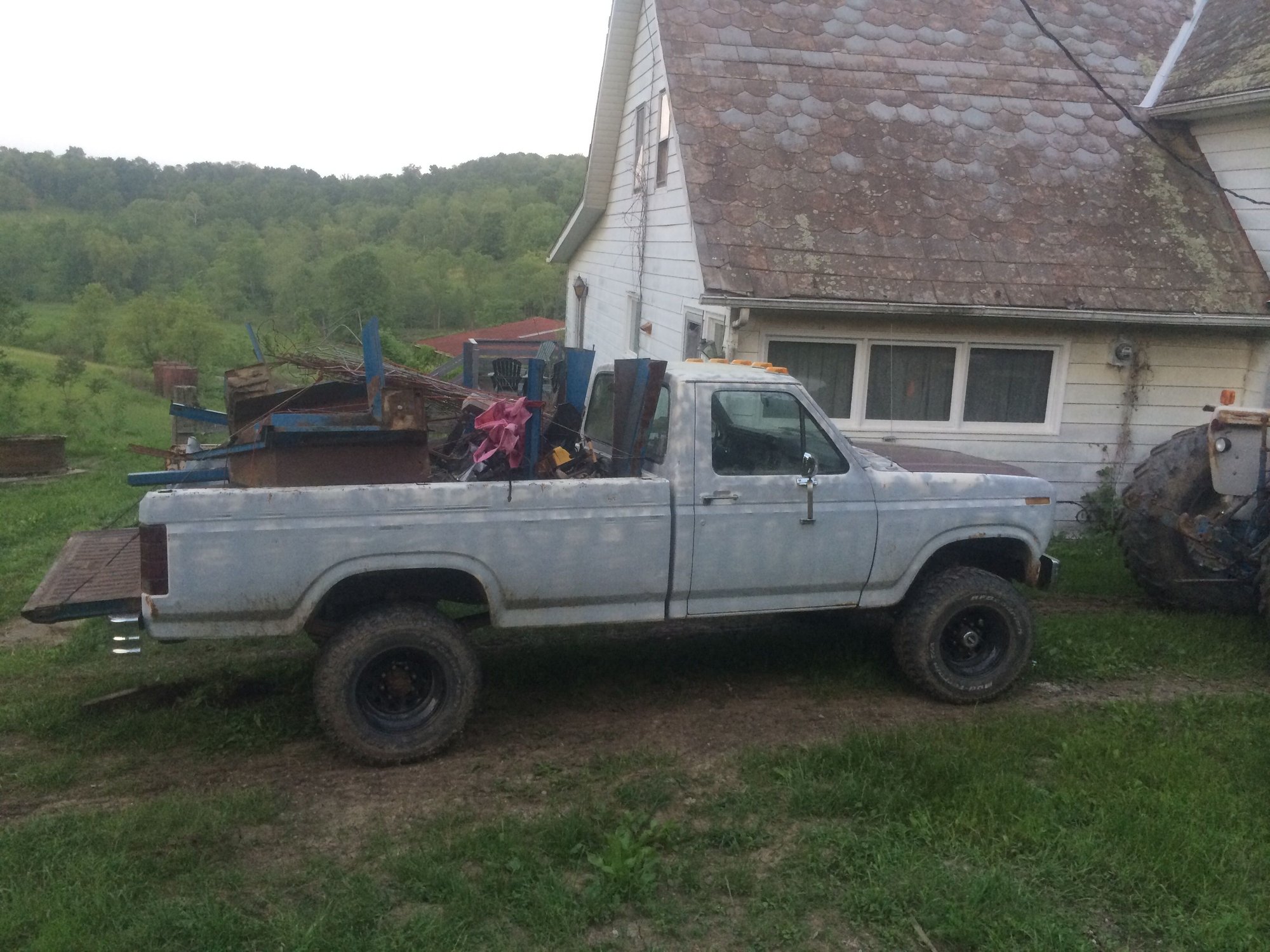

hauled 6200lbs of scrap on a trailer, thenbrought my beauty down the next day. ill tell you what. nothing beats walking out your door and seeing your truck in the driveway again.

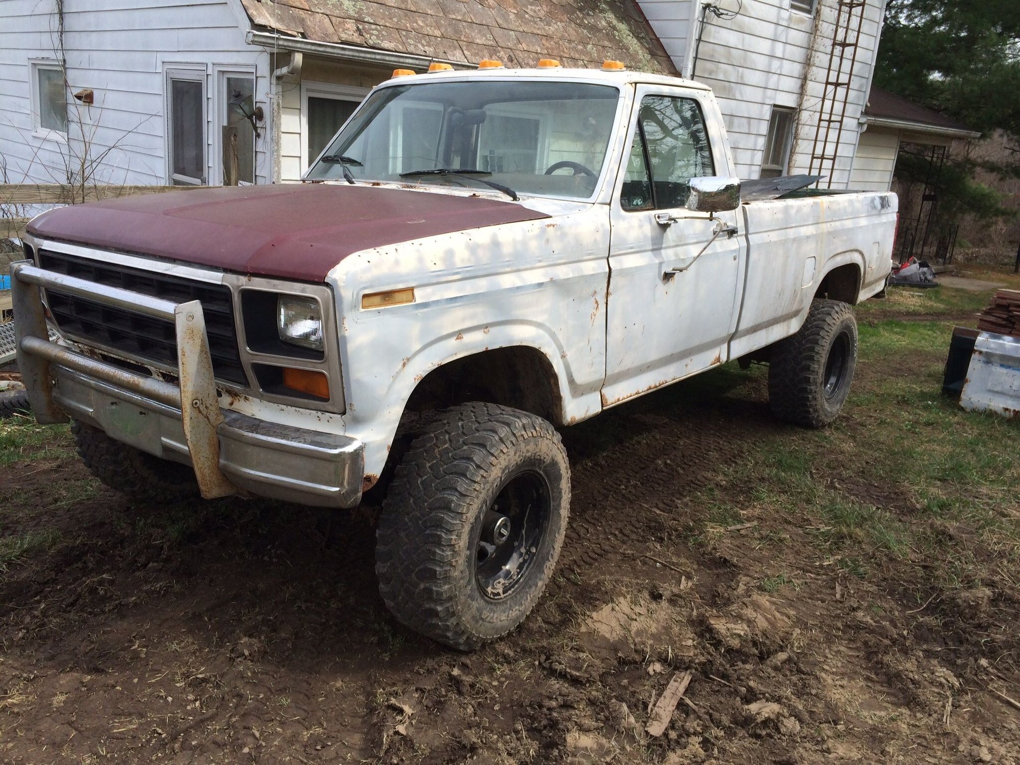

My 84 WIP before I sold it. Wish I'd have yanked the body for my 86...
Also note the sweet primer job the PO did for me lol
The bed sides had never been replaced, nor had the cab corners. It was beat up, though.
Here is my old 84 F250. It has a 300 (from 1983 F100; Clifford 6=8 intake, late model efi manifolds, walker y-pipe, autolite 2100, with plans to turbocharge), M50D-R2 (had a ZF, it was stolen), and a Dana 60 from an 89 F350 (converted to SRW) installed.
Truck was a beast, minus the M50...
