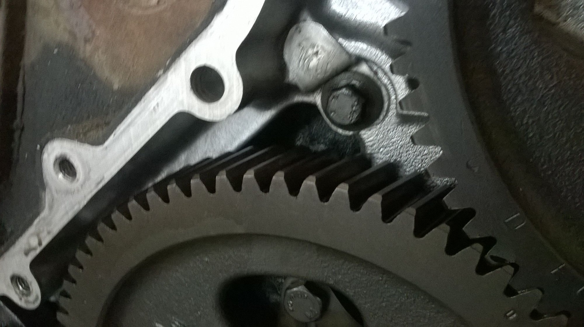

A bigger/better view of my "killer dowel pin" solution.

Since there should be no force causing the pin to come out, that tab should keep it from moving - ever.
That, and I also stake punched around the hole......
The only reason the pin has a tendancy to come out, is the vibration of the engine (even in the inline 6 variety), and nothing to prevent it from simply slipping forward. It isn't a press-fit in the block, and the aluminum housing is a slip-fit over the pin. It is used just to line up the housing to the block. The vacuum pump/power steering pump assembly and injection pump are the only items that are bolted to the housing itself, as the oil pump and camshaft retainer plate both bolt directly into the block.
If the housing had used a blind hole, rather than an open hole, it would have never been an issue........
Old Sep 6, 2014 | 11:36 AM
  #374
ArdWrknTrk's Avatar
ArdWrknTrk
pedant
Joined: Jan 2008
Posts: 23,576
Likes: 40
From: EXTREME southwest CT
I suppose using a threaded stud with a smooth shank would have cost a minute between tapping the hole and screwing it in on the assembly line...
Yeah, and who would have dreamed the pin could fall out.......
Anyone with a clue about how an engine *actually* works. Vibration and heat/cooling cycles can do many things, so it shouldn't be a surprise that this pin can work it's way out of the hole........
