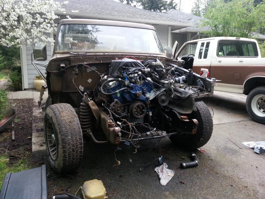

So I've only had one time to do a little bit of painting.
The primer went down well, did it in 2 coats. 2 coats of the high-build enamel went down beautifully. The semi gloss that I used looks almost identical to the stock paint. So far it seems tough, but I'll do a scratch test this weekend. And get some pics

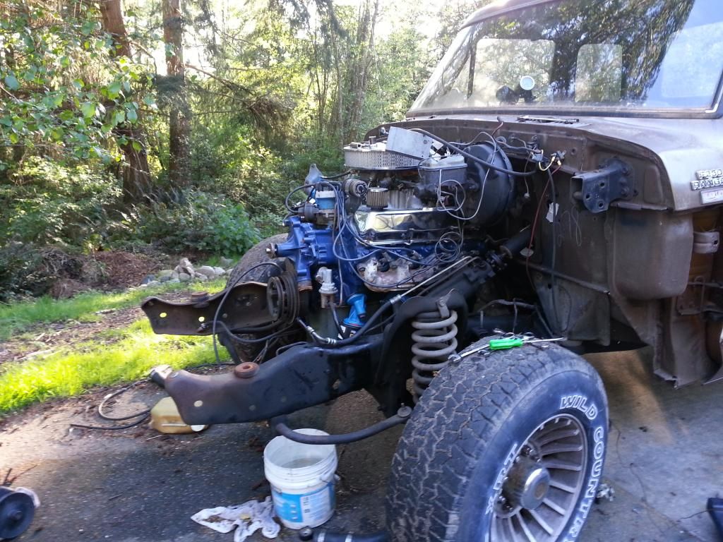

I almost have the engine ready for removal. Just have to pull the inner fenders and the core support.

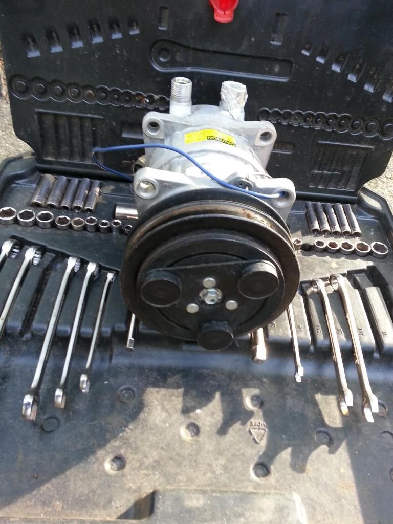

Anybody feel like playing a game of "Guess the manufacturer"? I'm not sure who makes the A/C system in my truck, but it's really nice. There are no brand markings on the compressor or any of the other components..
-Jameson

Looks like a sanderson compressor -very good units compared to the factory lugs ford used ...
Great work ....

Engine is almost ready to come out. Just have to drain the oil and pull the carb and it's ready to come out.
I'm a little disappointing, the Edelbrock chrome valve covers and cleaner have rusted.. Well I guess I get what I pay for Maybe now I'll get the ford racing covers that I want..

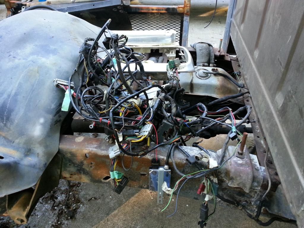

And here's the mess of wires that I pulled out.. Includes the cab stuff too
trap4x4: You are the winner! It does appear to be a sanderson compressor... The whole setup is great. I love it.
Thanks for the help

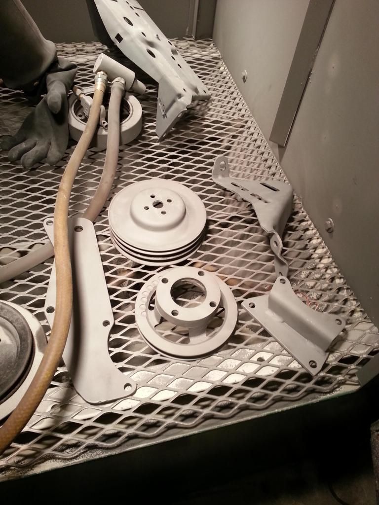

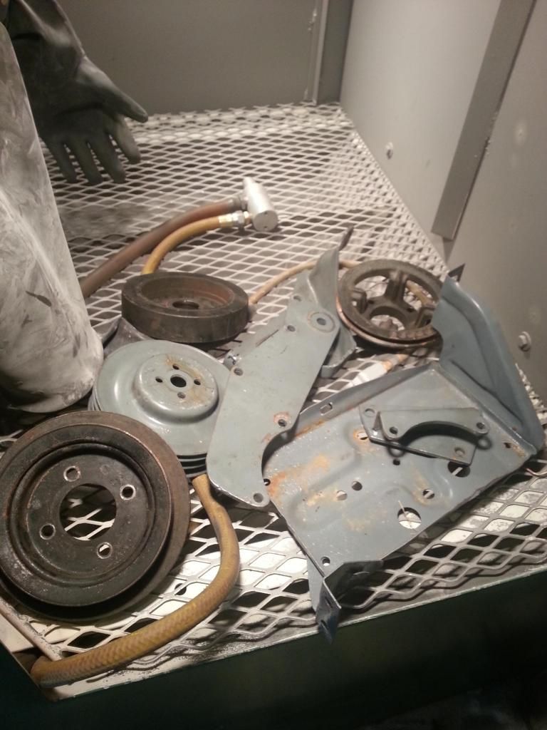

Life is keeping me busy, but I had some time to throw some parts in the sandblaster.
-Jameson
