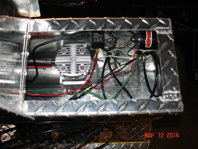

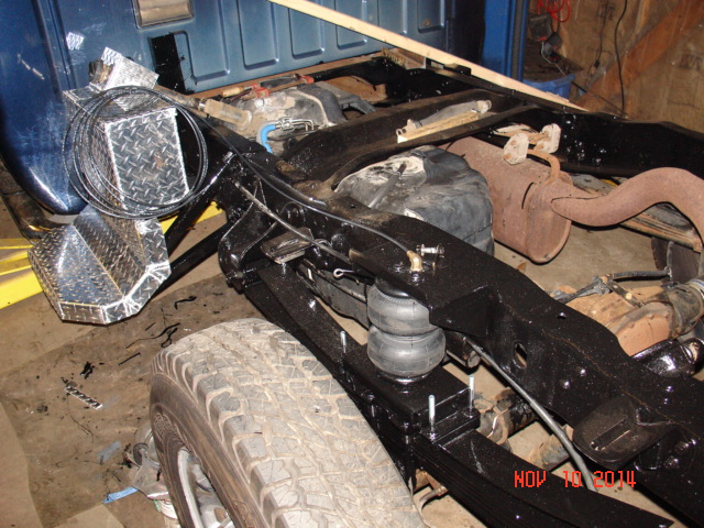

Originally Posted by A Rodder
It won't send air to the other bag if each of the lines are ran to individual fill valves.
Generally I only will install them this way.
That is true and is also dependent of the system used. On our work truck we have an on board pump which yes I will admit with a second solenoid could separate the sides. However we have found that the stock push lock fittings suck and leak all the time. So the system needs more air every few hours (glad we have the pump on board). If the sides were separated this would cause a problem with one side leaking down faster than the other. Even more of a problem if you don't have an on board pump and need to fill with a compressor. At least with both sides connected if one side is leaking down both sides will always be equal.

Good point on them being leakers. But having separate let's you know which side is leaking and you can fix it.
But if a guy is going to pony up for a compressor, he should get the gauge kit with two needles/valves and they can be monitored / filled / dumped on the fly.

The kit we got did come with the gauge and twin needles. That is how we know it leaks down on the road.
I did find it interesting though when I tested the two inputs on the gauge with the compressor in the shop one side would show 125psi (max output of compressor) and the other showed 110 with the same input.
