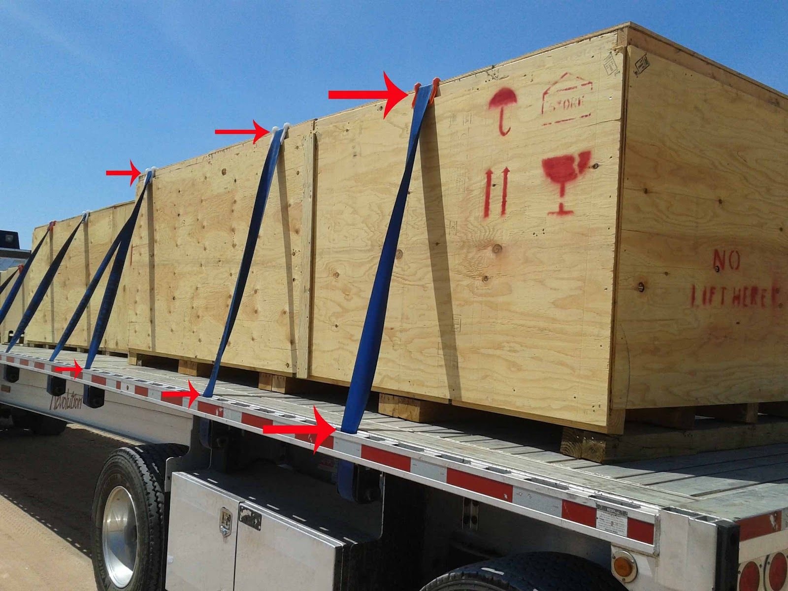

If you use ratchet straps, twist them so they don't have a flat surface area.
Beat me to it. ^^^This.
Put a couple twists in the straps and it won't vibrate like a reed in the wind.
Look at the big rigs and flatbeds hauling large loads. You'll almost always see a twist in their strap, like this.
