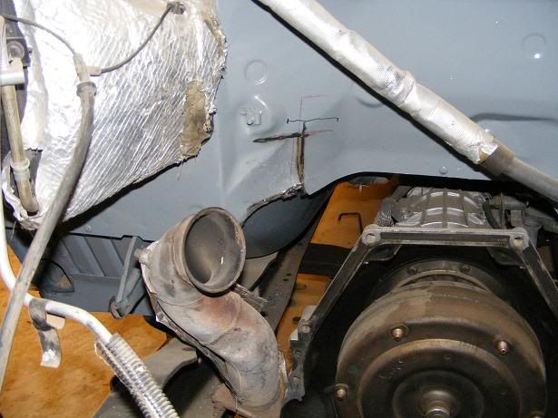

Talking Firewall moddification..
As I had said I would, here is the work I have done so far with the firewall moddification. I made several measurements prior to cutting and bending, I dont think I have much further to go with it. It did sink back by just over an inch, and is not noticable in the cab..
Of course it will be cleaned up a lot more prior to the engine install! I hope to have it looking like it came from the factory like this!

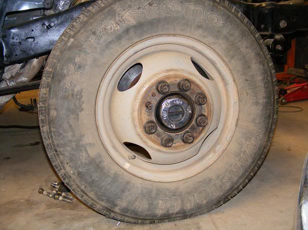

I also got the bearings packed and seals installed.. finally this chapter is closed!
This has been the sight I have been waiting for!
(No worries, new rims after its all done! LOL)
