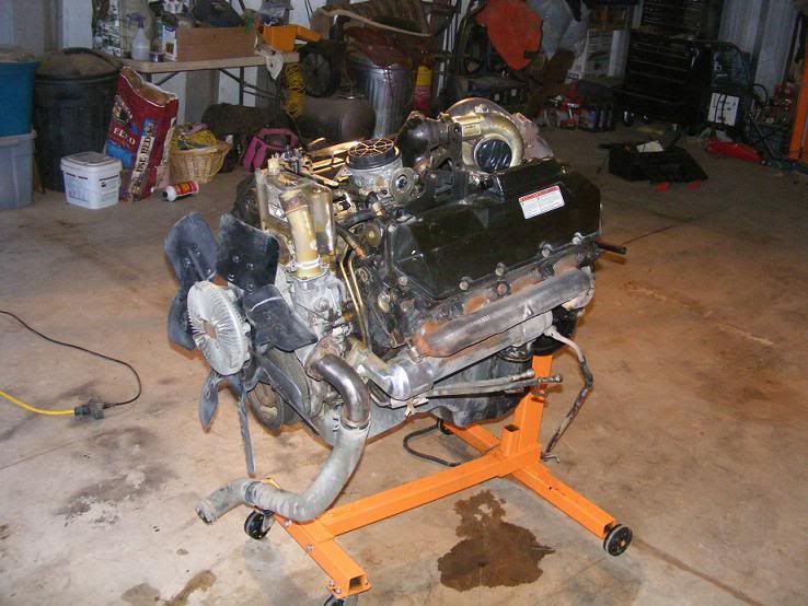

Another step in the mess! LOL! I finally dug out the degreaser and brushes..
I would say I got pretty much most of the grease off of it, now prepping it for the master O-ring kits, GP harness/gaskets and new GP's. I will also go through and test each sensor and some minor moddifying for performance and reliability demands.
Clem, I dont know about each of the years, but the 97 has an individual pump right above the power steering pump, that runs off the belt, and powers the demands for the vaccume. There's actual vaccume distrobution block that bolts to the inner fender on the drivers side, for the brake booster and everything else that requires vaccume.

An aluminum intercooler from a 99 up model super duty will fit in front of your radiator, and can be had (used) for around $100. yes you will have to get an intake spider and IC tubes from an early 99 model , but alot of guys swap over to the late 99 style, and the parts are usually inexpensive. the IC will give you cooler charge air, and thus make you more HP. Post up a request in the 99-03 7.3 forum and ask if any body has leftover parts from their up grades, and you might be pleasantly suprised.

You know, I have been giving that some serious thought for a bit now. I know these engines can run warmer, but I also know you get a heavier air charge so HP gains would be there! How much improvement would a person guess for by adding the intercoorer?
I would actually like to find a detailed pic line up of someones set-up, to give me an idea where I need to start at!
LOL, Yeah, that engine stand has me wondering some days! It's brand new out of the box, rated for 1000lbs, and the engine maxes at 944lbs.. I guess I push it! LOL!

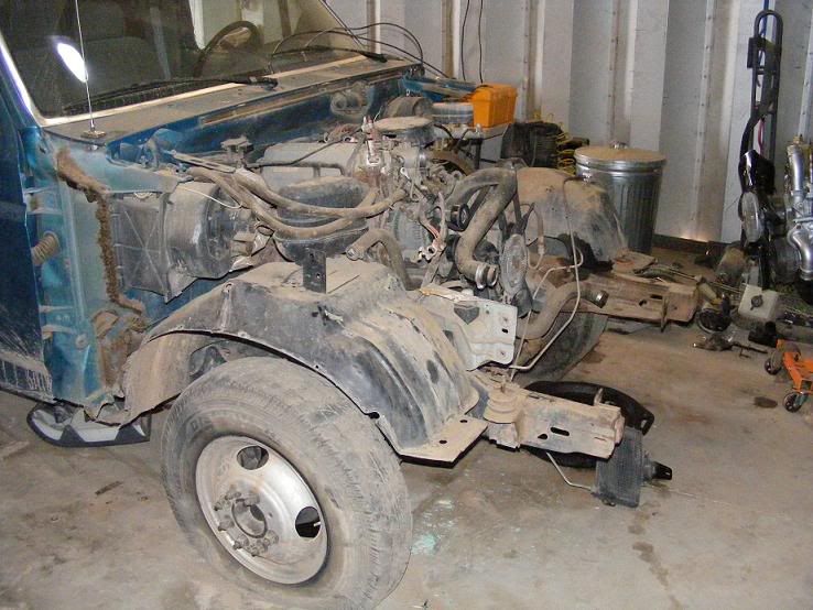

Finally got the project truck into the shop! I had been putting it off as long as I could, but its now that time.. Out goes the old engine and trans..
Again, everything was coming off pretty slick without much in the way off issues. This was all done today in just a few hours. I noticed there is a whole lot less going on under the hood of a gaser then the powerstroke, lol! Of course this is a very base model truck!
One thing I noticed now that I took the front clip off, is that a person does need the radiator support from a diesel for this swap. The radiator opening is much larger then that of a gas model. I will have some pics up in just a short of that! But everything lines up between the two supports. I am lucky the the damage from the F-250 didnt involve the front of the truck, so I have that part already!
I got most of the O-rings replaced that came in the master kit. It was a little here and there. I also ordered a Cold Air tube and filter online, so I all I have left is the breather filter. I have replaced quite a few sensors, and have some left to finish replacing. The harness were hung, steamed and dialectric grease used. I have to make a run to the parts store and get new hoses. I noticed the lower hose had a tear in it that later on could cause me problems, so going ahead and getting it taken care of now! I also have to pick up some silicon tubing for the vaccume lines. Some final steps on the powerstroke, and it will be ready to go in!
Once I take the engine out, the front suspension of the truck is coming off for the 4-wheel drive addition! I will also have to finish the A/C transplant and power windows and door locks!

Got back at it pretty heavy today! I have been picking at it here and there, especially with everything else going on! The old engine and trans is out and gone, thankfully! After getting all that out of the way, I started cleaning and stripping the frame. Tons of icky stuff left on the cross member from the last engine. I did discover some things once I had everything disassembled:
- The radiator support on my truck needs to be swapped out with the one from the donor truck. The lower part of the radiator support is a lot lower on a diesel then on a gas, due to the radiator being much larger! Fortunately, I have both, so I stripped and cleaned the donor one up to go on mine..
- The engine mounts! Oh boy! Engine is out, no problem.. Motor mounts on the other hand, were a challenge. The 5.8 motor mounts were put on by the factory, in a bizzare way. The passenger side mount has 4 bolts, no problem.. However, the drivers side is held on by 3 bolts, and 4 pressed slugs. So I have had to resort to grinding the heads of the slugs off one side, and hammering the mount off. What has been the nice side to it, once I got the mounts off, the diesel mounts rest nicely on the frame, and there are factory bolt holes that match up to the mounts. The diesel engine sits more forward then the smaller gasser.

The drivers side engine mount.. There are three pressed slugs that have to have the heads ground off to get it off, along with the three mount bolts..
Here are the two radiator supports.. there is quite a difference.. The green was off of the gas engine, the white off of the diesel..
And the engine bay is coming along.. getting alot of the old grease and nasty off..
