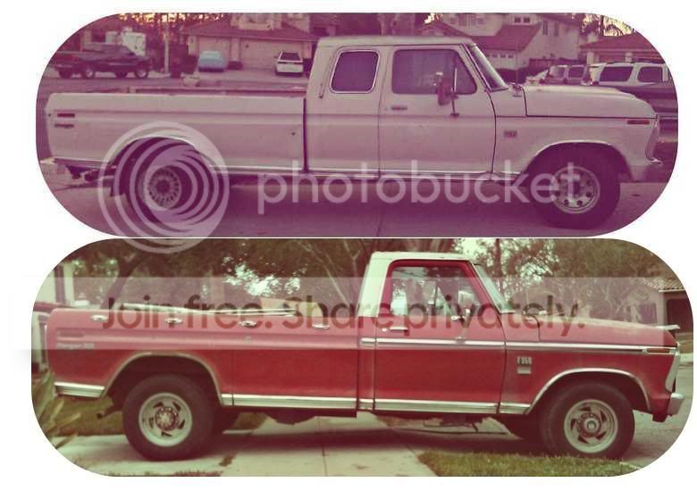

I love reading his posts like a living FTE legend, right Bill. You were building Ford trucks when most of us were still a twinkle in our folks eye's.
Bill never worked on an assembly line. He was a Ford Parts manager, working in several different dealerships throughout the mid '60s/'70s/80s and into the mid '90s,
if I remember correctly...
I gotta get off this darn computer and go to bed, I haven't slept in 2 days!
It's gonna be the death of me...
Nice SCS, however, that is defiantly a mid west truck, but it's still better than some stuff on this site.
Welcome to the site, I love Super Camper Specials, they aren't to common.
Here's mine:
My SCS was also a cheapie, however, mine is built FE with a 4-speed.
(Note: I have the correct mirrors, I just haven't put them on, a previous owner put the in correct mirrors on this truck)

Nice Trucks 76F350SCS. Do you guys know what the difference was between the Ranger XLT packages and the other ... non ranger SCS?
