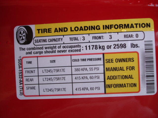

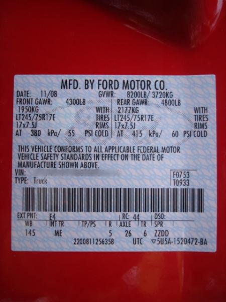

As requested the labels on my truck. Chris

Likes: 42
From: SW Virginia
Wow...that's a huge difference compared to others.

You are....
...the undisputed winner of the "macho F150" award.
I'll note that this is with E-rated tires, 55/60 lbs of pressure; those are definitely some real truck tires--not the little 20" rubber bands from "Pimp my Ride"....

Originally Posted by fonefiddy
Chris seems to have the heaviest load carrying capacity rig here,so far.
Chris, do You have the 10-1/4" rear end? With 7 lug steel wheels?
If so, Post up what the "Tire and Loading Information" sticker says. Maybe get a pix of it?
I looked it up and I have 9.75 gear set/.373 with the 17" steel rims. Chris
Attachment 13590
Attachment 13591
So in theory, this truck should weigh 8200 - 2598 = 5602 lbs? That seems kind of heavy for a single cab 4x4. It must be the 4x2 models with the 8200 gvwr package that get the 3000 lb payload? This has turned out to be a very interesting and informative thread.
Attachment 13590
Attachment 13591
I'm going to say that Ford must have a mathmatical formula to figure GVWR. 2598 lbs though impressive is a rediculous number. Why not 2600 lbs? Is (2) two pounds going to break the camel's back? Will the rear leaf springs bend? Will the tires pop? No, of course not. This has to be legal speak from Ford's attourneys.
Chris's beast has a payload rating of 1100 lbs more than my '88. That is a helluva truck sir!

Yeah, 2600 lbs is very impressive. But so is the 5600lbs curb weight.
Damn, these trucks are HEAVY!
