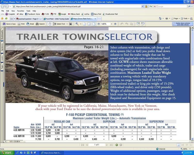

someone please correct me if I'm wrong, but I don't understand what y'all are so worked up about
https://www.fleet.ford.com/showroom/...06_default.asp
Fords Towing Guide...lets you select your Year of F-150 and provides all the relevant towing/loading info for that year
so, per the definition of GCWR
GCWR column shows maximum allowable
combined weight of vehicle, trailer and cargo
(including passengers) for each engine/axle ratio
combination.
My truck is a Supercrew, 4x4, 5.4 engine, 3.73 gears, 18" rims, 138.5" wheelbase...which allows me 15,000 lbs GCWR, and a max trailer capacity of 8,700 lbs (9,200 - the 500 lbs since I have 18" rims)
Truck weight: 6,000 lbs (rough numbers)
AVG Trailer Weight + Load: 7,000 lbs (car trailer + 4 door car)
5 people @ 200 lbs each: 1,000 lbs
__________________________
= 14,000 lbs of loading using rough #'s
which would still give another 1,000 lbs of cargo capacity in the bed
maybe I'm reading this wrongly, but it seems I still have quite a bit of GCWR capacity left...and that is for my 2006 model. The 09's have a bit more

OK this is all from 09 ford towing guide:
Payload is the combined maximum allowable weight of cargo and passengers that the truck is designed to carry. It is the Gross Vehicle Weight Rating minus the Base Curb Weight.
The 900lbs must be a mistake as having 20" wheels won't impact this calculation. 7,200 gvwr - 1,500lbs payload = curb weight of @ 5,700 lbs which as I recall is correct as per definition
Base Curb Weight is the weight of the vehicle including a full tank of
fuel and all standard equipment. It does not include passengers, cargo or
any optional equipment.
Cargo Weight includes all weight added to the Base Curb Weight, including cargo and optional equipment (check with your sales consultant). When towing, trailer tongue load or king pin weight is also part of the Cargo Weight.
Gross Vehicle Weight (GVW) is the Base Curb Weight plus actual
Cargo Weight plus passengers. It is important to remember that GVW
is not a limit or specification – it is the actual weight that is obtained
when the fully loaded vehicle is driven onto a scale.
Gross Vehicle Weight Rating (GVWR) is the maximum allowable
weight of the fully loaded vehicle (including passengers and cargo).
This number – along with other weight limits, as well as tire, rim
size and inflation pressure data – is shown on the vehicle’s Safety
Compliance Certification Label, located on the left front door lock facing
or the door latch post pillar (see facing page). The GVW must never
exceed the GVWR.
Gross Axle Weight (GAW) is the total weight placed on each axle
(front and rear). To determine the Gross Axle Weights for your vehicle
and trailer combination, take your loaded vehicle and trailer to a scale.
With the trailer attached, place the front wheels of the vehicle on the
scale to get the front GAW. For rear GAW, weigh the towing vehicle
with trailer attached, but with just the four wheels of the vehicle on the
scale. Subtracting front GAW from that amount gives you rear GAW.
Gross Axle Weight Rating (GAWR) is the maximum weight to be
carried by a single axle (front or rear). These numbers also are shown
on the Safety Compliance Certification Label. The total load on each
axle must never exceed its GAWR.
Here is the kicker @ max trailer weight rating:
Maximum Loaded Trailer Weight (as shown in the Trailer Towing
Selector charts pages 17-25) is the highest possible weight of a fully
loaded trailer the vehicle can tow, based on a minimum-towing vehicle
GVW
. It assumes a towing vehicle with any mandatory options, no cargo, tongue load of 10-15% (conventional trailer) or king pin weight of
15-25% (fifth-wheel trailer), and driver only (150 lbs.).

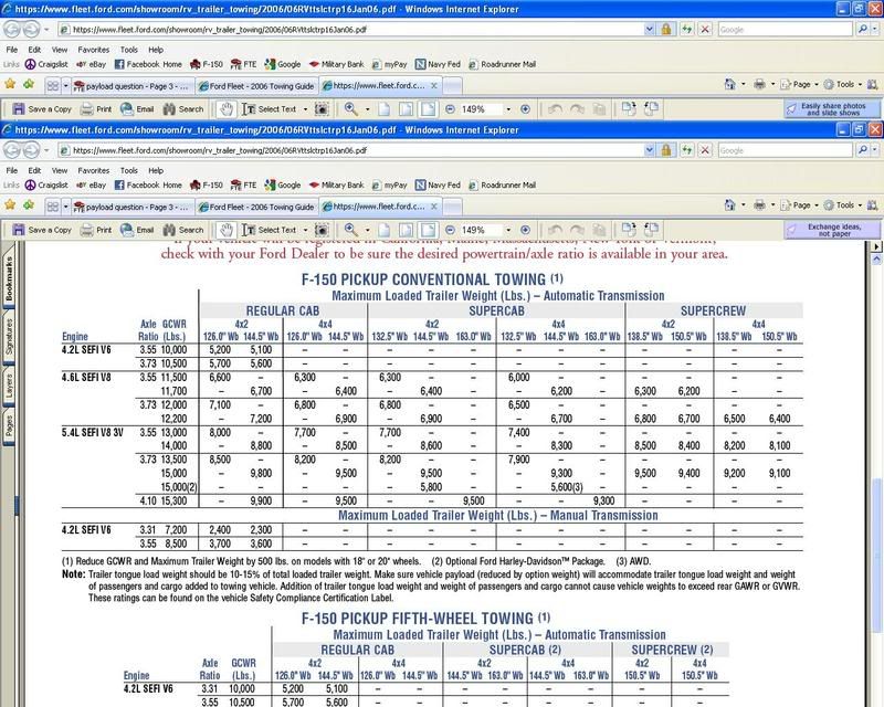

Didja happen to read the small print on the second page of the Trailer Towing Selector
Note 1: Reduce GCWR and maximum trailer weight by 500 lbs on models with 18" and 20" wheels.
Also says NOT to excede GAWR when combining payload and trailer tongue weight
Old Feb 27, 2009 | 08:26 AM
  #104
dbossman's Avatar
dbossman
Joined: Aug 2003
Posts: 286
Likes: 32
Well... yes. The subject of this thread is "payload". The text does not state to decrease "payload" by 500 lbs.
