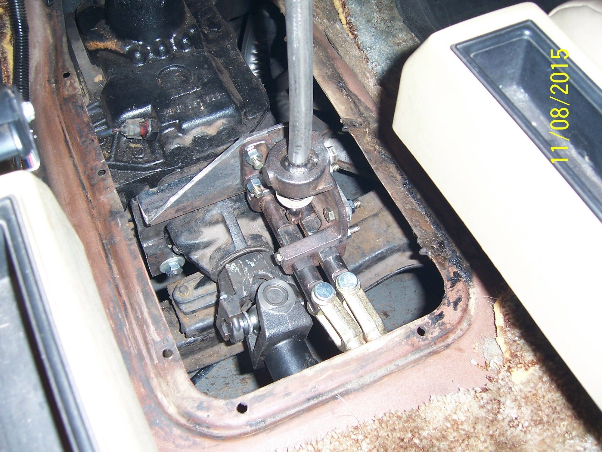

Shifter Mounted
Hello again,I finally have the shifter mounted,and yes that is a spicer shifter.I was going to use a Hurst,didn't work out.I found the shifter on ebay,rebuilt it and here it is.
I took out the bolts from the tailhousing of the t18 and replaced with 1/2 double ended studs then used nuts to secure the tailhousing.The bracket I then built is attached to the studs with another set of nuts.I started with a 1/4 inch plate using 3 studs and with making pattern the plate fits around the tailhousing.Then placed the shifter and built the mount to it.I just keep throwing steel at it until the shifter didn't move,now if you grab the stick and pull on it,it moves the whole drive train.

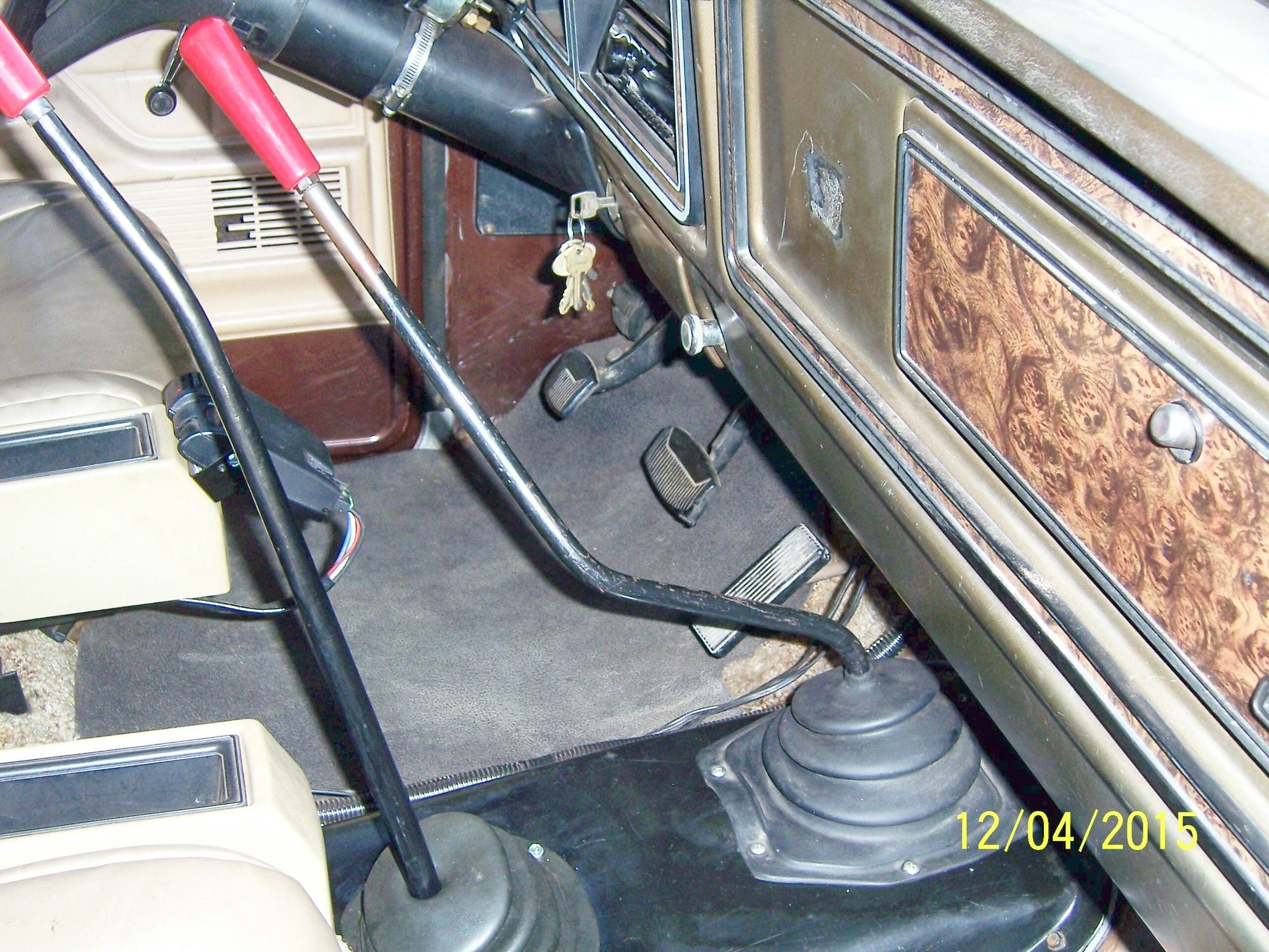

Finished
Hello,It is now on the road and working,I have to replace the input and output seals,they both now leak a bit.(should have done that before ,but I needed it out of my shop).Shifts nice,can't really float the stick to shift the aux,not enough rotating mass with the 460 flywheel the rpms drop very quick.So when you shift you must be smooth and quick.I also have to get a reduction for the speedo cable,but I am very happy with it.Now is a comfortable 70 mph truck.Most of the coal burners around here still don't get it.First Questions are how is it on gas/why not put a 12v cummins ect......I say"don't matter what the mileage is,it's paid for and I hate small diesels".
They always have the same look of anger and confusion.
Chris

Nice installation.
I have a question about shifting the aux box, does the auxiliary sifter take more strength to shift than the main transmission?
Since my truck is a single cab and my transmission is a three speed, I'm thinking about using a column shift setup for the auxiliary. Floor space is at a premium in my old F-2.

Shifting
Hello,thank you for the compliment.I always strive to make all of my installs as clean and nice as it would be if the factory had done it.As for shifting the the spicer it takes more effort to get the main(t18)trans out of 1st gear than shifting the spicer.It has a shorter throw than the t18 and,I did do a lot of welding,grinding,reshaping to get the aux shifter parts all back into into spec.
It actually takes a very minimal effort.
What main are you using and what size aux?I personally would not recommend a column shift for a great many number of reasons the least of witch would be overly complicated linkage.
Chris
