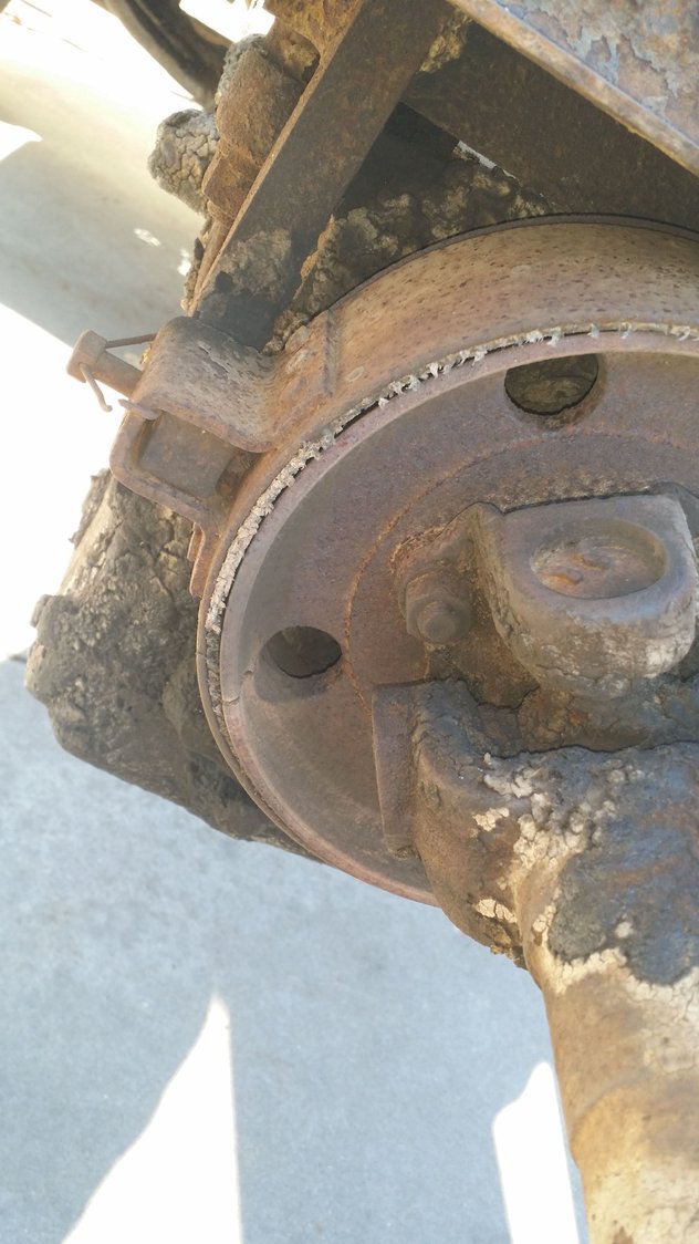

I noticed today that the hub for my e-brake on my brownie gear box is cracked. Is there anyway to replace it? Also the e-brake pad is gone is that replaceable? thank you

The brake band can be re-lined. There probably is a brake shop in your area that can remove the old lining and install new.
Edit: Can you post a close up of the split area on the brake drum? That looks really clean to be a crack. It may be either from manufacturing when new or an old repair.

That may be the same brake drum as the 4 speed in your originally had. I have several for the 4 speed. If you pull that one off the transmission, we can compare measurements to see if they are the same.

What measurements do i need to take over size and width? If i knew where to get the lining i can reline it myself

I believe you can get the lining from McMaster-Carr. Measure the diameter, width and the depth from the back to the transmission mounting surface. I can compare that with a 4-speed drum.
