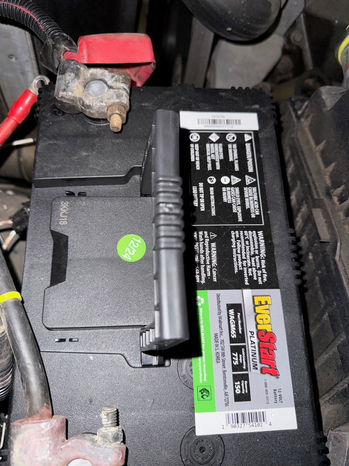

Installed the new batteries today, reset the BMS, and changes the battery type to AGM. I didn’t make any other changes to the charging profile like SOC and the like because I really have no factual basis to change them from the AGM profile defaults.
I am so glad that I made the swap. The driver side battery was gassing so bad that there was battery acid residue in the battery tray. I will CLP flush it out good in the spring, when it isn’t 25 degrees out, and repaint the hold downs as well as the drive side hold down is a mess from the battery gassing.
Anecdotally I will say the truck turns over much faster and the headlights are noticeably brighter to my eye.

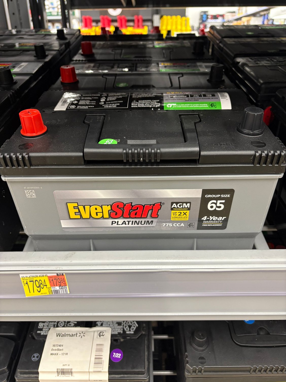

My Walmart, 775 CCA. Just check the dates, look how old the one is below it!
