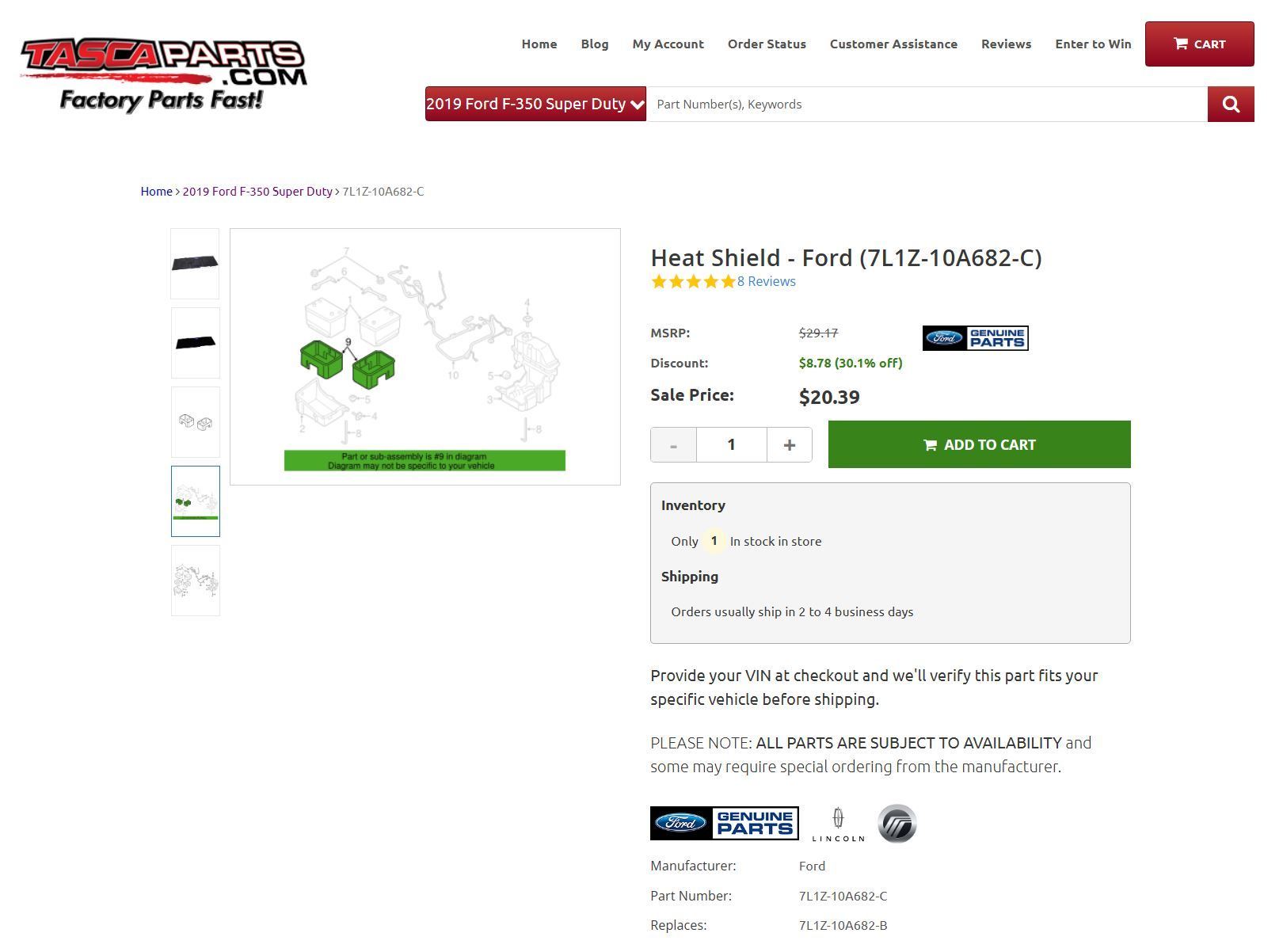

My 460 came with a 195° thermostat from the factory. I have about the same amount of room in the engine bay of my 2022 as my 1995. The 7.3 powerstroke has about the same amount of room in the engine bay as a modern diesel.
That little piece of felt has an R-value of about 1. If you are shielding something from heat you don't use a piece of felt you use a piece of reflective material like aluminum or sheet metal and then have a stabd-off distance. If you wrapped your starter with that to protect it from headers it would melt.
OK, you're right. Ford just makes battery heat shields because Bill Ford's grandma needs something to knit to stay busy.
FWIW - the battery heat shields in my truck are puffy and are not made of felt or whatever you are describing.

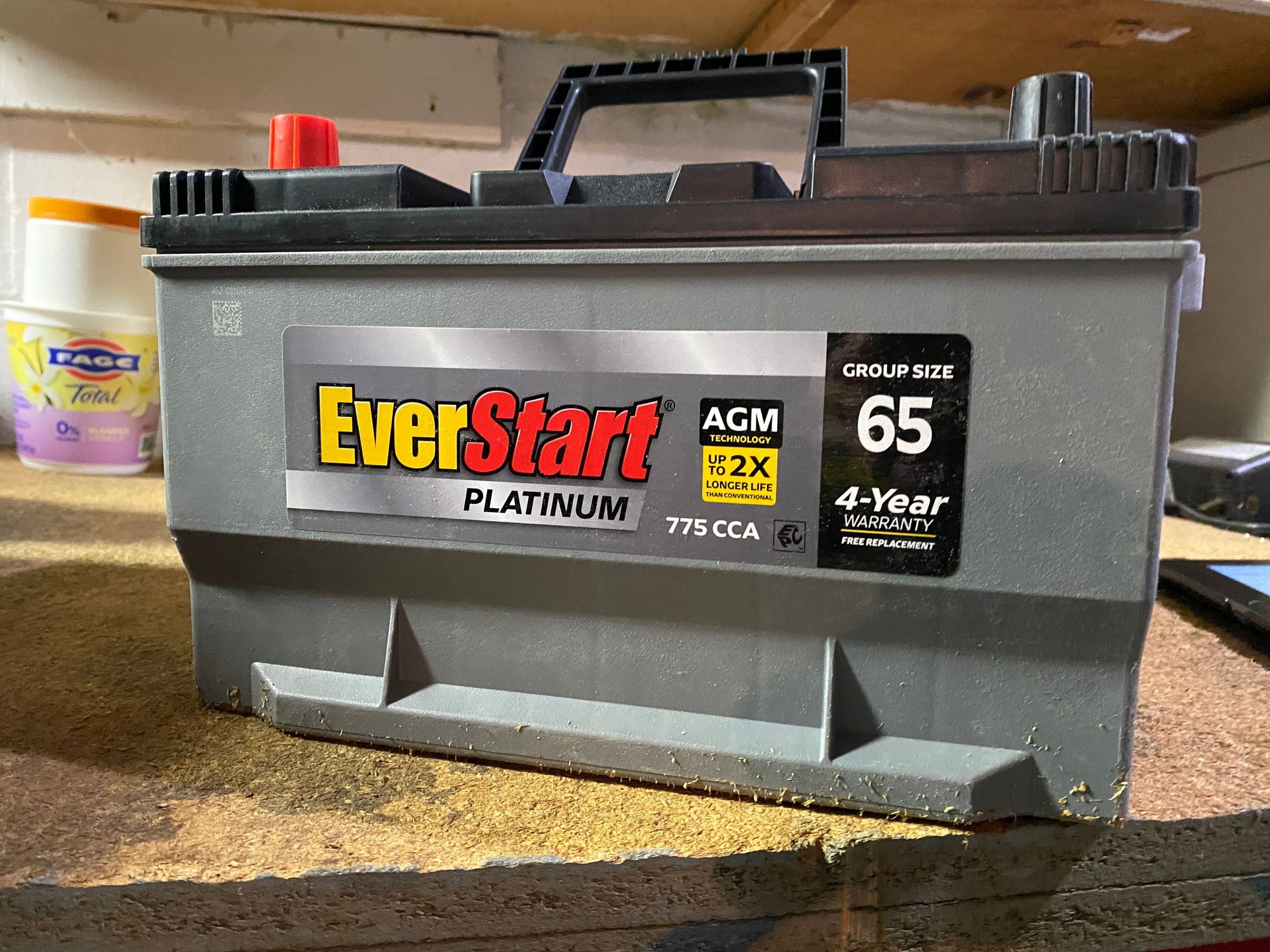

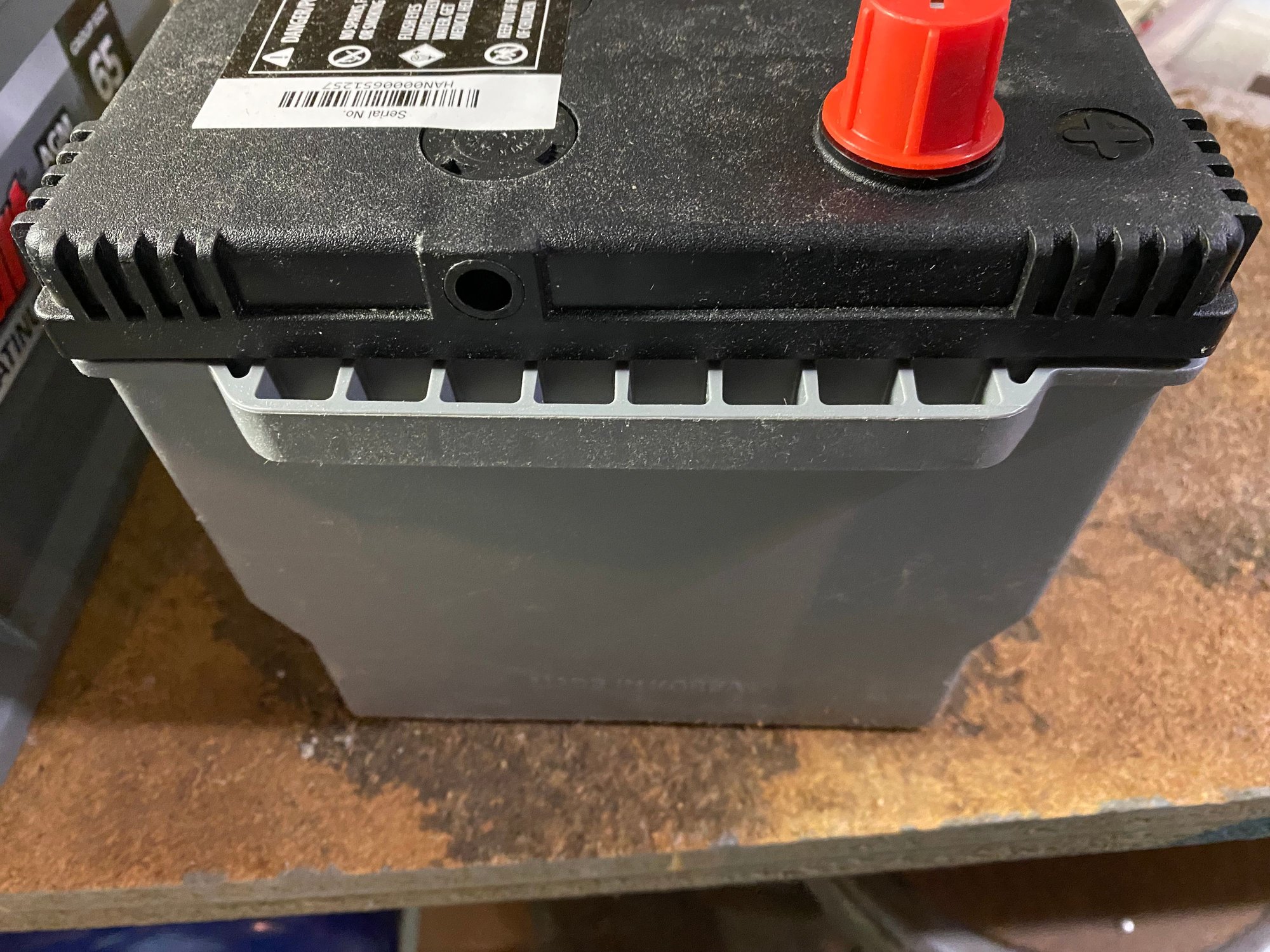

Originally Posted by HorizontalHunter
@Y2KW57
Absolutely, happy to. Let me know if you want more. I included an end shot as the carry handle is different and the base is tapered instead of horizontal.
Bob
Happy to say I just pulled the trigger on a Group 65 Platinum at Walmart, and this is the one (775 CCA) they installed. The funny thing is, they told me they had two in stock (Bowling Green, KY) that were advertised as the 750 CCA. The one in my truck is the 775, and the one left on their shelf is the 750 CCA. I'm not complaining, just kind of weird.

Does anyone happen to know what the amp hour rating is for the 775 CCA version of the Walmart Everstart Platinum AGM? Pictures shown above for the 750 CCA version say 68 amp hours, but I can't find that number anywhere on the 775. I'm asking because I just got one of those Ancel BA101 battery testers, and they want you to input the amp hour rating.
Shouldn’t you be inputing the CCA for a starting battery? Cycle thru the settings until you get to CCA.
